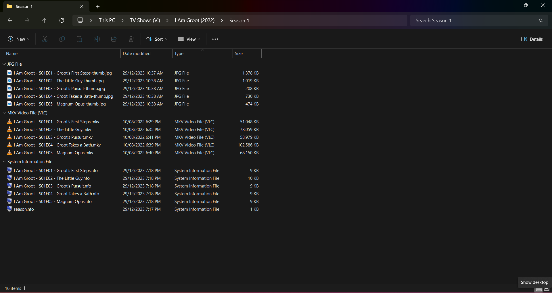

roxy693 1 Posted December 30, 2023 Author Posted December 30, 2023 Thanks for replying. I have attached screenshots of the ones I have found if that helps. For some reason some work but others wont and I'm not sure why.
