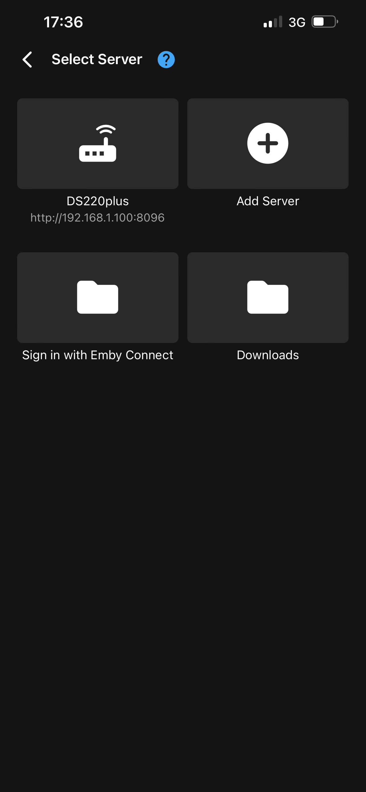

Roy sloane 6 Posted December 24, 2023 Author Posted December 24, 2023 Hi it sits with the attached screen for an age then it will get in then a few seconds later it goes back to the screen attached with no access to files

Roy sloane 6 Posted December 29, 2023 Author Posted December 29, 2023 It goes to this screen and I try to log in and it wont let me it just goes back to the attached screen
