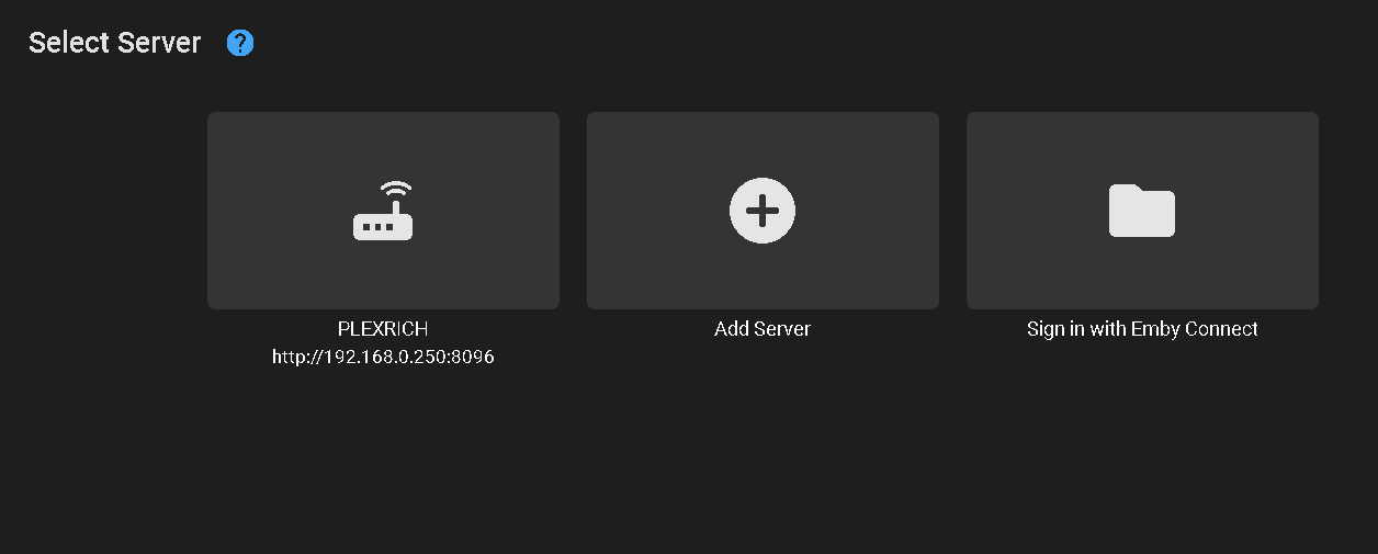

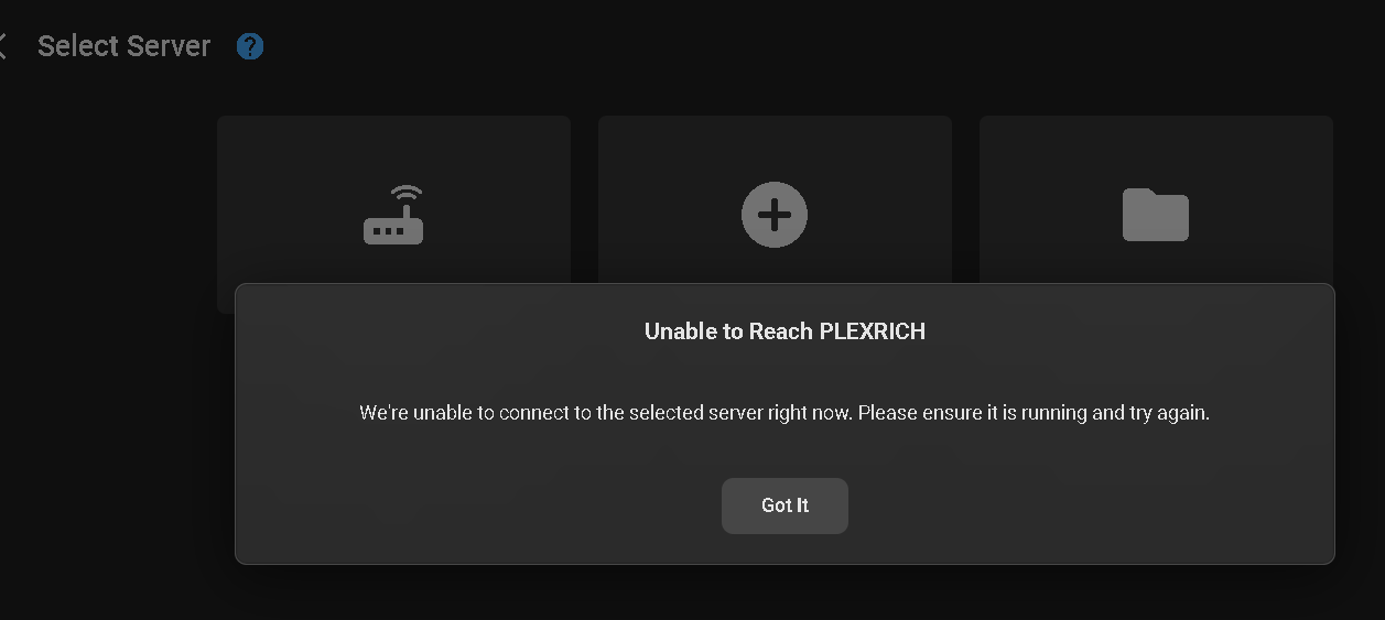

richenginner 2 Posted December 29, 2023 Author Posted December 29, 2023 11 hours ago, Luke said: HI, does your ISP allow use of this port? Is your ISP using a CGNat? i have a public static IP, my ip allowed to use the port they make it. i sent a picture of server from another pc in network and remote and this error to loggin please help me
