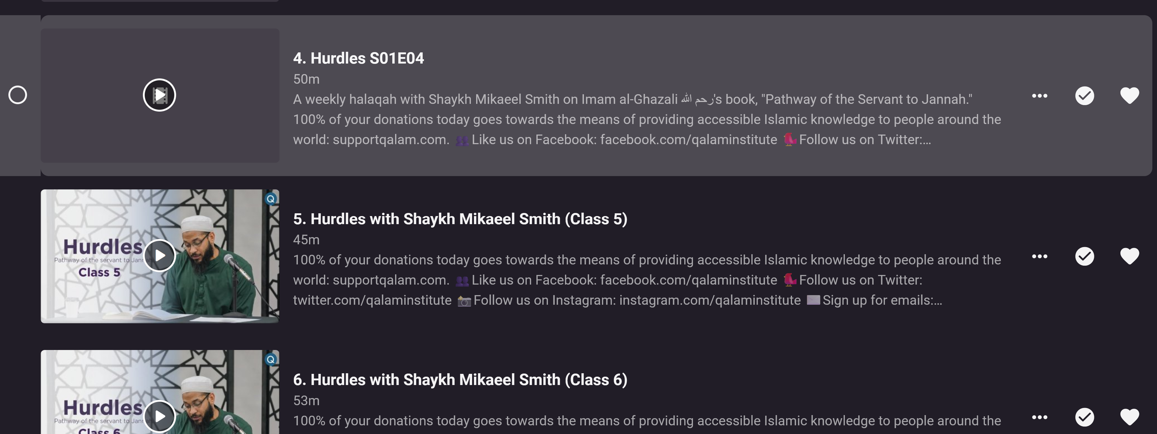

yusiboyz 0 Posted December 27, 2023 Posted December 27, 2023 Hello, I have a folder with videos downloaded from Youtube under TV shows. There are 17 episodes in there. Episodes 1 and then 5-17 are all scanned in. However, I am not sure why 2-3 is not scanning in? It is downloaded and in that folder. I hit re-scan and it doesn't add it. Any ideas on what I need to do?

yusiboyz 0 Posted December 27, 2023 Author Posted December 27, 2023 okay, I checked the naming and the naming was not following the format. So I changed the naming format on the episodes 2-4 and it added. However, how was it able to add the others? I like the format that is shown from 5 on wards. As you can see after doing the format that you showed it doesn't look as nice. Is there a reason why it added it nicely without the naming?
Neminem 1594 Posted December 27, 2023 Posted December 27, 2023 I would not know why some worked and some did not. Only advise is to follow TV Naming guide, for a better experience.

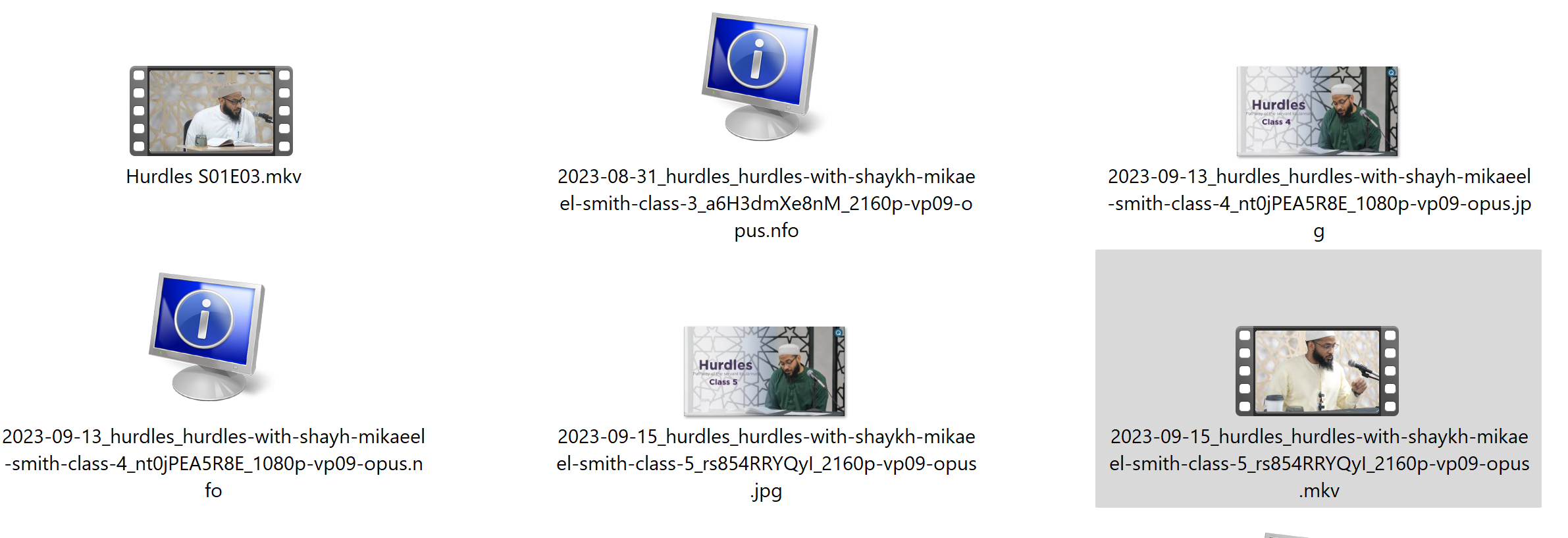

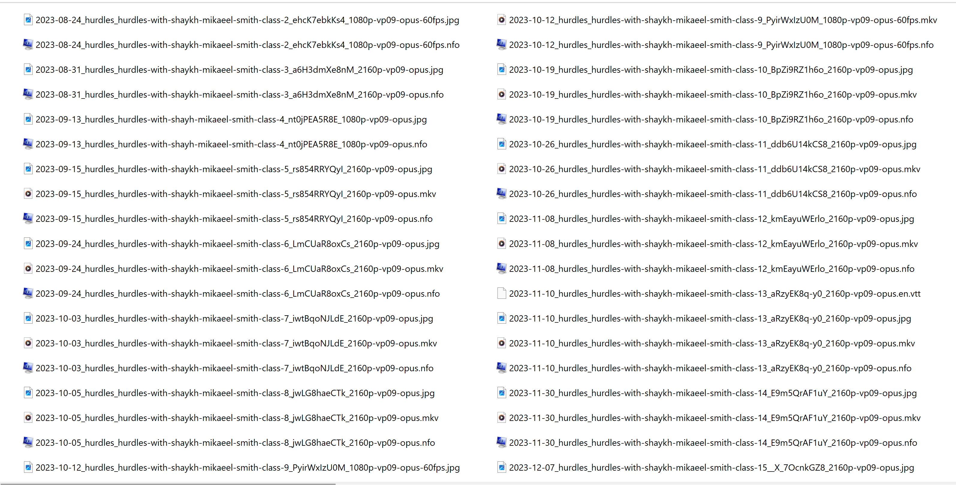

Luke 42185 Posted December 27, 2023 Posted December 27, 2023 Hi, can you please show the complete contents of the folder? Thanks.
yusiboyz 0 Posted December 27, 2023 Author Posted December 27, 2023 2 hours ago, Luke said: Hi, can you please show the complete contents of the folder? Thanks. Attached is a screenshot of the folder. Two screenshots.
Luke 42185 Posted December 28, 2023 Posted December 28, 2023 If you click on some of the episodes, do you see a version selection dropdown box? Most likely they were all imported, but some may have been incorrectly grouped together due to your file naming.
