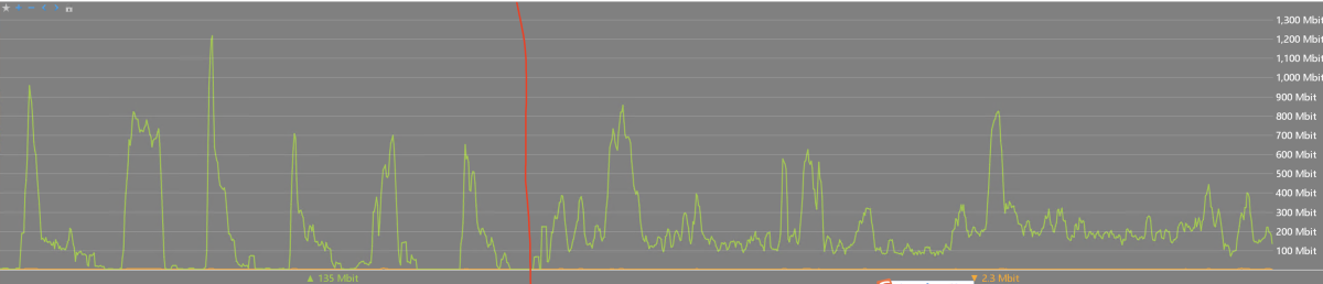

BIgdongdong1028 6 Posted December 21, 2023 Posted December 21, 2023 Hello Emby Community, I've encountered a recurring issue with my Emby installation on Windows Server and am seeking advice or solutions. The problem started in July. My Emby server intermittently stops sending data and then quickly resumes, resulting in a traffic graph that looks like large, wavelike fluctuations. This pattern consistently occurs every day between 5 PM and 12 AM. Initially, I was unable to resolve the issue and ended up reinstalling both the Windows Server OS and the Emby server software. However, a few months later, the same problem has reappeared. Through my investigations, I've mostly ruled out restrictions from my ISP. The issue also affects local network access to the Emby media library, with noticeable lag, and even accessing Emby's web interface directly from the server machine experiences delays. Interestingly, temporarily changing Emby's HTTP port seems to resolve the issue for a few days, but then the problem recurs. This issue has been troubling me for a while, and I would be grateful for any assistance or insights from the community. Thank you for your help!

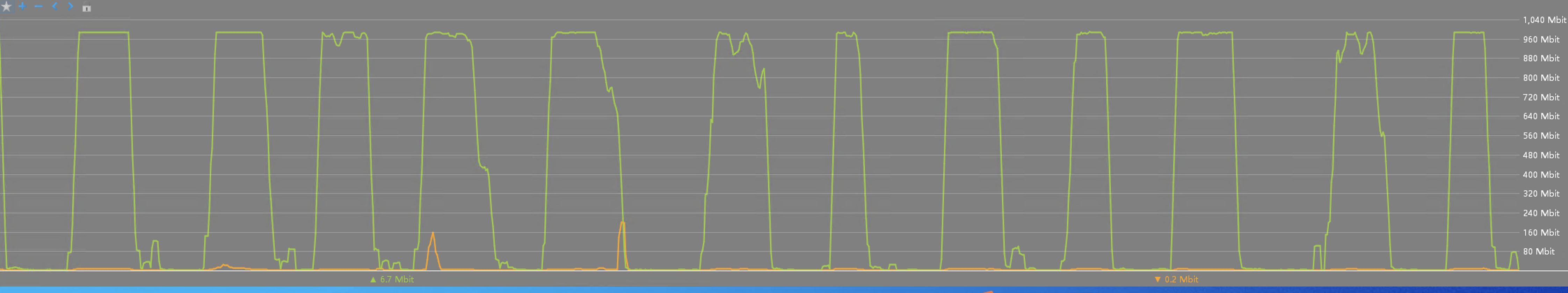

BIgdongdong1028 6 Posted December 21, 2023 Author Posted December 21, 2023 15 minutes ago, ebr said: Hi. Something else on your network that runs at that time and uses that same port? Initial troubleshooting was that no program was using the same port. And if it is using the same port to cause port blocking. Then there is no reason for it to only occur between 5pm and 12pm. This image is after 12pm and before 12pm

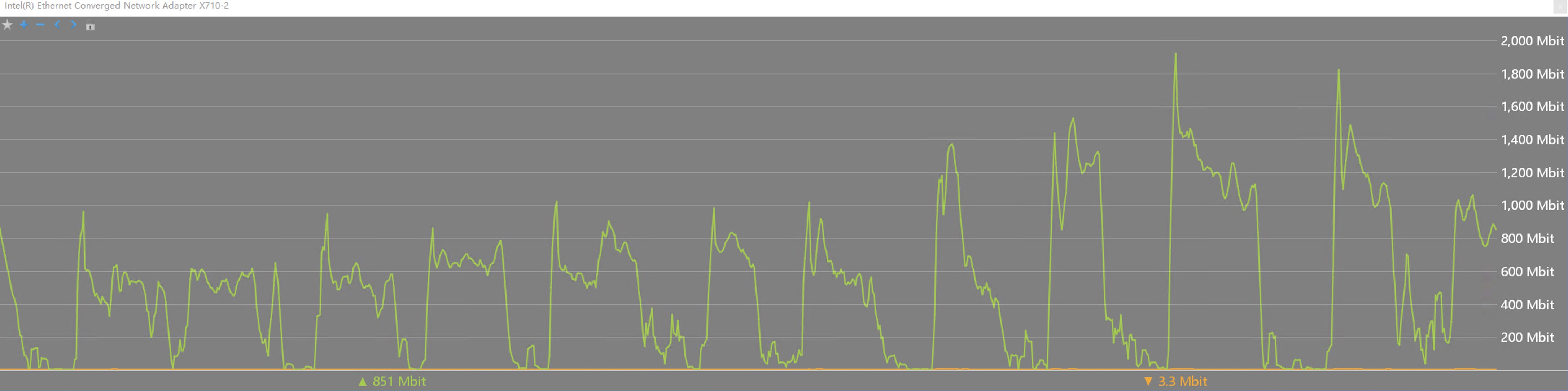

BIgdongdong1028 6 Posted December 22, 2023 Author Posted December 22, 2023 (edited) The traffic graph became more visible after I switched my network port speed to 1G. Edited December 22, 2023 by BIgdongdong1028
