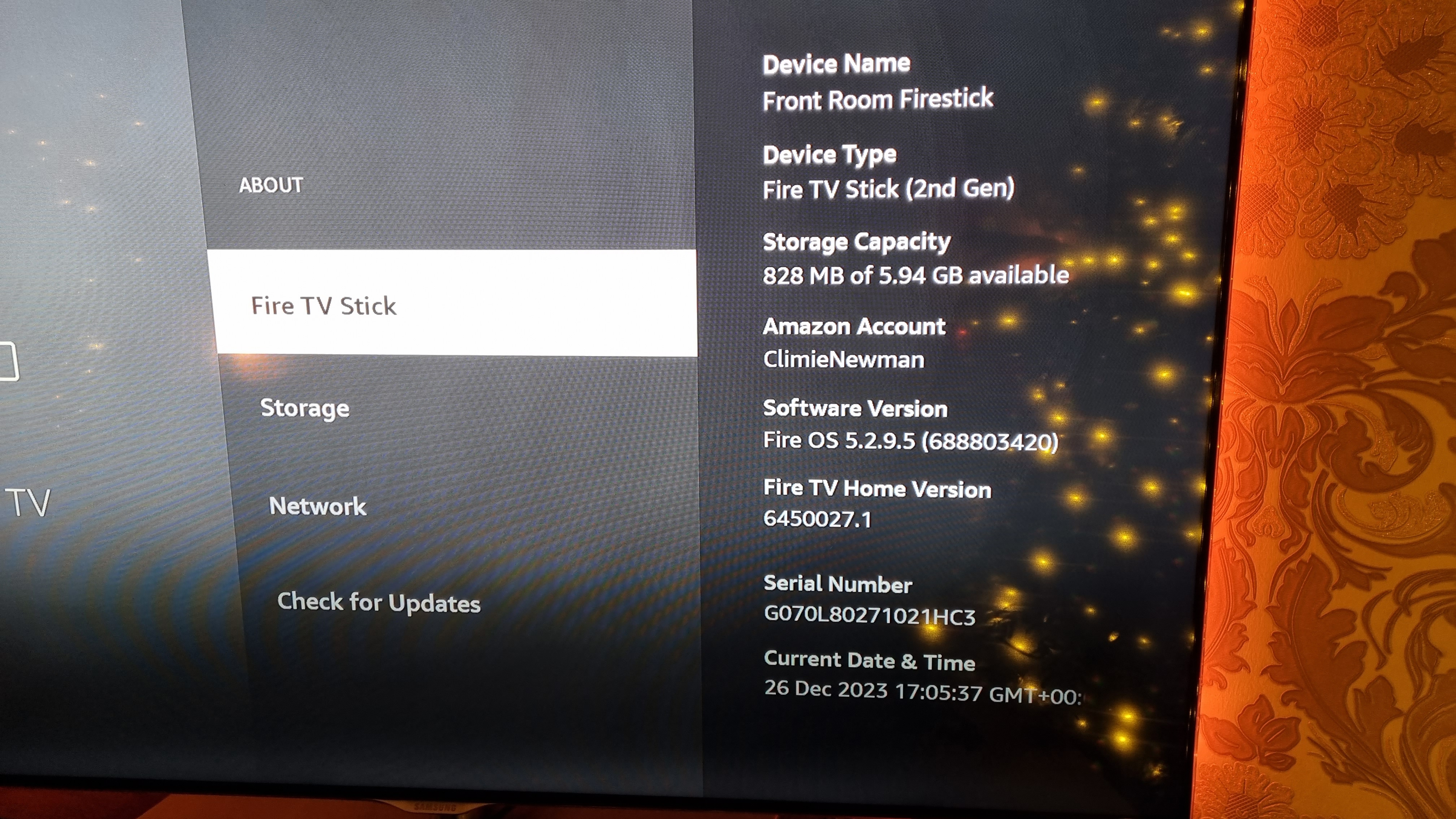

Darren & Gemma 12 Posted December 26, 2023 Author Posted December 26, 2023 Hi @Luke, @ebr Here are 2 log files. One from the older Gen 2 Firestick, this plays the file no issue. Then the Gen 3 firestick log, where it caused the diagonal green lines. Ive played the sames file from the same server on the same network. The only difference is the 2nd and 3rd Gen hardware? embyserver (Gen 3 Firestick).txt embyserver (Gen 2 Firestick).txt
ebr 16337 Posted December 26, 2023 Posted December 26, 2023 1 hour ago, Darren & Gemma said: The only difference is the 2nd and 3rd Gen hardware? Well the OS versions on the devices are different too. Are they both the same resolution? There should have been an ffmpeg log at least with the playback you showed the screen shot for. If you hit "Playback Correction" in the cog menu, does it correct it?

Darren & Gemma 12 Posted December 26, 2023 Author Posted December 26, 2023 The resolutions on the firesticks are both set to Automtic. I change the 3rd Gen to 1080p 60hz and 50hz and neither made any difference. What do the logs suggest?
ebr 16337 Posted December 26, 2023 Posted December 26, 2023 4 hours ago, Darren & Gemma said: What do the logs suggest? They don't really suggest anything. The problem is at the display level on the Fire device. We've seen it before and it is related to an "odd" resolution. @softworkzmay remember exact specifics.
