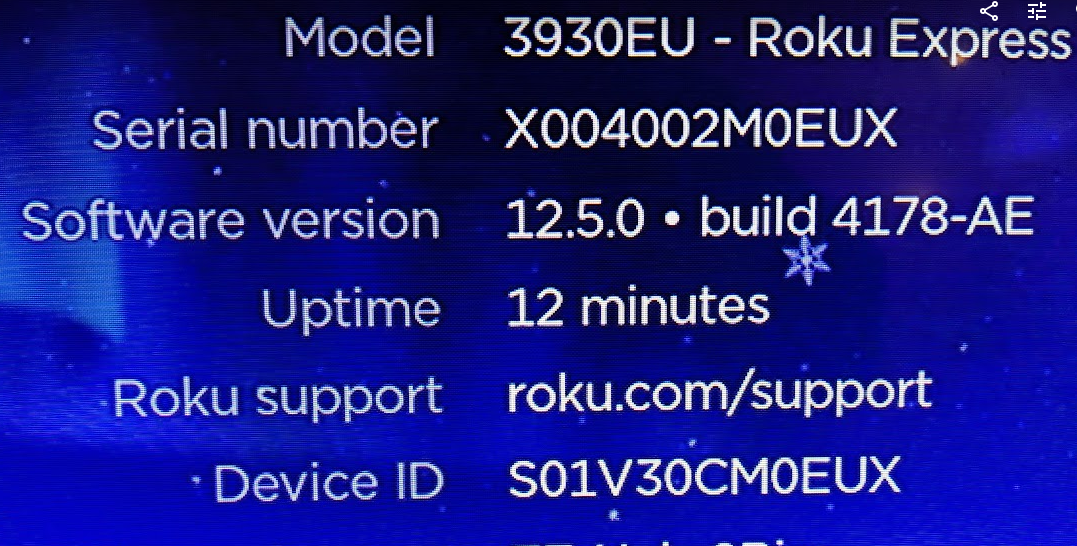

Bolo Popo 1 Posted January 5, 2024 Author Posted January 5, 2024 Since it's working (now) on all but Roku, here are the details of that. I can provide logs of it failing on that?
