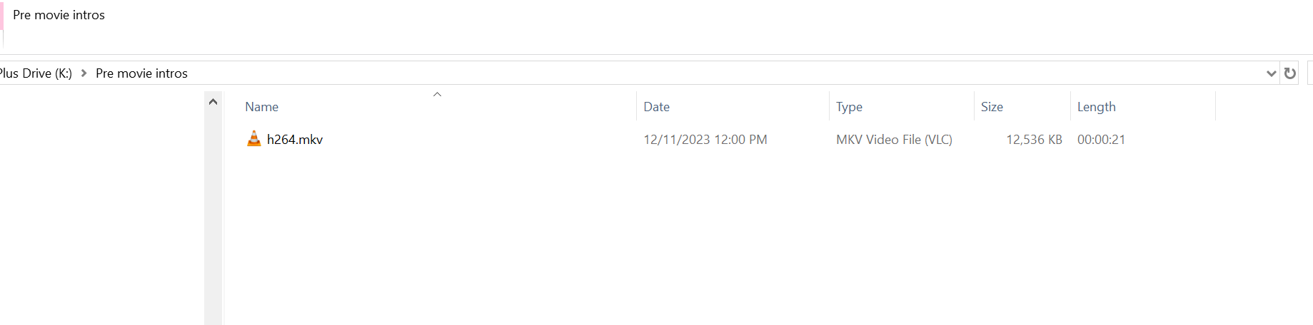

Rozy636363 0 Posted December 12, 2023 Posted December 12, 2023 (edited) Playing on a Shield Pro from a networked wired Emby server on my desktop. I have custom intros, saved as mkv and mp4 and I have got them to play before a movie by renaming the intro h264.mkv. After the intro plays, however, I get a spinning blue 'wait I'm loading wheel' followed by the message Too many errors, giving up and all playback stops. Any ideas? On a related note, I tried tags for intros for 4k movies and neither HEVC tag nor h265 work by playing the files HEVC.mp4 or h265.mp4 respectively. Of course I did put them in the folder designated and used for the intro that is working for h264. Log attached ffmpeg-transcode-aaa1a127-a039-4769-8168-b3183d7ee824_1.txt Edited December 12, 2023 by Rozy636363 clarity

Rozy636363 0 Posted December 16, 2023 Author Posted December 16, 2023 Well I tried deleting all of the files in the intro folder except h264.mkv and it did the same thing.
Luke 42245 Posted December 16, 2023 Posted December 16, 2023 11 minutes ago, Rozy636363 said: Well I tried deleting all of the files in the intro folder except h264.mkv and it did the same thing. Did you make sure to run a library scan after doing that?
ebr 16337 Posted December 16, 2023 Posted December 16, 2023 Also, exactly how do you have cinema intros configured?
Luke 42245 Posted December 16, 2023 Posted December 16, 2023 Can you show a screenshot of your cinema intros setup? Thanks.
ebr 16337 Posted December 19, 2023 Posted December 19, 2023 As a test, can you add that video to an Emby library (home videos would be best) and then see if it plays to completion properly that way?
Rozy636363 0 Posted December 20, 2023 Author Posted December 20, 2023 I did try that and there was no change. After more testing, the only combination that played an intro and then the movie was the aac.mkv intro of course associated with a movie encoded with aac audio. The only other playable file was h264.mkv, but it always returned the error message - Too many errors. Giving up. Exception - a movie encoded h264 video and aac audio apparently prioritized the audio and played the intro for aac then the movie with no errors. hevc/ac3/dts/truehd/eac3 all failed to play, ie the movie just started even with the associated files in the correct folder. Also, I tagged every movie with a tag of 'trailer', but none played any file named trailer.mp4 or trailer.mkv when they were in the correct folder.
