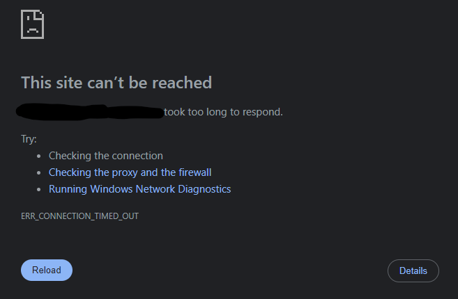

PaulE123 20 Posted December 9, 2023 Posted December 9, 2023 Hi all, this problem is brand new to me. Nothing has changed about my setup whatsoever, barring maybe some updates to my reverse proxy dockers (DuckDNS and Swag). Unraid Server (6.12.4) Emby Docker (latest stable release) Swag & DuckDNS Dockers, both fully updated. Today I happened to be on my Emby Dashboard on my PC (Windows 11), and noticed testing the WAN connection results in a web page timeout. I figured it must have been something to do with a Swag update, and spent a good while going through all of that & updating some files that the log was complaining about. No joy, nothing seems to allow me to connect via the WAN address using my PC (which I've ALWAYS been able to do for testing purposes.) LAN connection test works perfectly. Very oddly though, using my phone on a data connection, I can connect using the official Emby app over the WAN, so there's nothing actually wrong with the functionality it seems, but I just can't connect to Emby using the WAN option on my PC as I normally could. Has anyone ANY idea how to troubleshoot this?

Solution darkassassin07 670 Posted December 9, 2023 Solution Posted December 9, 2023 That sounds like an issue with NAT hairpinning no longer functioning. Presumably your domain resolves to your WAN ip? For a quick test, can you forward an external port directly to emby, then use http://<wanip>:<port> to connect from within your lan? (remove that port forward after testing) If that doesn't work, NAT hairpinning on your router is your culprit.

PaulE123 20 Posted December 10, 2023 Author Posted December 10, 2023 8 hours ago, darkassassin07 said: Router had a firmware update lately? Seems odd, but I can't think of anything specific as to why it'd be like that. Pretty much any port will do, 8093 8096 is embys default. I'd use that if it's not already open. +/- 1 if it is. Using - http://192.168.0.2:8096/web/index.html#!/home - works perfectly on the LAN (port 8096). Using https://XXXXXX.duckdns.org:443 - nothing, page took too long to respond error. I've changed nothing about my setup whatsoever. It was literally working perfectly Friday night, and by Saturday morning it's collapsed.

darkassassin07 670 Posted December 10, 2023 Posted December 10, 2023 (edited) 10 hours ago, PaulE123 said: Using - http://192.168.0.2:8096/web/index.html#!/home - works perfectly on the LAN (port 8096). Using https://XXXXXX.duckdns.org:443 - nothing, page took too long to respond error. I've changed nothing about my setup whatsoever. It was literally working perfectly Friday night, and by Saturday morning it's collapsed. That's using your lan ip and skipping NAT hairpinning. You've completely skipped the test we were trying and just used a direct local connection instead... You have to use your routers wan ip from within your lan for this test. After forwarding port 8096 from wan to emby. Edited December 10, 2023 by darkassassin07
PaulE123 20 Posted December 12, 2023 Author Posted December 12, 2023 Apologies folks, haven't had a minute to get back to this over the last few days. @sskwhiteshadowyep I'm using 443 for my Emby remote connection. I followed the Spaceinvaderone guide for setting up an Unraid reverse proxy some years back. It has worked perfectly up until now. I've added a forwarding rule in my router, pointed at my Unraid server (Emby). Validation through Emby is handled by reverse proxy (SWAG and then DuckDNS for DNS). @darkassassin07I've tried the hairpinning test there using 8096 (created new rule to forward to Unraid IP, and then tried to connect using browser & the format you advised....same result, site can't be reached.
darkassassin07 670 Posted December 12, 2023 Posted December 12, 2023 That tells me NAT hairpinning is not functional on your network. That's why you're typical remote test from within lan isn't working, while regular wan connections are. Why hairpinning isn't working I'm not sure. You'll have to look into your router config for that. 1
