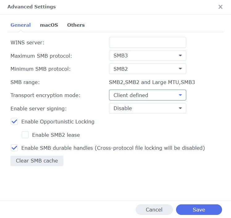

Audiomixer 374 Posted September 4, 2024 Posted September 4, 2024 On 8/19/2024 at 7:32 AM, Audiomixer said: On three shields i could never get that direct file play to work correctly. @FrostByteand i spent considerable time comparing our systems to trouble shoot and it was a no go. If you do manage to figure it out, i would be very curious to learn your solution, I finally figured it out! I set max smb protocol to smb3 and min to smb2 on my synology nas (they already were but i wanted to verify it). But what did the trick were the switches Enable Opportunistic Locking and Enable SMB durable handles. After enabling these, now everything plays. Finally! I just tried this on shield number two and it too is playing files now. @FrostByte @rbjtech 2
FrostByte 5451 Posted September 5, 2024 Posted September 5, 2024 (edited) 2 hours ago, Audiomixer said: I finally figured it out! I set max smb protocol to smb3 and min to smb2 on my synology nas (they already were but i wanted to verify it). But what did the trick were the switches Enable Opportunistic Locking and Enable SMB durable handles. After enabling these, now everything plays. Finally! I just tried this on shield number two and it too is playing files now. @FrostByte @rbjtech Well...dang... Congrats. I don't have those on anymore, I guess since you were having problems with large files the better client caching did the trick? https://kb.synology.com/en-br/DSM/help/SMBService/smbservice_smb_settings?version=7 I had those checked a long time ago, but I think I read something somewhere that made me turn them off. Edited September 5, 2024 by FrostByte

rbjtech 5341 Posted September 5, 2024 Posted September 5, 2024 10 hours ago, Audiomixer said: I finally figured it out! I set max smb protocol to smb3 and min to smb2 on my synology nas (they already were but i wanted to verify it). But what did the trick were the switches Enable Opportunistic Locking and Enable SMB durable handles. After enabling these, now everything plays. Finally! I just tried this on shield number two and it too is playing files now. @FrostByte @rbjtech Interesting. I thought oplocks were always 'on' with SMB2+ Maybe that's a Windows rule as opposed to a protocol rule - and Synology have given you the choice. Oplocks are pretty essential for a high speed data cache - which makes perfect sense for a 4k remux stream. I've no idea what 'durable handles' is though - need to look that one up !
FrostByte 5451 Posted September 5, 2024 Posted September 5, 2024 I tried those two settings on my NAS, and it caused a 30+ second delay in the start of all media. Tried turning on/off several times and it was the same every time. 30+ second delay. For movies it wasn't bad, but when playing a music playlist that is a long time to wait between songs.
Audiomixer 374 Posted September 5, 2024 Posted September 5, 2024 4 hours ago, FrostByte said: I tried those two settings on my NAS, and it caused a 30+ second delay in the start of all media. Tried turning on/off several times and it was the same every time. 30+ second delay. For movies it wasn't bad, but when playing a music playlist that is a long time to wait between songs. 30 sec delay? Mine is about 17 sec for a 4k remux to start. 14 hours ago, FrostByte said: Well...dang... Congrats. I don't have those on anymore, I guess since you were having problems with large files the better client caching did the trick? https://kb.synology.com/en-br/DSM/help/SMBService/smbservice_smb_settings?version=7 I had those checked a long time ago, but I think I read something somewhere that made me turn them off. That was the synology kb i used to play with the settings. Joy! 14 hours ago, FrostByte said: So, yours looks like this now? Yup that is what i have now. 8 hours ago, Teddyknuddel said: How sad - you finally get it to work, and then the only app that supports the direct path is to be terminated. Ja, but it is still the better app experience. 6 hours ago, rbjtech said: Interesting. I thought oplocks were always 'on' with SMB2+ Maybe that's a Windows rule as opposed to a protocol rule - and Synology have given you the choice. Oplocks are pretty essential for a high speed data cache - which makes perfect sense for a 4k remux stream. I've no idea what 'durable handles' is though - need to look that one up ! My mouth dropped open when my remux files actually played. 2

Audiomixer 374 Posted September 5, 2024 Posted September 5, 2024 3 hours ago, rbjtech said: wow - mine start in about 1-2 seconds ... I disabled durable handles and it all still works but file playback starts at about 9 seconds now so that is an improvement. 2
FrostByte 5451 Posted September 6, 2024 Posted September 6, 2024 I had to turn them both off. I think it helped a little to turn off durable handles, but it still took too long. It starts instantly now again with them both off. 1

Audiomixer 374 Posted September 6, 2024 Posted September 6, 2024 13 hours ago, FrostByte said: I had to turn them both off. I think it helped a little to turn off durable handles, but it still took too long. It starts instantly now again with them both off. On mine if both are off then it doesn’t work at all. 1
