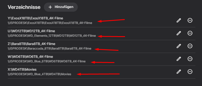

rbjtech 5341 Posted August 20, 2024 Posted August 20, 2024 So you may need to wait for the shield to index the files. In vlc or a file mgr on the shield, browse/play the file via the unc. If it plays fine, then so should emby. Remember the optional path needs to be the same as the shield - ie capd server name - \\CAPS_SERVER\share Also worth checking the file share on the shield to check it has x gb/tb on it. If its zero, then it could be permissions. I'm using a windows smb share with a dedicated username and pwd - but it should not make any difference as long as the shield has smb read access.

Teddyknuddel 136 Posted August 20, 2024 Author Posted August 20, 2024 I have just managed to get every video to show file instead of http. The error was that the network path was too long. I have re-shared every single folder above the videos. Old path: \\SERVER\EXOS18TB\Emby\EXOS18TB-Movies New path: \\SERVER\EXOS18TB-Movies Then disconnected the server on the shield and reconnected it - restarted the shield and everything works as it should. 1

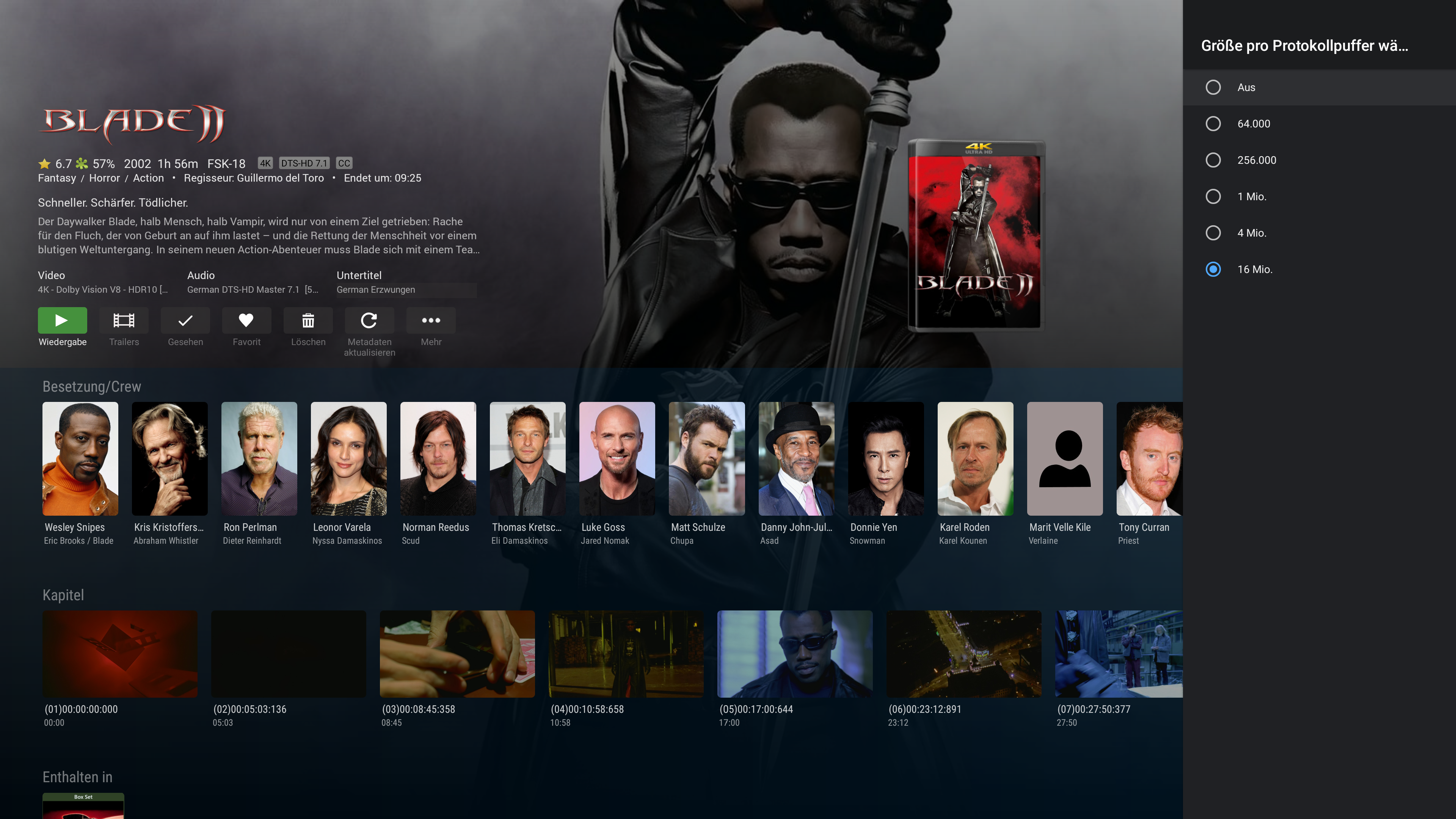

Teddyknuddel 136 Posted August 21, 2024 Author Posted August 21, 2024 (edited) 6 hours ago, Audiomixer said: My problem isn’t pathing as they are already short. The pathing works. Just not big remux files. Yet in kodi and vlc they will play fine. Have you set "logger buffer size" to 16MB in the developer options on the shield? It is said on the Internet that this would make the Exoplayer run much better. I have just played Blade II as a clean file with a bit rate of 71.1MB/s. Edited August 21, 2024 by Teddyknuddel
Teddyknuddel 136 Posted August 21, 2024 Author Posted August 21, 2024 Then I'm at my wit's end too. I strongly assume that you also operate the Shield directly via LAN?
