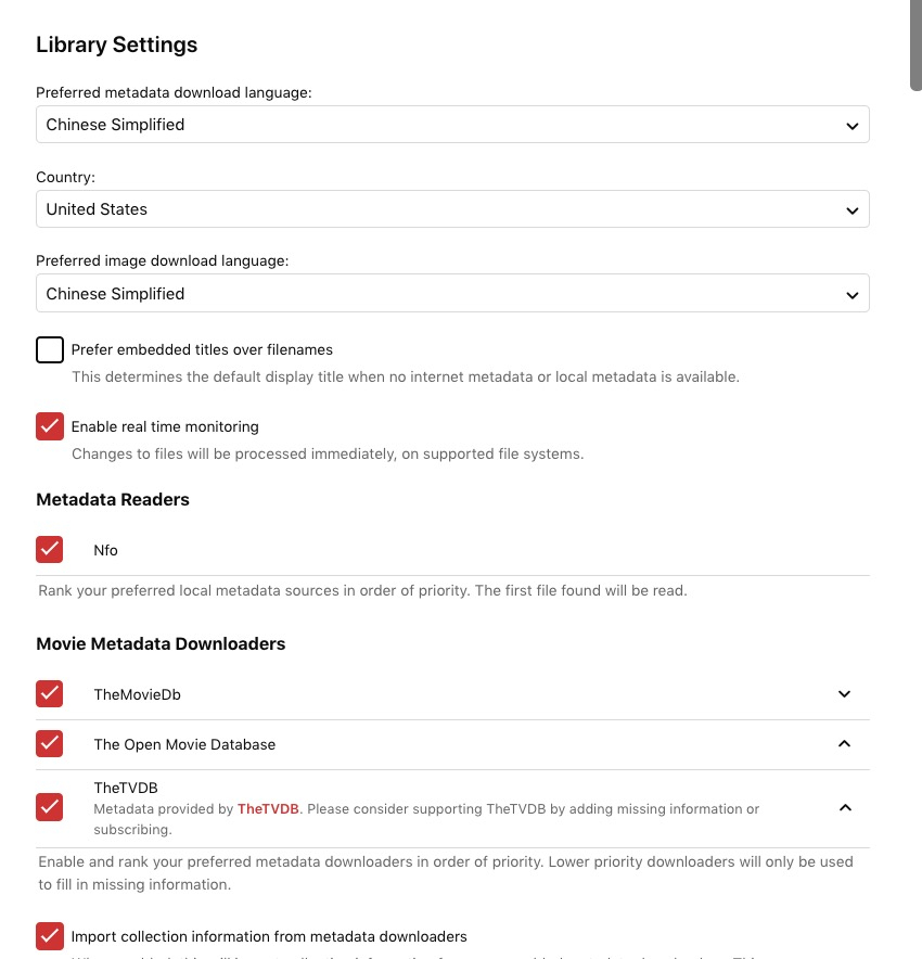

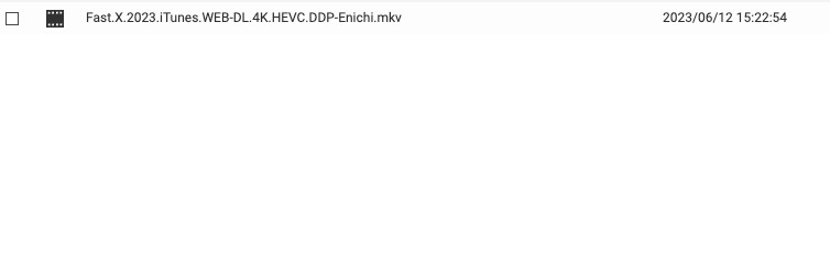

josephokking 4 Posted December 6, 2023 Posted December 6, 2023 I created an EMBY server through docker on Qnap and enabled the Premiere license. When I created the TV library and scanned the folder, it successfully created the files under the folder, just like the image-1. But then I created the Movie library and scanned it. It has the info on the web page, but no .nfo or .jpg file under the folder. I checked the permission and ensured the folder's access level had chmod 777. Why did that happen and how could I make EMBY create these files? Thank you very much!
