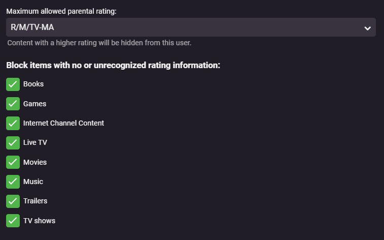

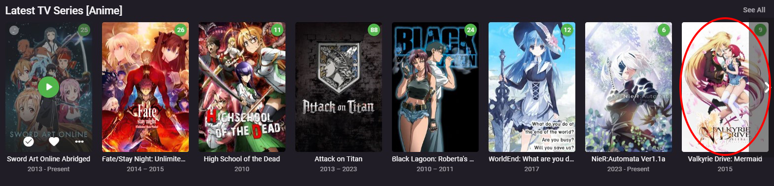

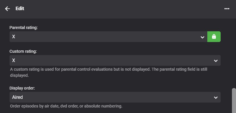

I have a few anime series that are rated TV-MA that are IMO more them TV-MA. I don't really want more adult type visible with ones that just violent. I increased the rating to X so they are not visible. When you go into anime series list, its just as it should be, the ones marked X are not visible. When you are on home screen It is visible and watchable. I tried to scan the library and refresh metadata with not luck. Any good suggestion on how to deal with this problem. The user in question cannot see ratings past TV-MA. I have the rating on the series set as X in both of the rating fields.
