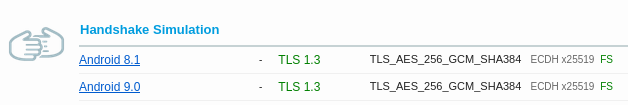

PutzJimmy 6 Posted December 30, 2023 Posted December 30, 2023 (edited) Yes. Its from lets encrypt via synologys reverse proxy. Did a ssl test and got good scores there and jellyfin has no problems on those problem devices Edited December 30, 2023 by PutzJimmy

rbjtech 5344 Posted January 8, 2024 Posted January 8, 2024 (edited) Enable TLS 1.2 - Enforcing TLS 1.3 is very strict and may be the issue. Only TLS 1.0 and TLS 1.1, SSL2 and SSL 3 should be disabled. You can still get an A+ with this config. Edited January 8, 2024 by rbjtech
Solution PutzJimmy 6 Posted January 8, 2024 Solution Posted January 8, 2024 FINALLY! Found where to change that for Emby in DSM and now the old devices work too with TLS 1.2. https://kb.synology.com/en-global/DSM/help/DSM/AdminCenter/connection_security_advanced?version=7 3 1
