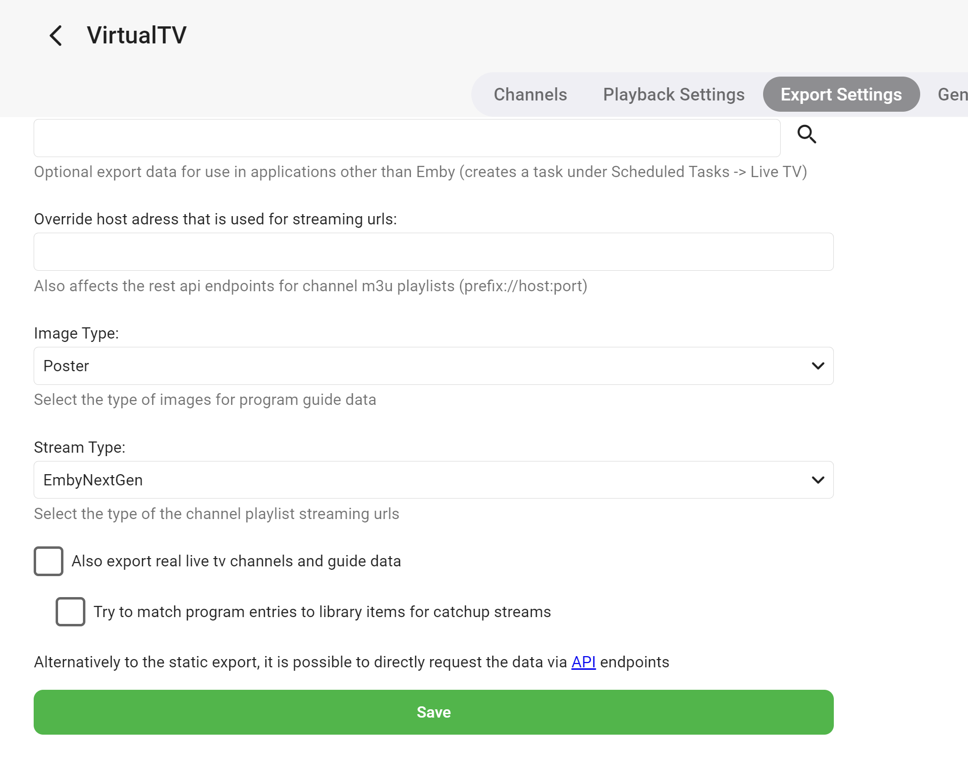

quickmic 1709 Posted February 17, 2024 Author Posted February 17, 2024 @Seger What kind of channel setup do you use? -> screenshots of you settings please.
Seger 123 Posted February 17, 2024 Posted February 17, 2024 Please find attached the config file of the addon, everything is included. I have subsequently changed my user name. Use VirtualTV in the latest DEV from the Emby catalogue In the export settings I just generated a user, but I don't know if it is needed for Kodi now. VirtualTV.xml
