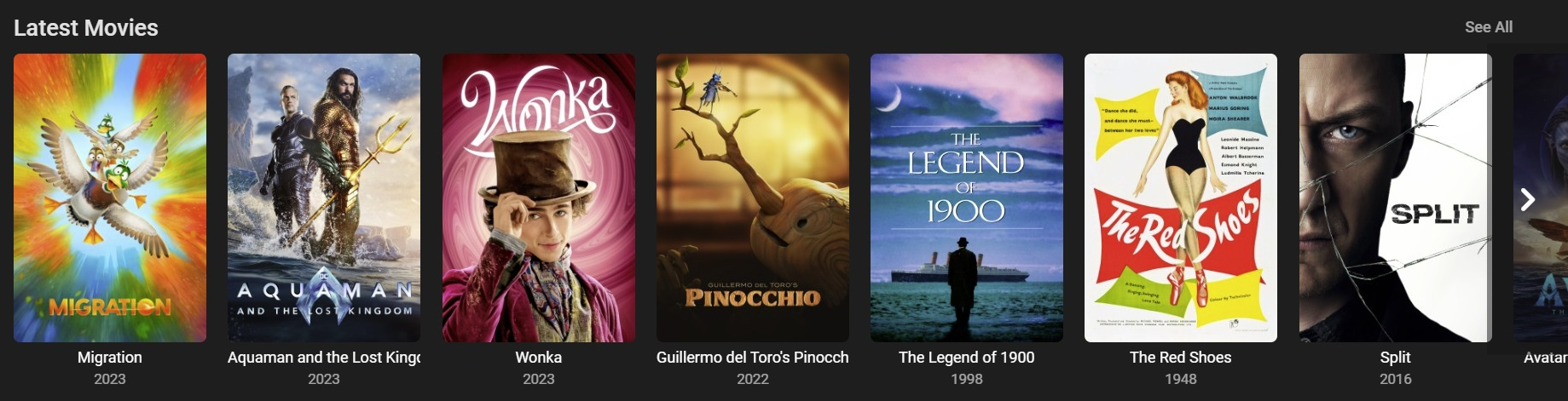

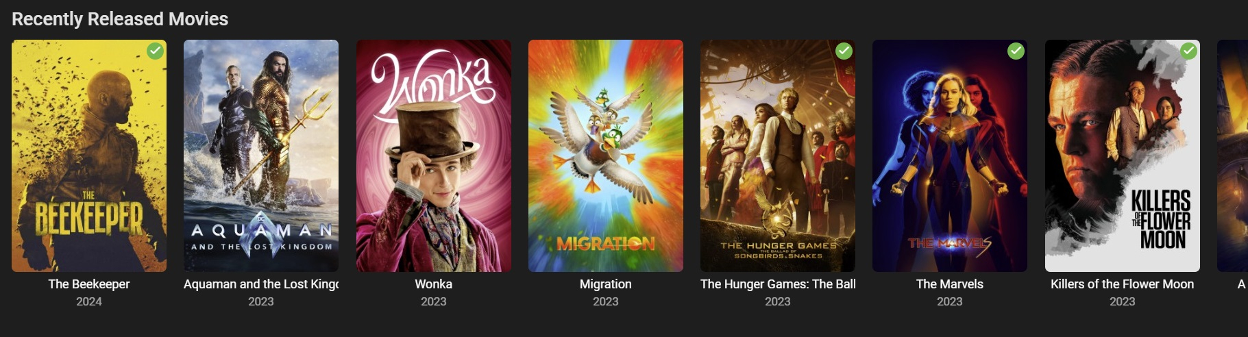

FrostByte 5453 Posted February 5, 2024 Posted February 5, 2024 Emby server 4.8 has a new node called Recently Released Movies. Was wondering if you could add something similar next round. Kind of a combination of several current nodes. <?xml version="1.0" encoding="UTF-8" standalone="yes" ?> <node order="5" type="filter"> <label>Recently Released Movies</label> <icon>DefaultRecentlyAddedMovies.png</icon> <content>movies</content> <match>all</match> <rule field="tag" operator="is">Movies</rule> <order direction="descending">year</order> <limit>25</limit> </node> Or, a Recently Released Unwatched Movies <?xml version="1.0" encoding="UTF-8" standalone="yes" ?> <node order="5" type="filter"> <label>Recently Released Unwatched Movies</label> <icon>DefaultRecentlyAddedMovies.png</icon> <content>movies</content> <match>all</match> <rule field="tag" operator="is">Movies</rule> <rule field="playcount" operator="is">0</rule> <order direction="descending">year</order> <limit>25</limit> </node>

FrostByte 5453 Posted February 5, 2024 Posted February 5, 2024 2 minutes ago, quickmic said: What's the difference between Recently Released Movies and Recently Added Movies and Movies by year? Recently Added (or Latest Movies in Emby home screen) sorts by the date added to Emby. So, if I add an older movie to Emby it will be in Latest movies. Recently Released Movies are sorted by the date the studios release the movies to theaters, etc.
quickmic 1709 Posted February 5, 2024 Author Posted February 5, 2024 Recently Released Movies are sorted by the date the studios release the movies to theaters, etc. This is the same as sort by year (on Kodi, which is the release date). Still not sure what's the difference.
FrostByte 5453 Posted February 5, 2024 Posted February 5, 2024 7 minutes ago, quickmic said: Recently Released Movies are sorted by the date the studios release the movies to theaters, etc. This is the same as sort by year (on Kodi, which is the release date). Still not sure what's the difference. I couldn't find a node which worked the same except "All" movies sorted by Year and that makes it 5,000 lines long. All other nodes take 25 movies and then sort. So, I end up with the same thing in the first pic, but sorted by year.
