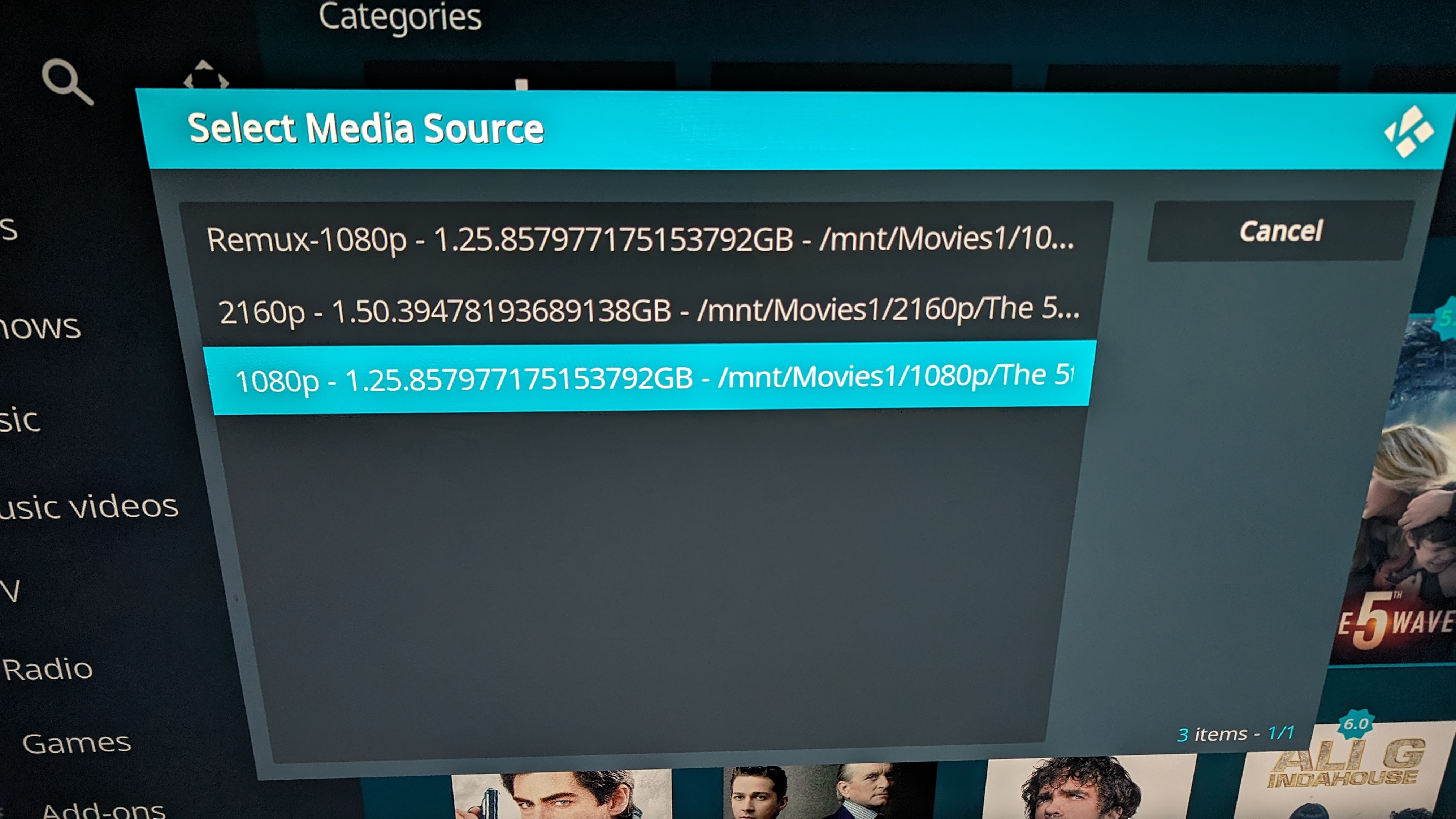

838Joel 63 Posted February 1, 2024 Posted February 1, 2024 9 hours ago, quickmic said: In next version I'll fix a few player issues anyway but nothing related to the multicontent selection. Ok here are the logs https://paste.kodi.tv/badobudinu The strange thing now is that I have 3 different versions to choose from, instead of 2!!! All I did yesterday was split the movie versions to watch it, and after I marked on Emby server has unwatched and group back together the versions! Something is weird! I may have to reset the database and start over in the next plugin version! I'll wait until you check it out before going to upgrade with 9.4.2 1
838Joel 63 Posted February 1, 2024 Posted February 1, 2024 46 minutes ago, 838Joel said: Ok here are the logs https://paste.kodi.tv/badobudinu The strange thing now is that I have 3 different versions to choose from, instead of 2!!! All I did yesterday was split the movie versions to watch it, and after I marked on Emby server has unwatched and group back together the versions! Something is weird! I may have to reset the database and start over in the next plugin version! I'll wait until you check it out before going to upgrade with 9.4.2 Here now the 3 choices I have for the two versions of movie... Strangely the top one has the Remux word to it and was not there yesterday!
838Joel 63 Posted February 1, 2024 Posted February 1, 2024 1 hour ago, 838Joel said: Here now the 3 choices I have for the two versions of movie... Strangely the top one has the Remux word to it and was not there yesterday! The newly one that was added, the first, this one with the prefix Remux-1080p works fine... But the filename showed is the same!

quickmic 1709 Posted February 1, 2024 Author Posted February 1, 2024 2 hours ago, 838Joel said: Ok here are the logs https://paste.kodi.tv/badobudinu The strange thing now is that I have 3 different versions to choose from, instead of 2!!! All I did yesterday was split the movie versions to watch it, and after I marked on Emby server has unwatched and group back together the versions! Something is weird! I may have to reset the database and start over in the next plugin version! I'll wait until you check it out before going to upgrade with 9.4.2 Well I see one issue in the log, and I'll check if the "mark as watched" is the source of the issue.
quickmic 1709 Posted February 1, 2024 Author Posted February 1, 2024 (edited) 2 hours ago, 838Joel said: Here now the 3 choices I have for the two versions of movie... Strangely the top one has the Remux word to it and was not there yesterday! What are the paths of the versions? I cannot see it in your screenshot. The marked as watched is not causing any issues, but maybe the split... I'll check that too. Edited February 1, 2024 by quickmic

838Joel 63 Posted February 1, 2024 Posted February 1, 2024 11 hours ago, quickmic said: What are the paths of the versions? I cannot see it in your screenshot. The marked as watched is not causing any issues, but maybe the split... I'll check that too. something like: /mnt/Movies1/1080p/The 5th Wave (2016) or /mnt/Movies1/2160p/The 5th Wave (2016)
quickmic 1709 Posted February 1, 2024 Author Posted February 1, 2024 (edited) 17 minutes ago, 838Joel said: something like: /mnt/Movies1/1080p/The 5th Wave (2016) or /mnt/Movies1/2160p/The 5th Wave (2016) ok. I fixed the player crash (just a side effect), but not still not found the source of the triple content. Can you remember what you did? I think you had a multiversion content in the first place, then you dissolved the content. How? Remove one of the versions, or moving it to another folder? How did you re-add the content? II still looking for a test case. btw, you need to repair your library on Kodi, it's out of sync. Edited February 1, 2024 by quickmic

838Joel 63 Posted February 1, 2024 Posted February 1, 2024 (edited) 4 hours ago, quickmic said: ok. I fixed the player crash (just a side effect), but not still not found the source of the triple content. Can you remember what you did? I think you had a multiversion content in the first place, then you dissolved the content. How? Remove one of the versions, or moving it to another folder? How did you re-add the content? II still looking for a test case. btw, you need to repair your library on Kodi, it's out of sync. I try to remember, on emby server 4.7.14 (using a previous version of plugin 9.4.1 I think I was running 8.x.x) I selected the two same movies with different resolution, and choose option (...) Group Versions. was working then using 8.x.x if I recall correctly...! After updates to 9.4.1, From there I was not able to play either version (1080p, 2160p). I did in the media info, I clicked Split Versions Apart on the server... Then I was able to play again (after sync) the movie. Went back and Group versions again, this is where I started to see a third line in the available versions when trying to play it.... The newly added (3rd) was starting now with Remux-1080 and was playable, the two same other was starting only with 1080 or 2160, and was not playable. So I never played around moving files etc. Today, I tried to reset the nodes to see if the versions will be fixed and back to only two version (Not work, always 3 versions), I reset the database and start over configuring the plugin, had to force a sync of library... But now the sync takes forever and it stuck after hours+ at 85% in the TV Shows scan. Something not going correctly now.... I should (still on 9.4.1) reset everything and go with the latest 9.4.3? See if this will work better...??? Any other steps to make sure I freshly start over and fix the issues here? Edited February 1, 2024 by 838Joel 1
quickmic 1709 Posted February 2, 2024 Author Posted February 2, 2024 6 hours ago, 838Joel said: option (...) Group Versions. Oh, I see. Never thought about doing it manually. My approach was letting Emby detect multi version based on filename tags. I'll check that too and see what Emby server reports to the plugin. Quote But now the sync takes forever and it stuck after hours+ at 85% in the TV Shows scan. Please send me another log with the stucked sync. Sorry for all the hassle, but really helps me to shake out bugs.
