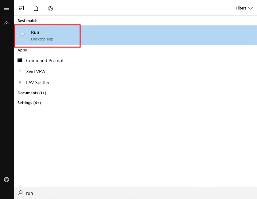

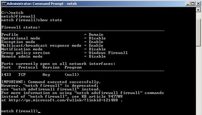

sskwhiteshadow 2 Posted December 4, 2023 Posted December 4, 2023 (edited) Connect to wifi and collect: - open command prompt (CMD) > ipconfig - type "run" and open from windows start button Spoiler -type "netsh" ; {enter key} > C:\netsh > Firewall > Show State Spoiler Connect to ethernet and collect the same thing above as it sounds like network related now. And also can you define "his wifi" and not ethernet. Does this mean: When connected to wifi it works and when i connect directly to the wifi/router via ethernet it doesnt work? Edited December 4, 2023 by sskwhiteshadow
