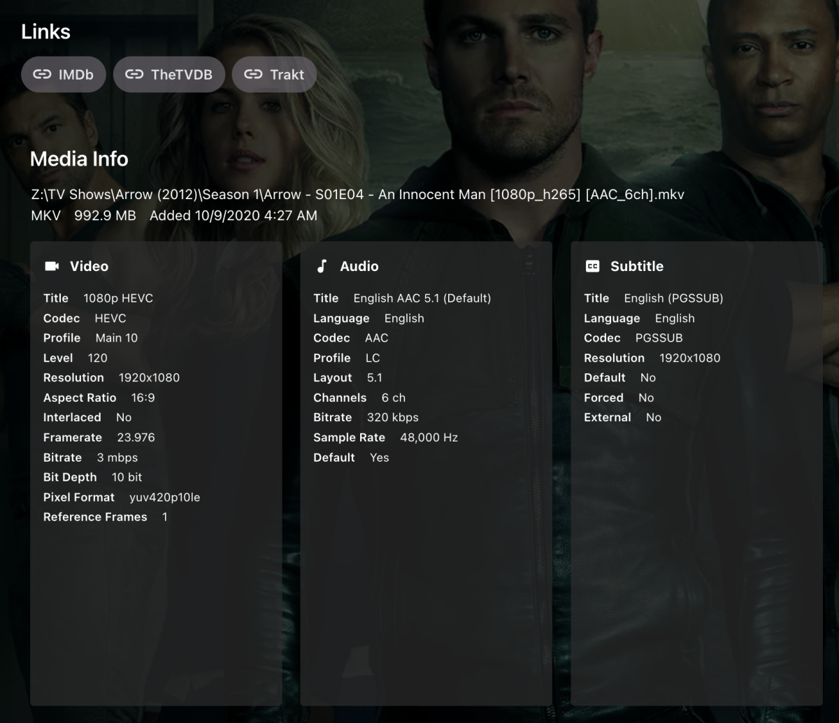

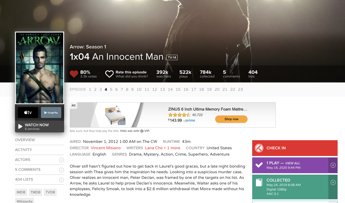

jashwa 9 Posted December 3, 2023 Posted December 3, 2023 (edited) I have set up the trakt plugin and run the initial library sync. It finished in 3 seconds which seems unlikely and syncing plays took about the same amount of them. No plays have synced, but there are no errors. From what I can tell, the shows are properly recognizing the trakt item (the link on the episode takes me to the correct trakt page which shows the play). I am running my server on Windows 11. Attached are screenshots and the server logs. Existing troubleshooting steps. I have looked through other posts of similar issues. I have uninstalled and reinstalled the plugin, restarted each time. I have unauthorized and reauthorized with a new pin. I have also watched shows on emby, they are not syncing the other way. I have manually added a play on trakt for right now and still does not sync. embyserver.txt Edited December 3, 2023 by jashwa Added additional information on existing troubleshooting steps

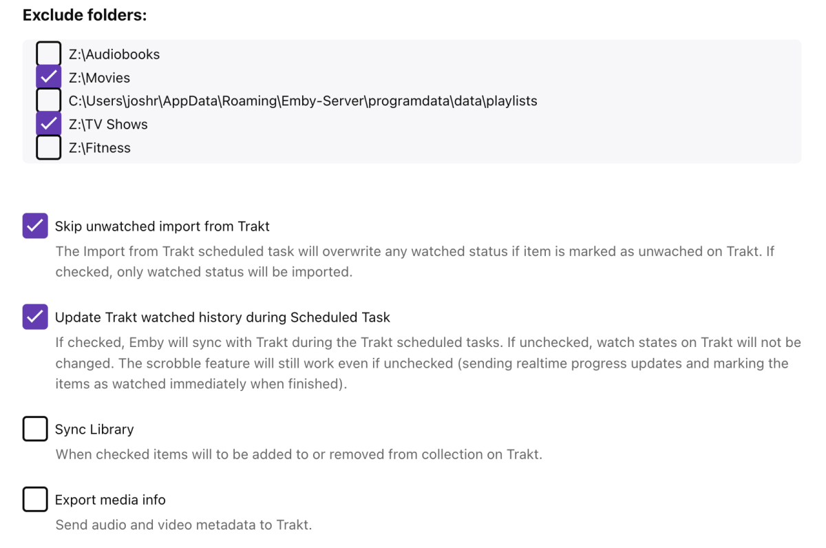

Luke 42185 Posted December 3, 2023 Posted December 3, 2023 Hi there, how did you configure the plugin?
jashwa 9 Posted December 3, 2023 Author Posted December 3, 2023 I have tried pretty much every permutation with no difference in result, but this is the config I landed on.
Neminem 1594 Posted December 3, 2023 Posted December 3, 2023 It looks like you are Excluding your movies and tv shows. That means you are only syncing Audoubooks, playlists and fitness. I think you got your check marks wrong
jashwa 9 Posted December 3, 2023 Author Posted December 3, 2023 Yep. Apparently after 4 hours of troubleshooting on my end, it was an IBCAK error. Thank you for noticing that! Wish I reached out earlier. Totally saw checking as what to include and every time I read the settings, must have read what I expected to see instead of what was there. I appreciate you. 1
