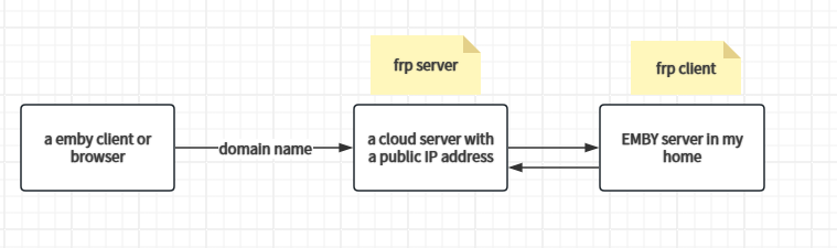

LonginusL33T 3 Posted December 1, 2023 Author Posted December 1, 2023 9 minutes ago, Luke said: Hi, is this for two different servers, or the same server? Same emby server. My ISP doesn't have the ability to provide public IP addresses, so I use two cloud servers for reverse proxy. When one server is busy, I will use another server's domain name to access EMBY.

justinrh 267 Posted December 2, 2023 Posted December 2, 2023 Can you explain how the cloud servers are proxy-ing for you? It sounds like you connected your home Emby server to the cloud, then connect to the cloud. But then that wouldn't make sense if you can't get a public IP at the house. So, like if the address field had an recently-used list or bookmark function, right?
LonginusL33T 3 Posted December 2, 2023 Author Posted December 2, 2023 7 hours ago, Luke said: Would a ddns not be a better option for you? I can't use DDNS because I don't have a public IP address. I need a cloud server with a public IP address to do NAT traversal. This is the only way I can access my home EMBY server from the extranet
LonginusL33T 3 Posted December 2, 2023 Author Posted December 2, 2023 1 hour ago, justinrh said: Can you explain how the cloud servers are proxy-ing for you? It sounds like you connected your home Emby server to the cloud, then connect to the cloud. But then that wouldn't make sense if you can't get a public IP at the house. So, like if the address field had an recently-used list or bookmark function, right? I use FRP to do NAT traversal. fatedier/frp: A fast reverse proxy to help you expose a local server behind a NAT or firewall to the internet. (github.com) 1
