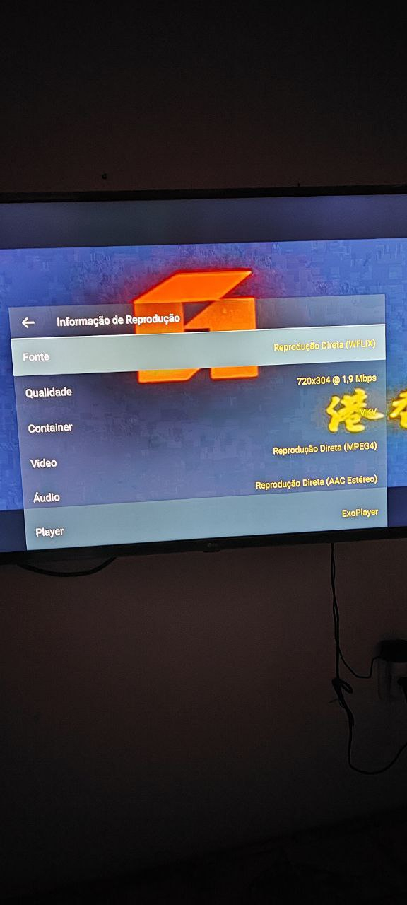

thezaca13 0 Posted December 1, 2023 Posted December 1, 2023 (edited) Dear friends I have a problem with files in MPEG4 XVID format, my Mibox S 4K is always transcoding when I play files in this format, from what I saw in the description of the box, it has a Video Decoder 4K at 60fps, VP9, H.264, MPEG1/2/4, VC-1, Real8/9/10 so I don't understand why this problem is only happening on this device. Below is a print I carried out a test with the same files on other devices in my house and it played without problems. I also did a test on Plex to see if there would be any problems with the same file and it ran successfully. ffmpeg-transcode-907cc7d3-a609-4212-8974-364540ae4551_1.txt hardware_detection-63836990006.txt Edited December 1, 2023 by thezaca13

thezaca13 0 Posted December 1, 2023 Author Posted December 1, 2023 6 hours ago, ebr said: XVID is notoriously problematic. Hi. Can you try sideloading our standard android app on the same device and see how that compares? https://emby.media/emby-for-android.html Thanks. I went back to version 2.93 that I downloaded from the emby website for Android TV and the same transcode problem remains. The question is, is the problem with the emby player!? I carried out the same test on Plex and it is reproducing the MPEG4 format directly via Mibox S 4K. ffmpeg-transcode-82de0b64-b7cd-4537-801d-5274436136ba_1.txt

thezaca13 0 Posted December 2, 2023 Author Posted December 2, 2023 3 hours ago, Luke said: Hi. Can you try sideloading our standard android app on the same device and see how that compares? https://emby.media/emby-for-android.html Thanks. I went back to version 2.83 and now playing MPEG4 without transcode works correctly. So there is a problem in the player of the most current app for Android TV that is causing transcode in this video format.
