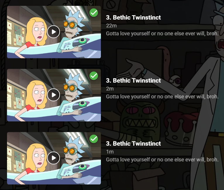

RanmaCanada 503 Posted November 30, 2023 Posted November 30, 2023 I've had this problem before and it is a pain in the butt to deal with when Emby does something completely stupid and merges extras with the episodes they are for. I am sick and tired of this constantly breaking and having to go in and split versions apart, especially after the files are named properly. My current example is for Rick and Morty Rick.and.Morty.S06E03.Bethic.Twinstinct <--named correctly Rick.and.Morty.S00E613.Anatomy.of.a.Scene.Bethic.Twinstinct <--should be correct name as S00 is Extras and E6xx is for season 6 Rick.and.Morty.S00E623.Inside.Bethic.Twinstinct <-- same as above. S00 is for extras and E6xx is for season 6 All got tied into S06E03 and every other episode for this season had the same thing if there were any extras for them. Why in the heck is this happening still? How do I remove this incredibly stupid option that screws up everything as users are no where near smart enough to understand that they need to pick a version of the show that they want to watch. Why do I still have to go through my shows and ensure that the server hasn't done something so infuriatingly stupid. To top it off, the extras are even in an Extras folder so there is absolutely no reason for them to be merging them into 1 option.
Luke 42287 Posted November 30, 2023 Posted November 30, 2023 HI, just so we're clear, this naming: S00E613 Is going to result in season 0, episode # 613. That's strange that they got grouped though. The only reason why that could happen is if they all got the same episode number somehow.
GrimReaper 4926 Posted November 30, 2023 Posted November 30, 2023 3 hours ago, RanmaCanada said: Rick.and.Morty.S06E03.Bethic.Twinstinct <--named correctly Rick.and.Morty.S00E613.Anatomy.of.a.Scene.Bethic.Twinstinct <--should be correct name as S00 is Extras and E6xx is for season 6 Rick.and.Morty.S00E623.Inside.Bethic.Twinstinct <-- same as above. S00 is for extras and E6xx is for season 6 To top it off, the extras are even in an Extras folder And if you put those episodes into Season 0 instead of Extras folder (as the naming you're using is actually used for Specials, not extras), does same (merging) occur?
RanmaCanada 503 Posted November 30, 2023 Author Posted November 30, 2023 I have split them apart and they are showing up in the "specials" folder and in the season folder still. They have not merged, but they are also not respecting their naming and are instead stealing the name from the episode they think they are. The naming format I've used is what I use for anime for NC openings and endings, as well as other "extras" and my anime library had no problems respecting this (I haven't checked it since this has happened so I probably should). I've talked about it before where we found the solution for anime extras like openings and closings was to use S00Exxx for openings and endings and what not, where xxx would be the season in the hundreds and the number of extras would be the rest, so opening for season 1 would be S00E100 and so on. I have not tried putting them in a season 0 folder as I feel I should not have to as it should respect the naming, as well as not thinking it's the freaking episode in question.

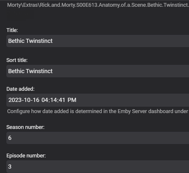

RanmaCanada 503 Posted November 30, 2023 Author Posted November 30, 2023 @LukeAfter I split them apart in Emby and physicaly moved them to the extras folder I told the server to replace all metadata for the files in this show. The picture above is from Season 6, showing that the "specials" or "extras" are still being thought as being the episode that they are the extras for. They also show up in the specials folder. They are named as in my previous post Rick.and.Morty.S06E03.Bethic.Twinstinct Rick.and.Morty.S00E613.Anatomy.of.a.Scene.Bethic.Twinstinct Rick.and.Morty.S00E623.Inside.Bethic.Twinstinct So there is absolutely no reason for the files that are S00 to be in Season 06. The naming convention is 100% correct as S00 should put them in the specials folder, not the season folder. @rbjtech, yes it appears the metadata is being populated incorrectly even after I've told the server to replace all metadata. It appears that once again I need to go in and manually edit every single file to resolve this problem that constantly happens. I could also try deleting all the .nfo files as it seems Emby just doesn't have a clue on how to deal with this problem.
pwhodges 2039 Posted November 30, 2023 Posted November 30, 2023 You have the season and episode numbers in the metadata, which determine where it appears. Just blank those entries and the problem should resolve. Paul
rbjtech 5345 Posted November 30, 2023 Posted November 30, 2023 Just now, pwhodges said: You have the season and episode numbers in the metadata, which determine where it appears. Just blank those entries and the problem should resolve. Paul I think the issue Paul is the OP didn't put them there, emby did - so the question is why ...
pwhodges 2039 Posted November 30, 2023 Posted November 30, 2023 Right - well it's clear that it shouldn't from the given names, I agree... Paul

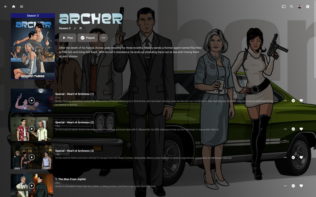

pwhodges 2039 Posted December 1, 2023 Posted December 1, 2023 Actually, later today I had the exact same thing happen to me with some specials. The problem is that TVDB gives them positions in the season corresponding to when they were published (not broadcast - the series was not for TV), even though they do not form part of the series itself, so Emby merges them with the season. But also Emby puts them in two places! - they show up in the Specials folder, but also in the Season 1 folder. What I want back is the option not to put specials into the sequence of normal episodes. We used to have that option and they've taken it away at the same time as making it more necessary. Paul 1

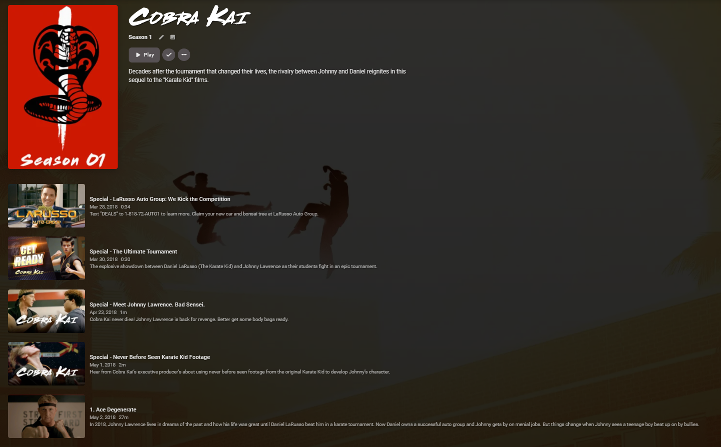

Neminem 1630 Posted December 1, 2023 Posted December 1, 2023 @pwhodgesI have seen this to. And this is only 1 example, I'm seeing it all over my Serie folder in 4.8. This is with the series Cobra Kai fore some reason Emby decided that this Teaser should a speciel named The Karate Kid. /Mediaunraid/Series/Cobra Kai (2018) [TvdbId=332858]/other/The Karate Kid is all grown up (Teaser).mkv Cobra Kai - The Karate Kid - TheTVDB.com which is the movie. The file is placed under /Mediaunraid/Series/Cobra Kai (2018) [TvdbId=332858]/other/ And in 4.7 we have the option to turn this off. When 4.8 goes stabil, I will have to fix 1000's of extras, like this. And that will be a manuel fix
Neminem 1630 Posted December 1, 2023 Posted December 1, 2023 (edited) But I would still want this added back. 6 hours ago, pwhodges said: option not to put specials into the sequence of normal episodes. This are identified right. But i do not want them showing in seasons. So again its going to be a manuel edit it all by hand This file is located in /Mediaunraid/Series/Cobra Kai (2018) [TvdbId=332858]/featurettes/ And are not in season 1 folder. Edited December 1, 2023 by jaycedk
Neminem 1630 Posted December 1, 2023 Posted December 1, 2023 Here is another that's misplaced /Mediaunraid/Series/Cobra Kai (2018) [TvdbId=332858]/other/No mercy for Miguel (Teaser).mkv Its identified as And again its not in my season folder. But in my others folder I know that it's has parts on the episode name, as the one its getting identified with, but it has no s02e10 in the name. Can we please have back, the option to not include extras in seasons.
