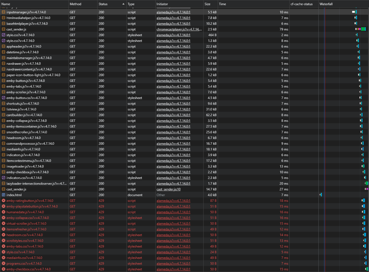

Chrome reports following errors:
Firefox behaves a bit weird. Wont load the page by default, but somehow loads when developer window is opened:

I have read the HOW TO: Cloudflare settings and have everything set up as in the first post except the Page rules. I have replaced this settings with the Cache rules, which seems to be working since I dont see any values for cf-cache-status:
When trying to open those scripts in new window they get loaded:

Ok, solved it. It was Rate limiting of Traefik. Increased burst from 50 req/s to 100 and works now.
    ratelimit:
      rateLimit:
        average: 150
        burst: 100
