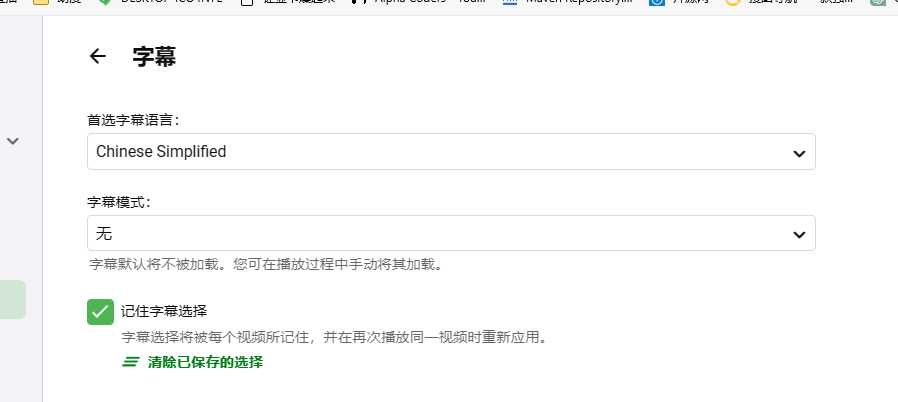

GrimReaper 4926 Posted November 28, 2023 Posted November 28, 2023 2 minutes ago, Yra_pril said: 请问我该怎么设置,才能不选择图形字幕呢。 In your client Settings>Subtitles, set "Subtitle mode" to no subtiles. Or select "Subtitles: Off" before playing that item in item detail screen. Alternatively, obtain external text-based subs either via Emby or by some other means (like directly from providers website), OpenSubtitles is a good place to start. https://emby.media/support/articles/Subtitles.html https://emby.media/support/articles/Open-Subtitles.html 1

Yra_pril 2 Posted November 28, 2023 Author Posted November 28, 2023 4 minutes ago, GrimReaper said: Nope, you did not turn them off. 但我已经在字幕中选择了无字幕啊 还需要在其他地方进行设置吗
GrimReaper 4926 Posted November 28, 2023 Posted November 28, 2023 4 minutes ago, Yra_pril said: 但我已经在字幕中选择了无字幕啊 还需要在其他地方进行设置吗 That applies to any unplayed item, going forward. For any already played item, selection is remembered, you need to either: a) Click green-colored "Clear saved track selection" on that screen you posted screenshot of or b) 17 minutes ago, GrimReaper said: select "Subtitles: Off" before playing that item in item detail screen. 1
Yra_pril 2 Posted November 28, 2023 Author Posted November 28, 2023 2 minutes ago, GrimReaper said: That applies to any unplayed item, going forward. For any already played item, selection is remembered, you need to either: a) Click green-colored "Clear saved track selection" on that screen you posted screenshot of or b) 选择清除已保存的选择之后可以了 感谢您的帮助 但我有些问题请请教一下 请问为什么会出现这种情况呢 是因为显卡的解码能力不够吗
