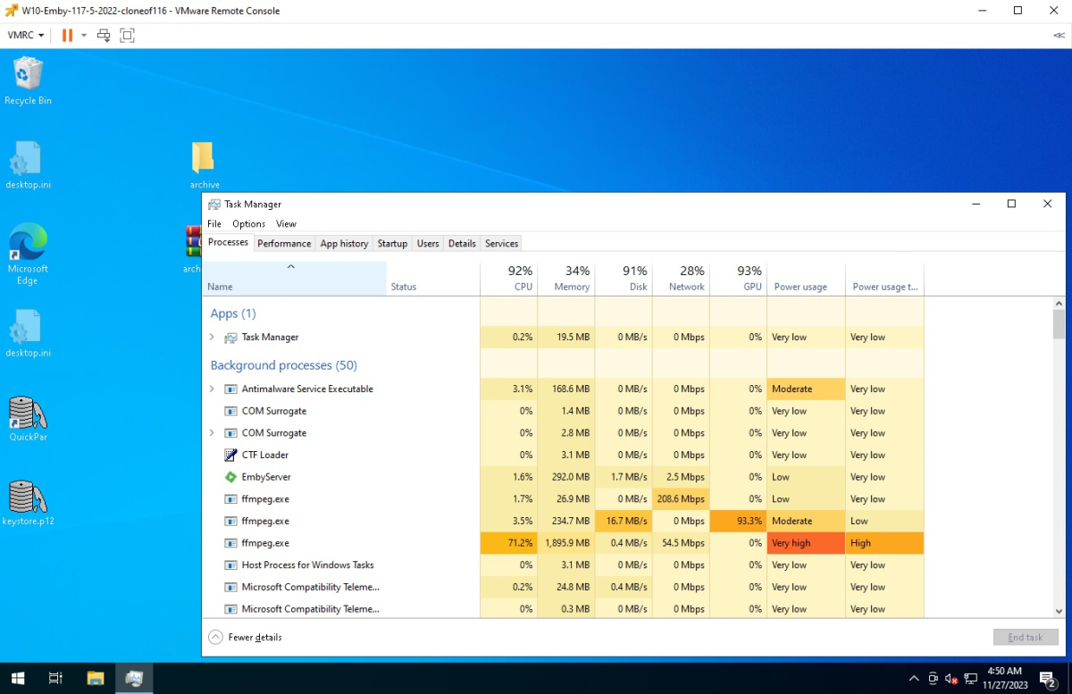

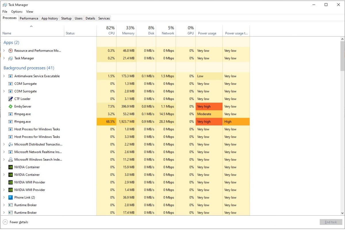

cul8rmom1 5 Posted November 27, 2023 Posted November 27, 2023 I am about to test it but I have had similar issues. I am running ESX 6.7 with PCI passthru mode on a nvidia quadro M2000. I have 2 servers with multiple M2000 and P620 quadro cards. I have snapshots of each VM so if something stops working after an update or windows update I can test it to see if that is the cause. Another question: There are multiple ffmpeg sessions running but only one uses the GPU. I believe the others are doing stuff for skip intro and all that. Is there a way to make them use the gpu as well? First one is with a 4k movie running in a browser, second one is without.
