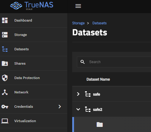

SPowe 0 Posted November 26, 2023 Posted November 26, 2023 Starting emby with checkmark for use the NAS Host Network: While adding a new library from a SMB share i had always the Problem, that i got an empty SMB selection after scanning for the network folder: After alot of tries I managed to get the smb shares at least listed in my emby server app. At first i had to enable SMB1 support: Then i had to enable guest access for the Samba share: And after that i had to enable anonymous smb access for nobody (recursively for every share): To store the media files i have to give write access for user nobody (recursively) to my smb share. That leaves some questions: Why do i have to enable SMB1 support ? Isn`t it obsolete? If it is disabled i cant see any (!) samba share in my home network - also not from other servers with other IPs. Why ist there no option in Emby Server to enter credentials for the shares ? Or am i too blind to see them? Is this the way, how it shall be used or am i missing something? i dont like to expose my media files with write access... cheers SP
