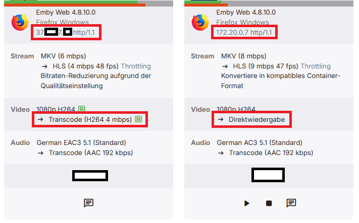

godfuture 5 Posted December 15, 2024 Author Posted December 15, 2024 (edited) On 11/20/2023 at 2:01 AM, Luke said: Not necessary on the local network. Auto on the local network always means max value. So this means that most likely, one of the following is true: It's not actually set to auto even though he thought it was Something about his network setup and/or network settings is preventing emby server from being able to distinguish a local connection vs a remote one. I justed tested it, and @Lukewas right. Internal connections are played with max bitrate. But low bitrate on external auto is also the case: Is the default bitrate configurable on server? Edited December 15, 2024 by godfuture
Luke 42183 Posted December 15, 2024 Posted December 15, 2024 1 hour ago, godfuture said: I justed tested it, and @Lukewas right. Internal connections are played with max bitrate. But low bitrate on external auto is also the case: Is the default bitrate configurable on server? Hi, no, but it is in process of being increased. 1
