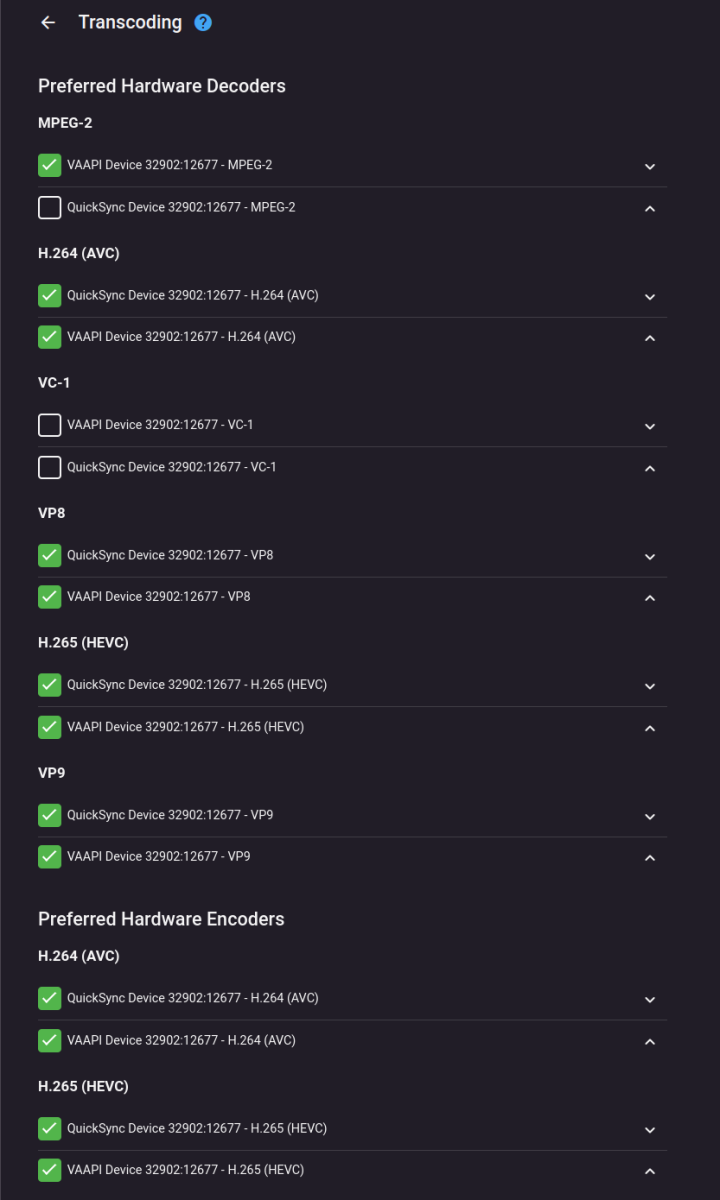

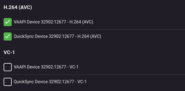

tattler 31 Posted November 17, 2023 Posted November 17, 2023 Hi I stumbled upon this thread because I am having the same issue. VC-1 video hardware decoded with VAAPI produces some artifacts (pixelated) in some action scenes and if I disabled VC-1 hw decoding the video is smooth (hw encoding is turned on). If I moved QuickSync up in the Transcoding section to use it instead of VAAPI the transcoding does not work. Video will not play. I have DS-920+ with Celeron J4125 and QuickSync should work because I can select it in Emby: Is there any setting to fix this? I am running Emby server in a docker container with version 4.7.14.0. I have quite some VC-1 movies lying around and would like to use hw decoding for VC-1 video as well (less impact on CPU). I wondered if the hw implementation of VC-1 decoding will improve in the new Emby server version 4.8? Thanks!

tattler 31 Posted November 19, 2023 Author Posted November 19, 2023 Hi @LukeI have attached the server logs here. I turned on QuickSync ONLY for hw decoding of VC-1 video and it does not play. Spinning wheel only during playback with a blank screen. hardware_detection-63835988774.txt ffmpeg-transcode-3b0a1ff0-15df-4fe0-bc6c-ac02339ccf71_1.txt ffmpeg-transcode-00458c40-ef01-460f-8926-06e09f984fab_1.txt ffmpeg-transcode-a65f8ae4-3137-4d27-800d-dd93890b96e3_1.txt embyserver (1).txt

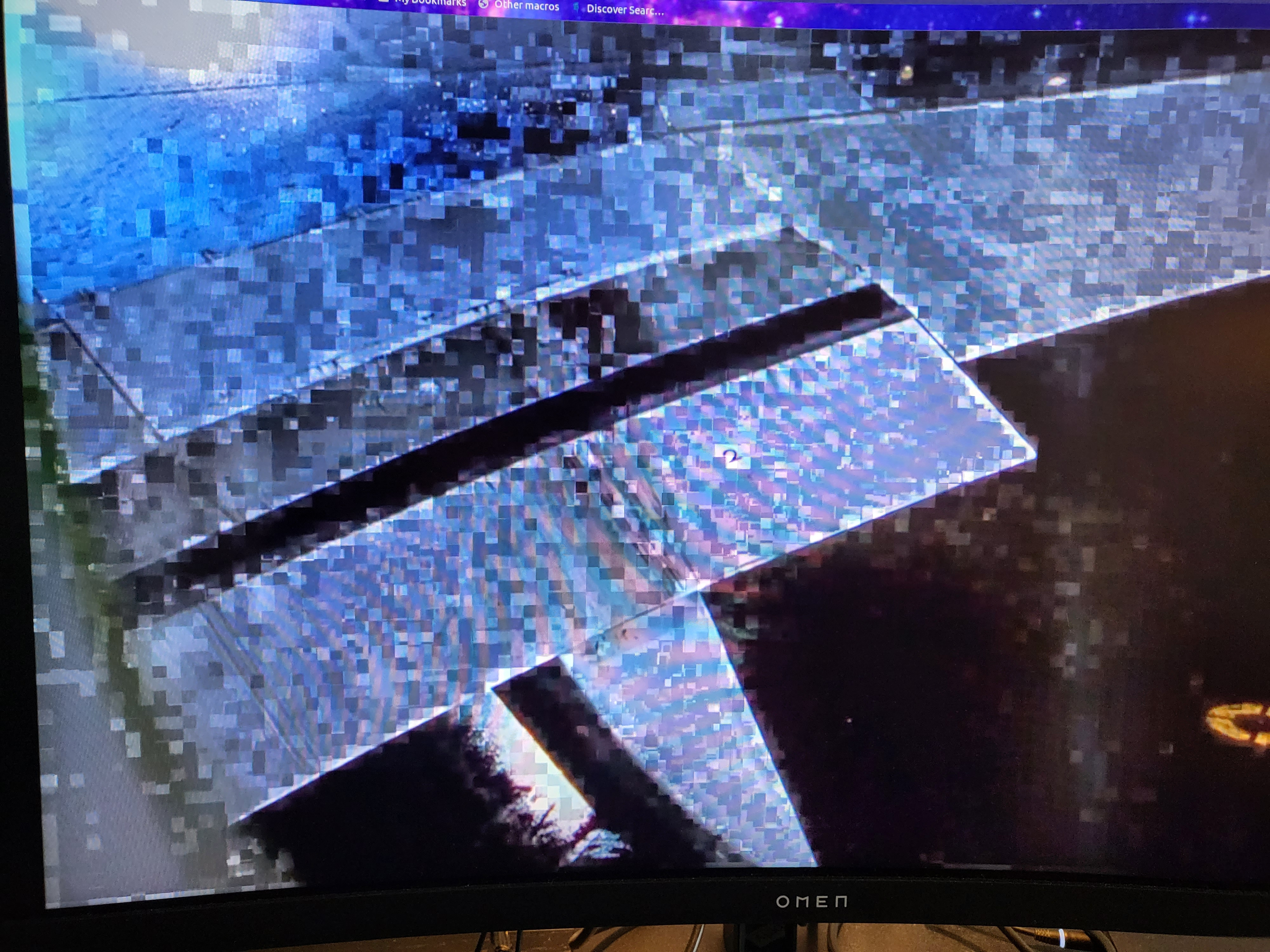

tattler 31 Posted November 19, 2023 Author Posted November 19, 2023 (edited) And this one I have VAAPI hw decoding turned on and at around 11:46 there is artifact. Please see screenshot and the logs. Video is VC-1. If you need more info pls let me know. thanks in advance! ffmpeg-transcode-a295802c-778a-45ce-b012-ba5478006fe8_1.txt ffmpeg-transcode-956ca751-cbee-4ac2-9e4e-995bd5ca501e_1.txt ffmpeg-transcode-9e18acf1-61fc-4c06-bc96-dce1df5203ba_1.txt ffmpeg-transcode-903f1260-41ef-4c6a-a57f-426f0dcd80f5_1.txt ffmpeg-transcode-353db7d1-ca45-4ea2-b575-cd28e115cee5_1.txt embyserver.txt Edited November 19, 2023 by tattler

tattler 31 Posted November 24, 2023 Author Posted November 24, 2023 (edited) On 22/11/2023 at 19:20, Luke said: OK. For the latest intel hardware you may want to try the 4.8 beta server. Thanks @Luke. I don't have the latest Intel hardware, just a Synology DS-920+ NAS. I did an extensive test today with the combi VAAPI/QuickSync as encoders/decoders. Is it technically true I cannot mix the different drivers for both encoders and decoders? What I mean: choose VAAPI as X264 decoder and QuickSync as encoder. They do not play well together. After testing some movie files I have now settled on the following settings: Ignore MPEG2, I don't use it. I give QuickSync the highest priority and keep VAAPI checked for the fallback if QuickSync somehow fails to decode/encode. With this transcoding setting, QuickSync works as expected and stable. If I mixmatch them it is unstable and Emby will fall back to sw transcoding, which is not what I want. I am actually very curious how QuickSync would perform in the new beta. Since I run Emby as a container, I can easily do it by replacing the tag latest with beta. Still.... I don't know how stable it is at the moment. Maybe I just wait for the stable release..... if it doesn't take too long Edited November 24, 2023 by tattler
Luke 42245 Posted November 24, 2023 Posted November 24, 2023 Quote Is it technically true I cannot mix the different drivers for both encoders and decoders? Hi, you might be able to get away with it in certain scenarios but I wouldn't say that we recommend it. 1
