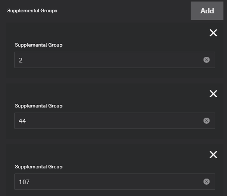

fyutins 4 Posted November 8, 2023 Posted November 8, 2023 Hey I'm looking for help trying to use hardware transcoding on TrueNAS-SCALE-23.10.0.1. I am using emby (4.7.14.0) from Truecharts (15.0.12) on a QNAP-TS464. I add theses users to GIDLIST : and selected my GPU : At this point Emby recognize my hardware but it fails when trying to transcode any file. Is there anything I missed or is it even possible to make it work with Truenas Scale ? For information HW transcoding was working with Truenas Core Thanks for your time, ffmpeg-transcode-8fad2612-b087-4cd9-a148-cc3605c5fa83_1.txt hardware_detection-63834964539.txt
fyutins 4 Posted November 15, 2023 Author Posted November 15, 2023 Hey I'm looking for help trying to use hardware transcoding on TrueNAS-SCALE-23.10.0.1. I am using emby (4.7.14.0) from Truecharts (15.0.12) on a QNAP-TS464. I add theses users to GIDLIST : and selected my GPU : At this point Emby recognize my hardware but it fails when trying to transcode any file. Is there anything I missed or is it even possible to make it work with Truenas Scale ? For information HW transcoding was working with Truenas Core Thanks for your time, hardware_detection-63834964539(1).txt ffmpeg-transcode-8fad2612-b087-4cd9-a148-cc3605c5fa83_1(1).txt
