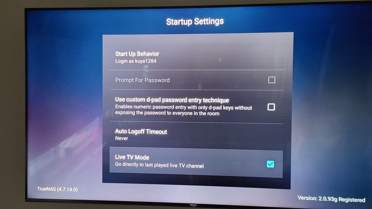

kuya1284 3 Posted November 12, 2023 Posted November 12, 2023 (edited) I'm experiencing an odd behavior with my Nvidia Shield and MiBox devices when launching the app. While having the Live TV Mode setting enabled and the Default Tab set to Guide, as soon as I launch the app, instead of the Guide loading, Channels loads instead. As soon as I highlight the Guide nav button, without even clicking the OK button on my remote, the guide loads immediately as well as the channel I was previously watching. This typically happens when The Emby app goes to sleep I watch use another app for a while, then later launch Emby I turn on my device and launch Emby Attached is a short video demonstrating this behavior. Is this a bug or do I just have something misconfigured? Should I send my logs? Thanks in advance. 20231112_083912.mp4 Edited November 12, 2023 by kuya1284 typo

kuya1284 3 Posted November 13, 2023 Author Posted November 13, 2023 (edited) 2 hours ago, ebr said: Hi. The app is already running in the background on the device and is just being brought back to the front. But the app doesn't start up with Guide selected nor with the last channel that was being watched. Isn't that the intended behavior of Live TV Mode? Or am I missing something? EDIT: I neglected to mention that the same behavior happens when I force close the app and relaunch it. Edited November 13, 2023 by kuya1284
ebr 16337 Posted November 13, 2023 Posted November 13, 2023 From your video, the app was already running and sitting on that channels page as it simply appeared in that state. There was no loading spinner, etc. So, the app wasn't "starting" at all in this case. I would have to go back and do some testing to see if anything in this area has changed recently as I don't think that option is used by many people at all. I know I haven't tested it in a long time.
kuya1284 3 Posted November 13, 2023 Author Posted November 13, 2023 54 minutes ago, ebr said: From your video, the app was already running and sitting on that channels page as it simply appeared in that state. There was no loading spinner, etc. So, the app wasn't "starting" at all in this case. I would have to go back and do some testing to see if anything in this area has changed recently as I don't think that option is used by many people at all. I know I haven't tested it in a long time. Here's a new video showing what happens when I launch the app after force-closing it. Thanks for looking into it. 20231113_142252.mp4
