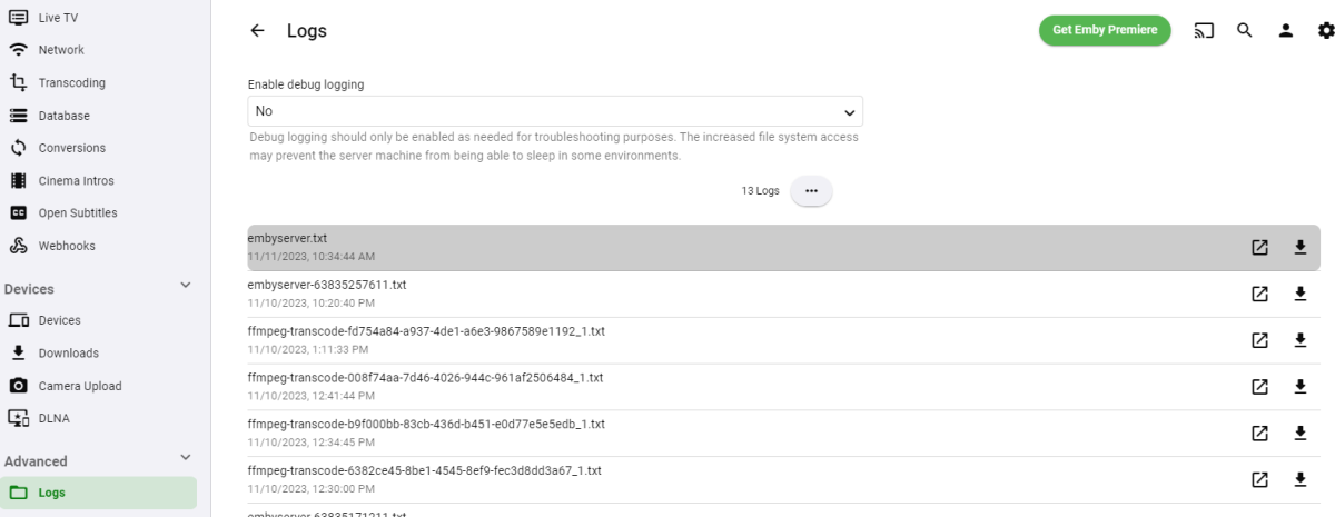

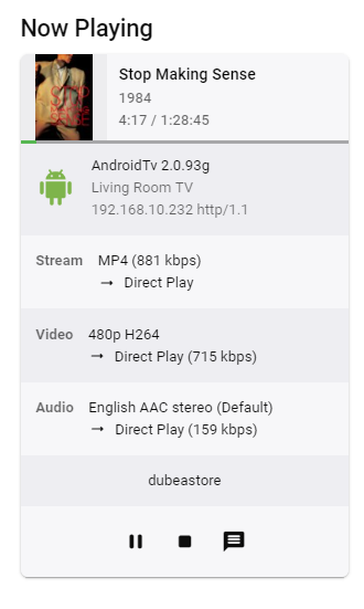

doobs 2 Posted November 11, 2023 Author Posted November 11, 2023 (edited) Playing through the Emby app on the TV. Dashboard screen grab Accessing the logs through the EMBY web interface: Most recent log is attached. Thanks for any guidance you can provide. chris embyserver.txt Edited November 11, 2023 by doobs

pwhodges 2023 Posted November 11, 2023 Posted November 11, 2023 (edited) You're playing a 480p video directly to a 4k screen, and it seems no interpolation is being applied in the upscaling - hence the nice sharp rendering of the original pixels! I don't know whether either the Shield or your TV would be expected to interpolate; it might be worth checking the settings, maybe for words like smoothing or sharpening. As far as I know the Emby client doesn't do upscaling. EDIT: I read that there is a setting in that TV called "Reality Creation" (what?) that can improve the upscaling of low resolution video. Paul Edited November 11, 2023 by pwhodges
Luke 42185 Posted November 11, 2023 Posted November 11, 2023 Yea he's right. This is direct playing, meaning the device is playing the original file as-is without any processing from Emby. I'm guessing this is only an issue with lower resolution content?
ebr 16307 Posted November 12, 2023 Posted November 12, 2023 Hi. Not only 480p but only 800Kb/s bitrate. It is simply a very low-quality video that your new TV is now exposing to you.
