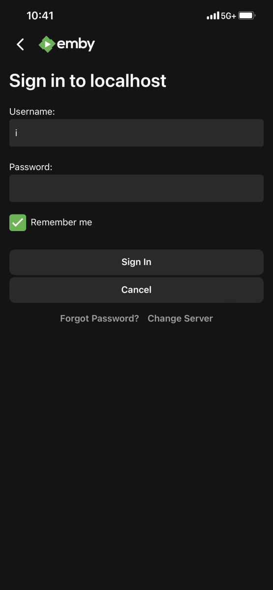

iiiJoe 62 Posted November 9, 2023 Posted November 9, 2023 Hello to all. I’m able to connect with Emby on my IPad and IPhone on my local network with no issues. However, when I try to connect remotely I’m getting this screen… I’ve tried my username and password but I just get an error of invalid username or password. What am I doing wrong? Thanks in advance everyone

Luke 42288 Posted November 10, 2023 Posted November 10, 2023 54 minutes ago, iiiJoe said: Trying to connect with Emby connect on the Emby app on iphone. Works fine on LAN. No joy on WAN. Port forwarding is set up. Thoughts.... The above login screen is not the Emby Connect login screen. That is the login screen for your locally managed users, so the username and password that you enter should come from there.
iiiJoe 62 Posted November 10, 2023 Author Posted November 10, 2023 Makes sense. So, I've reset the password for the user and I'm still getting the same error message: invalid username or password. What step am I missing?
Luke 42288 Posted November 10, 2023 Posted November 10, 2023 4 minutes ago, iiiJoe said: Makes sense. So, I've reset the password for the user and I'm still getting the same error message: invalid username or password. What step am I missing? Where did you reset the password?
Luke 42288 Posted November 10, 2023 Posted November 10, 2023 And then what did you enter into the app when trying to sign in?

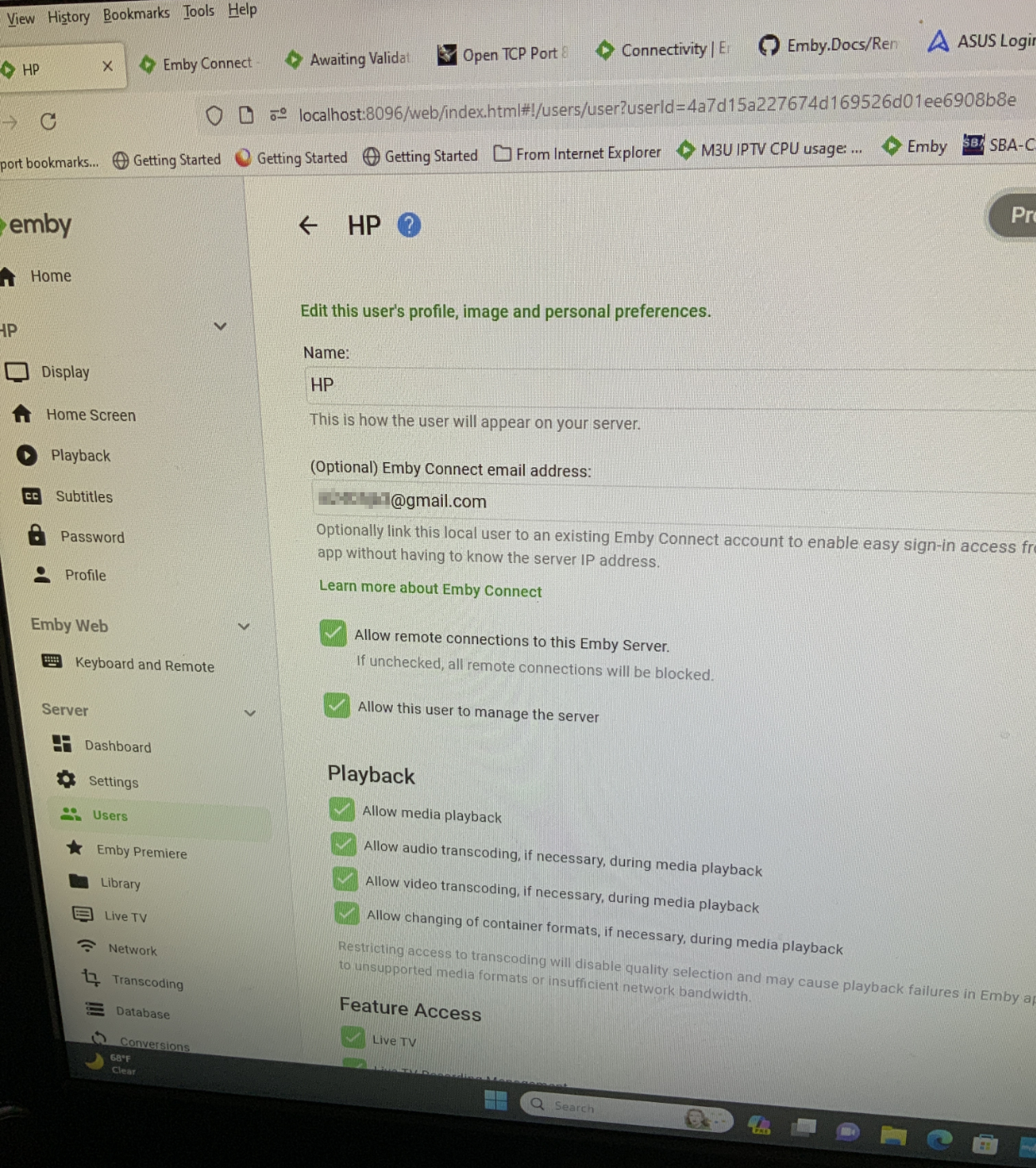

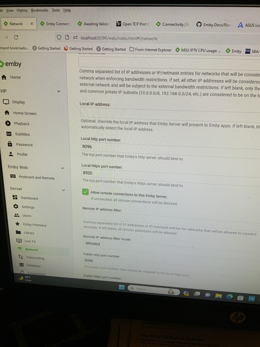

Luke 42288 Posted November 10, 2023 Posted November 10, 2023 Did you ensure that the users have been granted remote access? Is remote access enabled in server network settings?
iiiJoe 62 Posted November 10, 2023 Author Posted November 10, 2023 (edited) Edited November 13, 2023 by seanbuff email obfuscated

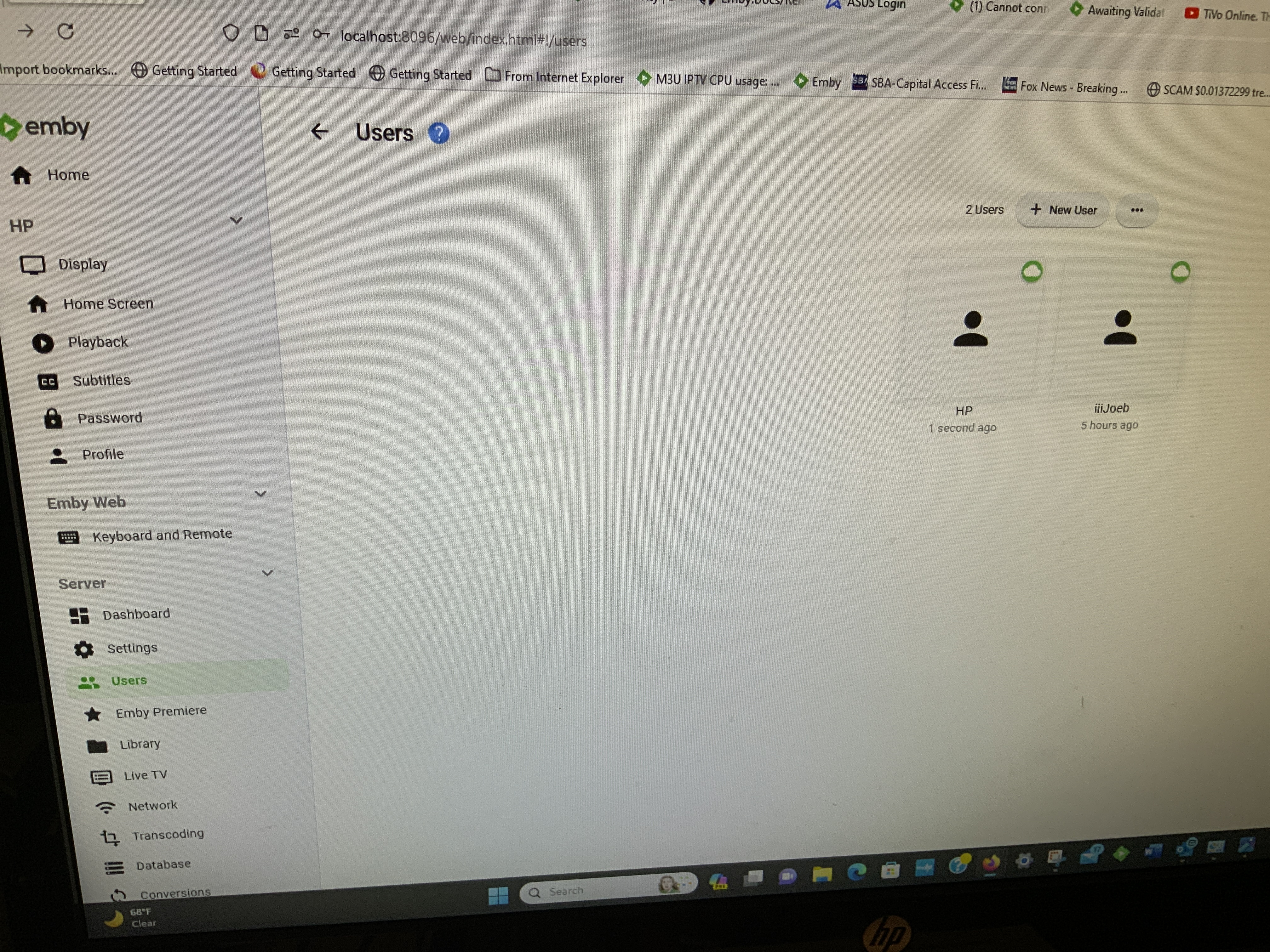

iiiJoe 62 Posted November 12, 2023 Author Posted November 12, 2023 Also, @Luke can you please delete the photo showing my server dashboard. Thank you
