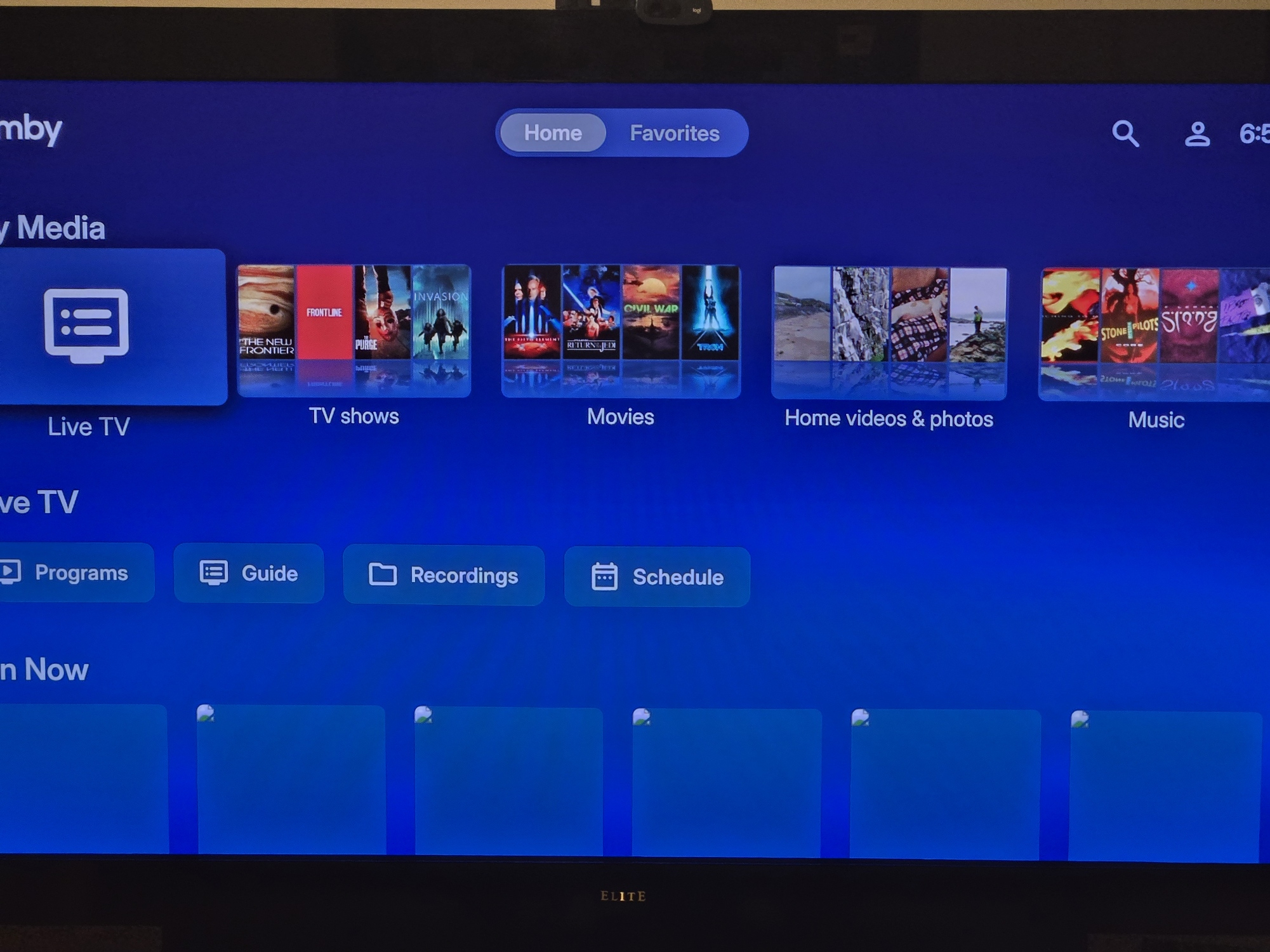

MarkTheNewf 4 Posted November 6, 2023 Posted November 6, 2023 This just started happening perhaps 2 days ago. Images for the 'On now' or other items that appear on demand. Rebooting did not fix. Uninstalled and reinstalled ET on the local machine but no joy. This issue shows up on any windows machine on the network. Would this be an Emby Server issue? Do I have to remove and reinstall? If so, is there any way of fixing this without loosing all my settings and such that I've developed over the past month or so of fiddling? FWIW, the server is recording TV as scheduled and local files (ex. music or movies) on either a local HD or my NAS are showing up ok. It seems like it has something to do with getting info online? Note that the computer does have internet access and we can freely surf online with it so there shouldn't be any sort of connectivity issue that I can see. Running server version 4.7.14.0 (shown as up-to-date) and Emby for windows 1.1.514.0.

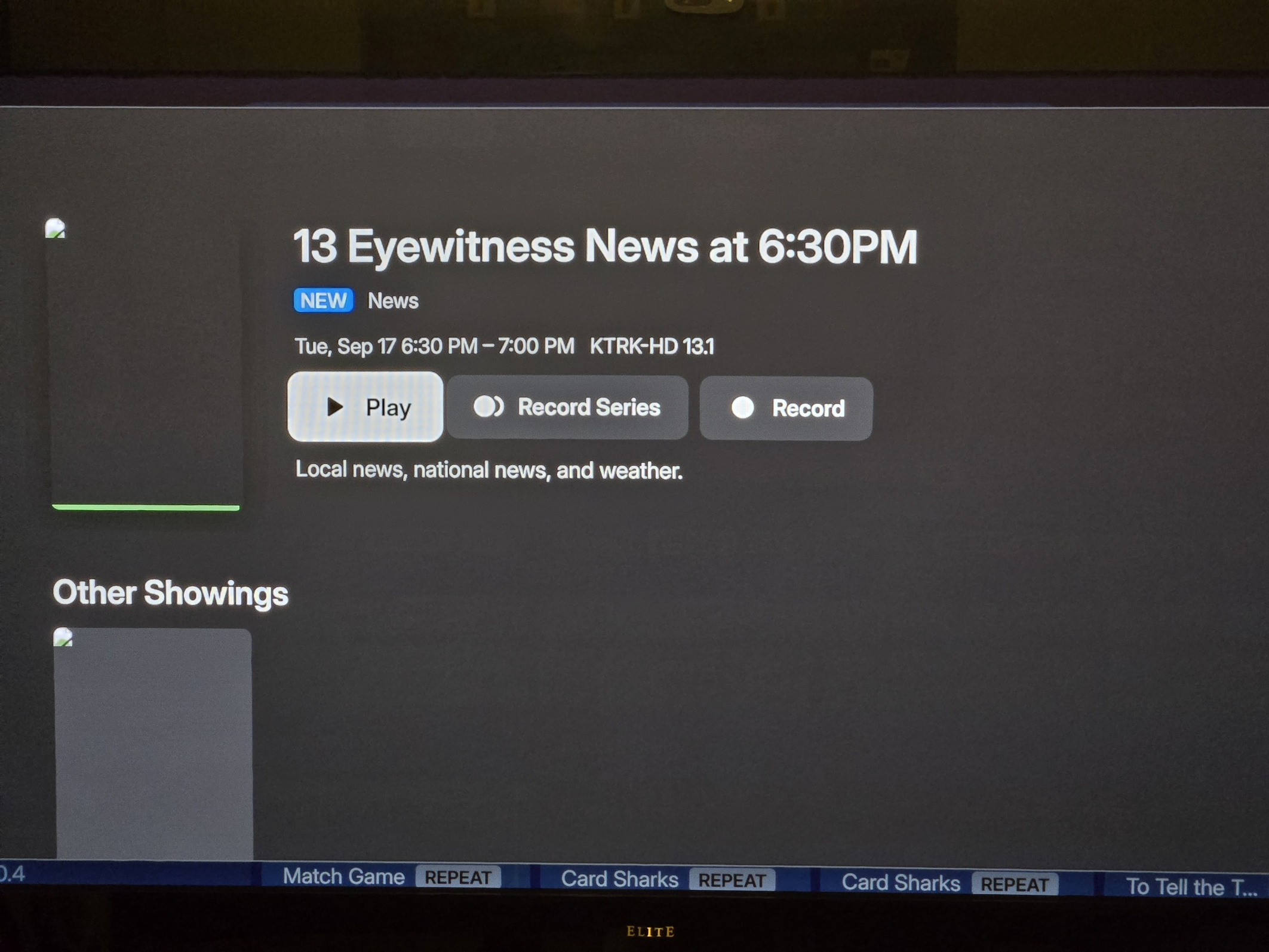

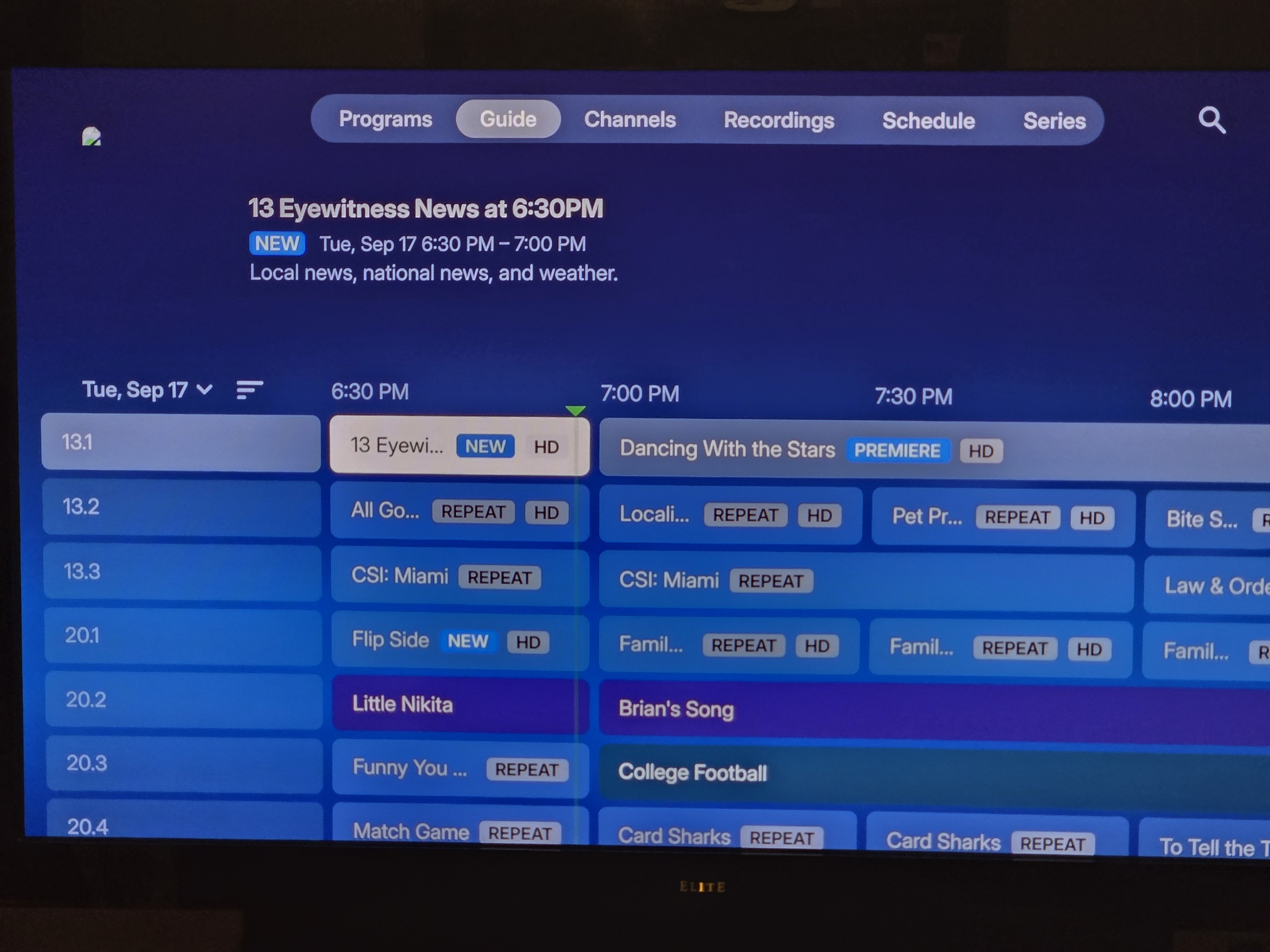

MarkTheNewf 4 Posted September 18, 2024 Author Posted September 18, 2024 (edited) This decided to start happening again. I've done nothing changed nothing. I have in the past rebooted, shutdown/restarted the entire network, uninstalled Emby & reinstalled, changed the OTA tuner. Nothing has fixed this friggin' thing. We have Emby primarily as a DVR to replace a Tivo and it is not fulfilling that requirement. It worked for about 3 months and then this foolishness started. There are other issues cropping up as well such as the plugins catalog just sitting there with a spinning circle rather than loading anything. I'm kinda out of ideas and patience and the wife is pi$$ed as well. When we go to the main screen or anything related to live TV, I have to wait about 20 seconds for it to NOT load images otherwise it'll lockup/bog down. 20 seconds might not seem long, but do it over, and over, and over, and over, and over, and over, and over, and over, and over, and over, and over, and over, and over, and over, and over, and over, and over, and over, and over, and over, and over, and over, and over, and over, and over, and over, and over, and over, and over, and over, and over, and over, and over, and over, and over, and over, and over, and over, and over, and over, and over, and over, and over, and over, and over, and over, and over, and over, and over, and over, and over, and over, and over, and over, and over, and over, and over, and over, and over, and over, and over, and over, and over, and over, and over, and over, and over, and over, and over, and over, and over, and over, and over, and over, and over, and over, and over, and over, and over, and over, and over, and over, and over, and over, and over, and over, and over, and over, and over, and over, and over, and over, and over, and over, and over, and over, and over, and over, and over, and over, and over, and over, and over, and over, and over, and over, and over, and over, and over, and over, and over, and over, and over, and over, and over, and over, and over, and over, and over, and over, and over, and over, and over, and over, and over, and over, and over, and over, and over, and over, and over, and over, and over, and over, and over, and over, and over, and over, and over, and over, and over, and over, and over, and over, and over, and over, and over, and over, and over, and over, and over, and over, and over, and over, and over, and over, and over, and over, and over, and over, and over, and over, and over, and over, and over, and over, and over, and over, and over, and over, and over, and over, and over, and over, and over, and over, and over, and over, and over, and over, and over, and over, and over, and over, and over, and over, and over, and over, and over, and over, and over, and over, and over.... Yeah. Images from recorded episodes is fine but anything that is dynamic (upcoming episodes, etc.) is missing with that broken link image. Am I the only one with this issue, and if not, how has it (ever) been resolved? Latest log file after reboot attached below in case there's something in it. embyserver.txt Edited September 18, 2024 by MarkTheNewf Added log file.
Luke 42234 Posted September 18, 2024 Posted September 18, 2024 Hi, are you having a network problem, or did you have a network problem? All outgoing communications to our guide data provider are failing. That's why you're not getting images. They are also failing to our admin server as well. Are you behind a VPN?
MarkTheNewf 4 Posted September 22, 2024 Author Posted September 22, 2024 Nope, no network issues or VPN. Sometimes the data and images show up and sometimes they don't. No idea why and I can't figure out why.
