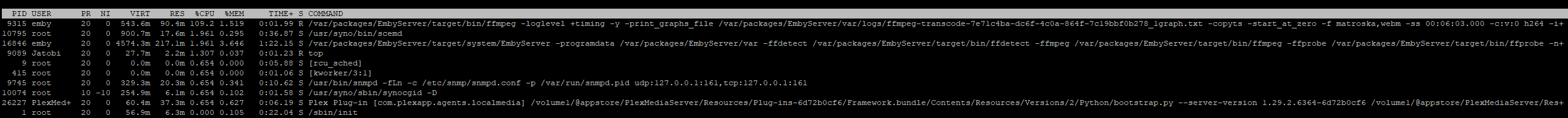

softworkz 5133 Posted November 3, 2023 Posted November 3, 2023 8 minutes ago, softworkz said: Also run 'top' or similar to confirm the user account under which emby server is running. Just for being sure.. 4 minutes ago, jatobi said: Something is saying screw what permissions you set. SELinux is such kind of beast...
jatobi 2 Posted November 3, 2023 Author Posted November 3, 2023 (edited) 10 minutes ago, softworkz said: Just for being sure.. SELinux is such kind of beast... I don''t see SELinux anywhere in here. I don't think it's part of the DSM7, at least not for the DS1515+ as I can get no settings through putty to even work to verify it's enabled or not. Also I'm rusty on using putty, and don't know how to utilize 'top' better...so might want to give me any variables to narrow it down. Edited November 3, 2023 by jatobi
