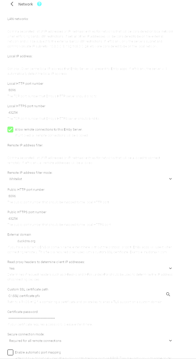

Lysaer 2 Posted November 1, 2023 Posted November 1, 2023 Hi all Having an issue getting ssl working. Have tried using the guide here But not having any luck, I can get access to my server fine without SSL. I am using duckdns, I have added the TXT line to the DNS and it verifies fine when creating the certificate. I have tried using different ports aside from 8920. I have forwarded ports on my router. I tried disabling the Windows Firewall. have attached screenshot of emby settings, sorry about quality for some reason HDR washes out my screenshots, but can see all necessary info Thank you in advance
