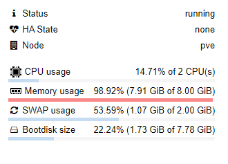

albertfa 0 Posted November 1, 2023 Posted November 1, 2023 Hi, I have emby running in a LXC container with 2 cores CPU, 8Gb RAM and 2 Gb Swap disk... and after some minutes runnig the service exites. The container still works but emby not. this is the response from container logs: 20:55 emby-server.service: Consumed 14min 15.345s CPU time. systemd 20:55 emby-server.service: Failed with result 'signal'. systemd 20:55 emby-server.service: Main process exited, code=killed, status=9/KILL systemd 20:10 Info App: All entry points have started Any idea? Thanks!

albertfa 0 Posted November 1, 2023 Author Posted November 1, 2023 Hi, thanks for the answers. I think OS kill the process because she puts memory to 98% for too long, see attached picture. But I can't find the reason I have attached server logs. hardware_detection-63834379838.txt embyserver-63834473316.txt
