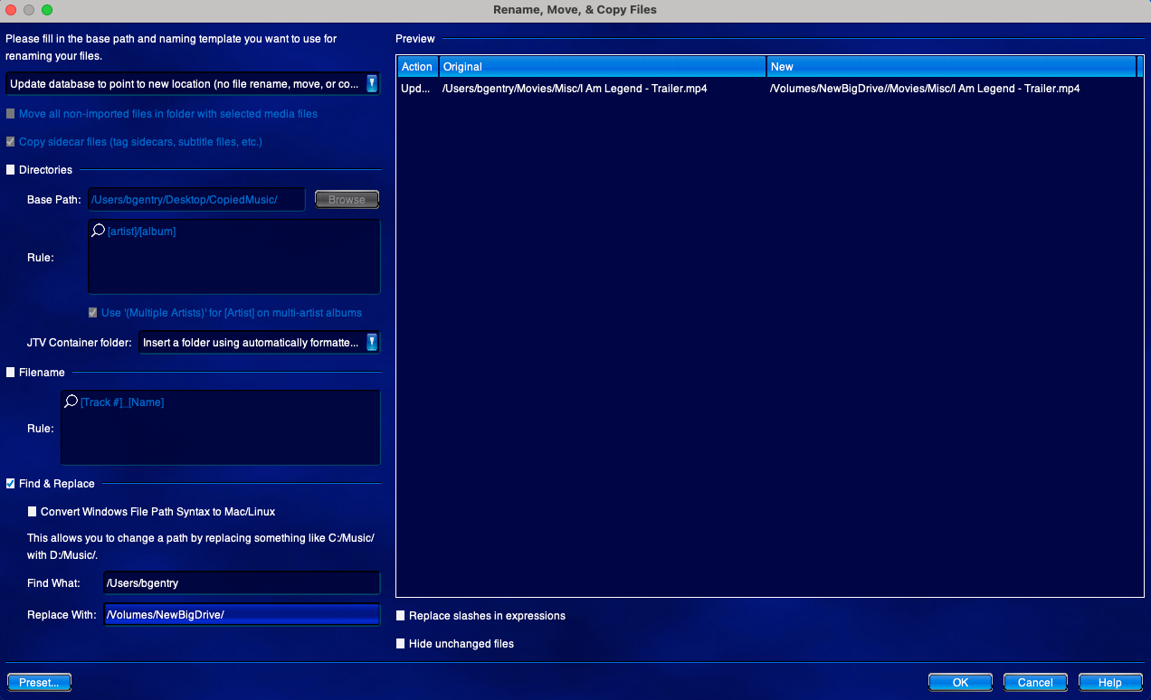

blgentry 51 Posted November 1, 2023 Posted November 1, 2023 "Good artists copy, great artists steal." You should take a look at the JRiver Rename, Move, and Copy Files tool. It's one of the most powerful features of JRiver MC. It allows you to do Renames, Copies, and Moves of your media. In the screen shot above notice that I am in "update database" mode. This just changes the internal database record for the location of the file. Also note that I am using "Find and Replace" to change part of the path from my User directory to an external drive (/Volumes/NewBigDrive). This works when you have already copied your media to a new place and you just want to tell the program to look for the media in that new location. You can easily use this to change drive letters, leading paths, etc. I have used this capability to move libraries between machines with different drive layouts. I've done this many times and it always works quite well. Of course this is made possible because JRiver MC can make a Database Backup as a ZIP file. I just move the ZIP file to the new computer and do a database restore from that ZIP file. This is a program function; I do not manually unzip or anything. The program does the work. Once I have the database restored to the new machine with different drives, the paths are wrong. So I use the tool pictured above to change the paths to the files. That's all there is to it: My entire collection is migrated. The database backup also contains all user settings and they can be (optionally) restored along with the media data. Emby should have similar features eventually. To really manage the life cycle of a media collection, one has to consider that hardware will change. Servers will be replaced. Drives will be filled and new drives will be added or substituted. Robust tools for doing operations like I have outlined here are essential for a mature media server that you will keep for a decade or more. I hope the Emby team will consider STEALING some of these great ideas and using them. Brian. 1 1

Loondawg 18 Posted November 1, 2023 Author Posted November 1, 2023 1 hour ago, blgentry said: You should take a look at the JRiver Rename, Move, and Copy Files tool..... Just my two cents... This looks really cool. But I would hate to see the awesome delay the more necessary. That is so much of a bigger scope than what I need. I'm just looking for something that says anything that was in a library pointing to "X:\TV\" should now point to "Z:\Recorded\TV Shows\". Just a simple replace A for B would solve my immediate needs and I suspect would be something a lot of people could use. No fancy interface needed. A simple command line would do. You know, shut the server down, run this command, fire the server back up when it completes. If it could be done under the normal dashboard, all the better but I really don't even care about that. I just need to be able to get this routine file move done. But once there was a tool like that in place, then I would be all on board for what you suggested.
