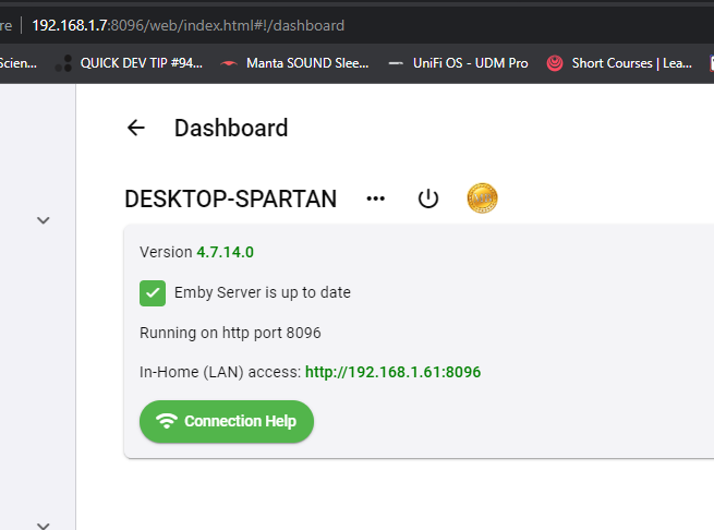

Solution ebr 16335 Posted October 31, 2023 Solution Posted October 31, 2023 Hi. Make sure the addresses shown on the Emby server dashboard are correct. If they are, try logging out (actually choose "sign out") from the app and then logging back in. 1
maxnb 1 Posted October 31, 2023 Author Posted October 31, 2023 how does this look? workstation where Emby Server I access it here: 192.168.1.7:8096, while dashboard mentions: http://192.168.1.61:8096/ is that Ok? I have no idea where .61 comes from, so I took it that Emby Server reserved this address? Logging out on Emby Client app did not help, logging out on server side also doesnt change Client behaviour. Please assist further.
maxnb 1 Posted October 31, 2023 Author Posted October 31, 2023 (edited) I solved it, I had to override the IP in network section and I gave workstation static IP. I guess the .61 could have come from before, when the machine had that dynamic IP address given to it by network device? And Emby remembered it, and when server got new address Emby would still use old one? Edited October 31, 2023 by maxnb
Luke 42243 Posted October 31, 2023 Posted October 31, 2023 Emby server should normally detect when the local lan address changes. See if you can set a static IP address for your router so that it never changes. Then you can remove the override you just added. The problem with overriding it is that now it’s your responsibility to keep it up to date if it changes. If you forget to do this then it’s going to lead to connection problems. 1

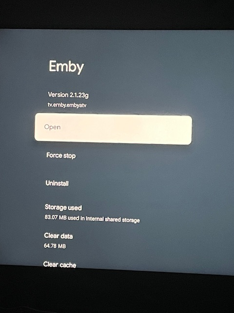

amichaux 0 Posted April 7, 2025 Posted April 7, 2025 (edited) I have precisely this issue. Emby works fine when loading through a computer's web browser. My brand new Sony (AndroidTV) worked fine for about a week, and I get this connection issue now. I was mucking around with the network... so it is plausible that the Emby server has some bad data cached. Restarting it a hundred times does not get it to flush out the bad data. So it's persistent on disk? Sometimes clearing the Android App disk cache solves the problem. Sometimes it doesn't. When clearing fails, I uninstall the Emby app, and reinstall, and then it works. That is, it works until I sign out of the account. Then I cannot load the app... it just spins. Both my server and TV have static IP addresses. I also turned off the TV's "MAC address spoofing", a feature that is presumably superfluous for a TV. This looks like a bug to me, and a long standing one at that. The Android App should obviously be able to load the log in screen without me uninstalling and reinstalling the app each time I want to use it. Edited April 7, 2025 by amichaux
Luke 42243 Posted April 7, 2025 Posted April 7, 2025 4 hours ago, amichaux said: I have precisely this issue. Emby works fine when loading through a computer's web browser. My brand new Sony (AndroidTV) worked fine for about a week, and I get this connection issue now. I was mucking around with the network... so it is plausible that the Emby server has some bad data cached. Restarting it a hundred times does not get it to flush out the bad data. So it's persistent on disk? Sometimes clearing the Android App disk cache solves the problem. Sometimes it doesn't. When clearing fails, I uninstall the Emby app, and reinstall, and then it works. That is, it works until I sign out of the account. Then I cannot load the app... it just spins. Both my server and TV have static IP addresses. I also turned off the TV's "MAC address spoofing", a feature that is presumably superfluous for a TV. This looks like a bug to me, and a long standing one at that. The Android App should obviously be able to load the log in screen without me uninstalling and reinstalling the app each time I want to use it. hi @amichauxwhat version number of the app do you have?
amichaux 0 Posted April 7, 2025 Posted April 7, 2025 (edited) Hi, I'm running: Version 4.8.1.0 Emby Server 4.8.11.0 is Available for hermes On Debian Trixie. This is dpkg: ~ > dpkg --list | grep emby ii emby-server 4.8.1.0 amd 64 Emby Server is a personal media server with apps on just about every device. Edited April 7, 2025 by amichaux Adding dpkg info

amichaux 0 Posted April 8, 2025 Posted April 8, 2025 Good morning, I'm using version 2.1.23g on a 2024 Sony K-42S30 (Bravia 3)
amichaux 0 Posted April 8, 2025 Posted April 8, 2025 Android TV OS version: 12 Security Patch Level: December 5 2024 TV OS Build: STT2.230811.001
ebr 16335 Posted April 8, 2025 Posted April 8, 2025 Hi. Can you try searching for our standard android app (Just "Emby" on Amazon and "Emby for Android on Google) on the same device's app store and see how that compares? Thanks.
amichaux 0 Posted April 9, 2025 Posted April 9, 2025 Good morning, that worked! Thank you. It was a little confusing to sort out, because the App with the logo "Emby for Android TV" was indeed the old version (2.1.23g). When I searched the store, I found two apps, and verified that they are indeed different versions (2.1.23g, and 3.4.36) Everything works with 3.4.36.

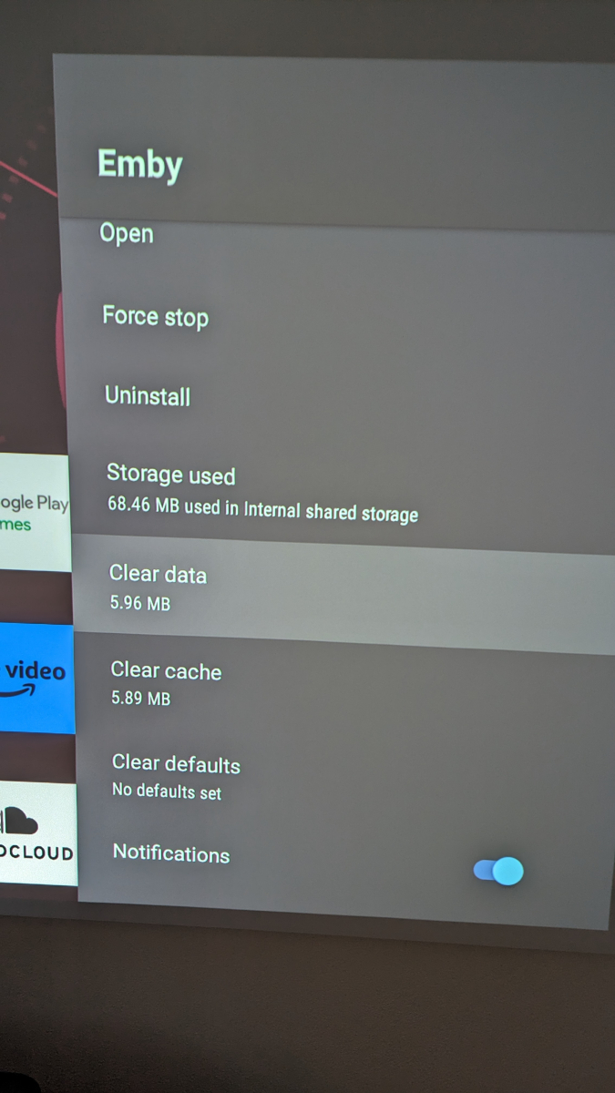

hbbs 8 Posted January 30 Posted January 30 (edited) I'm using version 2.1.32g of the Emby For Android TV client on a Xiaomi TV Stick 4K (Also happens with Emby for Android TV from Fire TV as well) How can I definitely fix this. I'm tired of cleaning caches every time I want to use Emby. PS: this issue doesn't happen when I open Emby for Android TV from my NSTV which also is running this Emby Server. Edited January 30 by hbbs
ebr 16335 Posted January 30 Posted January 30 32 minutes ago, hbbs said: I'm using version 2.1.32g of the Emby For Android TV client on a Xiaomi TV Stick 4K (Also happens with Emby for Android TV from Fire TV as well) How can I definitely fix this. I'm tired of cleaning caches every time I want to use Emby. PS: this issue doesn't happen when I open Emby for Android TV from my NSTV which also is running this Emby Server. Hi. Exactly what issue are you having?
hbbs 8 Posted January 30 Posted January 30 (edited) 50 minutes ago, ebr said: Hi. Exactly what issue are you having? I cannot sign in to emby from any device using the Android TV client. It stalls on the loading screen.The only workaround to sign in to emby from an Android TV client is to stop the app and clear the data. After that, I have to log in manually. This issue has been going on for a while. I thought that with the new server release this week, it would be gone, but that is not the case. I still cannot log in. I'm running the latest Emby for Android TV Client (Beta) version 2.1.32g Server 4.10.0.1 (Nvidia Shield TV) This issue doesn't show up if you open the same version of Emby for Android TV Client from the Nvidia Shield TV running the server. I've attached a video VID_20260130_144751368.mp4 Edited January 30 by hbbs Typo
ebr 16335 Posted January 30 Posted January 30 How long have you waited? Your video isn't long enough to cover the timeout period trying to reach your server.
