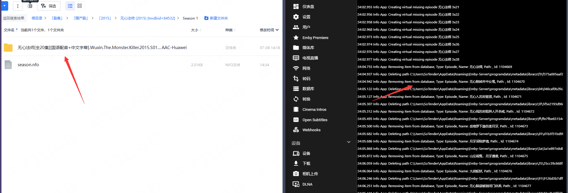

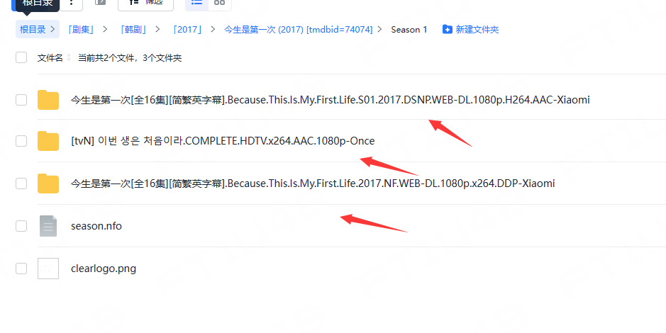

AnSniper 19 Posted October 30, 2023 Author Posted October 30, 2023 (edited) 9 hours ago, Luke said: HI there, let's look at a specific example: How to Report a Problem Thanks. Info App: Remo Info App: Removing item from database, Type: Episode, Name: 无心除掉井中女鬼, Path: , Id: 1104670ving item from database, Type: Episode, Name: 无心除 2023-10-30 14:34:02.977 Info App: Creating virtual missing episode 无心法师 3x28 2023-10-30 14:34:04.755 Info App: Removing item from database, Type: Episode, Name: 无心法师, Path: , Id: 1104669 2023-10-30 14:34:04.937 Info App: Deleting path C:\Users\SoTender\AppData\Roaming\Emby-Server\programdata\metadata\library\f3\f375a005aaf23c812a44e2c0b3a42c98 2023-10-30 14:34:04.942 Info App: Removing item from database, Type: Episode, Name: 无心除掉井中女鬼, Path: , Id: 1104670 2023-10-30 14:34:05.122 Info App: Deleting path C:\Users\SoTender\AppData\Roaming\Emby-Server\programdata\metadata\library\04\040caf0b2fe23ae188412b26f635be34 2023-10-30 14:34:05.127 Info App: Removing item from database, Type: Episode, Name: 无心入苏府驱邪, Path: , Id: 1104671 I tried to find the log of one of the episodes and found that when scanning for this episode, the path information of the episodes was deleted and then rebuilt? So do you need to upload season.nfo every time? Is this because I added an additional level of directory in Season 1? Because multiple versions have been saved, Sason 1 will have multiple directories to distinguish different versions, like this: Is it precisely due to the addition of this level of directory? Or is it because of the mounting software I am using (all my videos are on the online drive)? One of 2500 TV series.txt Edited October 30, 2023 by AnSniper
pwhodges 2039 Posted October 30, 2023 Posted October 30, 2023 3 hours ago, AnSniper said: Is this because I added an additional level of directory in Season 1? Because multiple versions have been saved, Season 1 will have multiple directories to distinguish different versions To enable Emby to handle multiple versions of episodes, the method is to put them in the same directory and give them the same name, but each having a different suffix (I put a dash first to make it clear). Alternatively, you could have the version separated at the series level and combine them from there. I don't know how you wish the different versions to appear, though, so I can't suggest full details. But what you are doing is not what Emby expects... Paul
AnSniper 19 Posted October 30, 2023 Author Posted October 30, 2023 2 minutes ago, pwhodges said: To enable Emby to handle multiple versions of episodes, the method is to put them in the same directory and give them the same name, but each having a different suffix (I put a dash first to make it clear). Alternatively, you could have the version separated at the series level and combine them from there. I don't know how you wish the different versions to appear, though, so I can't suggest full details. But what you are doing is not what Emby expects... Paul So is it precisely because of the addition of this level of directory that season.nfo is repeatedly uploaded?

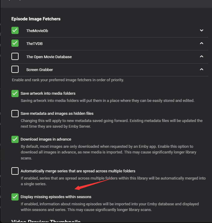

Luke 42287 Posted October 30, 2023 Posted October 30, 2023 Did you turn on the missing episodes feature for your library? Try turning that off if you did.
AnSniper 19 Posted October 30, 2023 Author Posted October 30, 2023 8 minutes ago, Luke said: Did you turn on the missing episodes feature for your library? Try turning that off if you did. Is it this option? I will turn it off and try again. I hope season.nfo will not upload repeatedly. Thank you for your reply! 1
