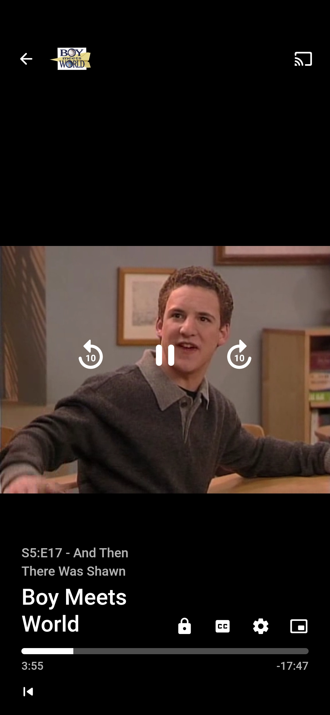

ITGuy1024 18 Posted October 28, 2023 Posted October 28, 2023 New issue - direct play on chromecast and my galaxy s23 shows a blank screen during direct playback. On my phone if I skip ahead it starts to play fine. On the chromecast skipping ahead fixes the video but audio stops working. It's only been an issue with certain episodes - I think the only difference is the audio type? Und AC3 Stereo?
