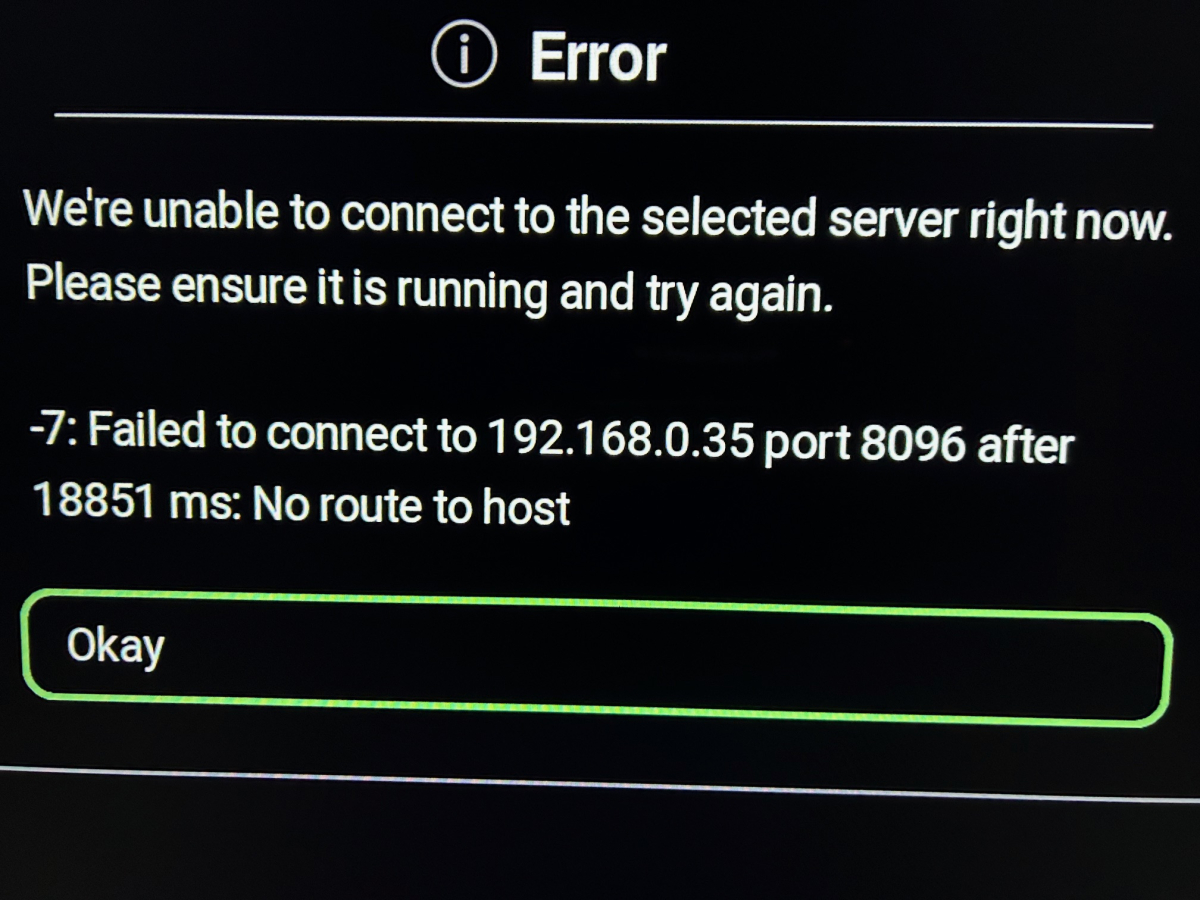

andylee73 1 Posted October 24, 2023 Author Posted October 24, 2023 Hi Thanks for quick response ! I entered the full URL but it did not work. My dashboard gave LAN as http://192.168.0.35 Just checked the wireless connection on the TV and it is working. The TV IP address is 192.168.0.13 Gateway 192.168.0.1 Not sure if that helps ? The error from my TV is attached
rbjtech 5335 Posted October 24, 2023 Posted October 24, 2023 Hmm strange - can you ping the TV from your emby server ? ie from a command prompt ping 192.168.0.13

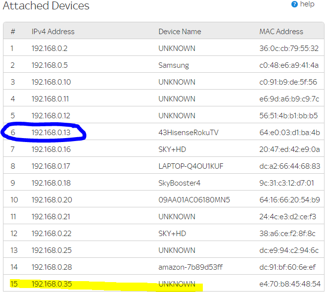

andylee73 1 Posted October 24, 2023 Author Posted October 24, 2023 Hi Sorry bit clueless... The TV does appear to be connected to the main router. I logged into Sky Router Admin and found the below. Blue highlight being the Hisense TV and Yellow being Emby i think.. I might be totally wrong. Not sure what to do.
rbjtech 5335 Posted October 24, 2023 Posted October 24, 2023 If 192.168.0.35 can ping other devices on your network, but not .13 - then I'm not really sure what to suggest next tbh. It's a single flat network - there really is nothing to go wrong ! If the TV is working for all other internet services, then it's clearly attached to the network ok.. but the fact you cannot ping it is odd. Probably worth removing the wireless connection from the TV and then re-adding it - although it's likely to just pick up the same IP again. Is this wireless or wired ?
