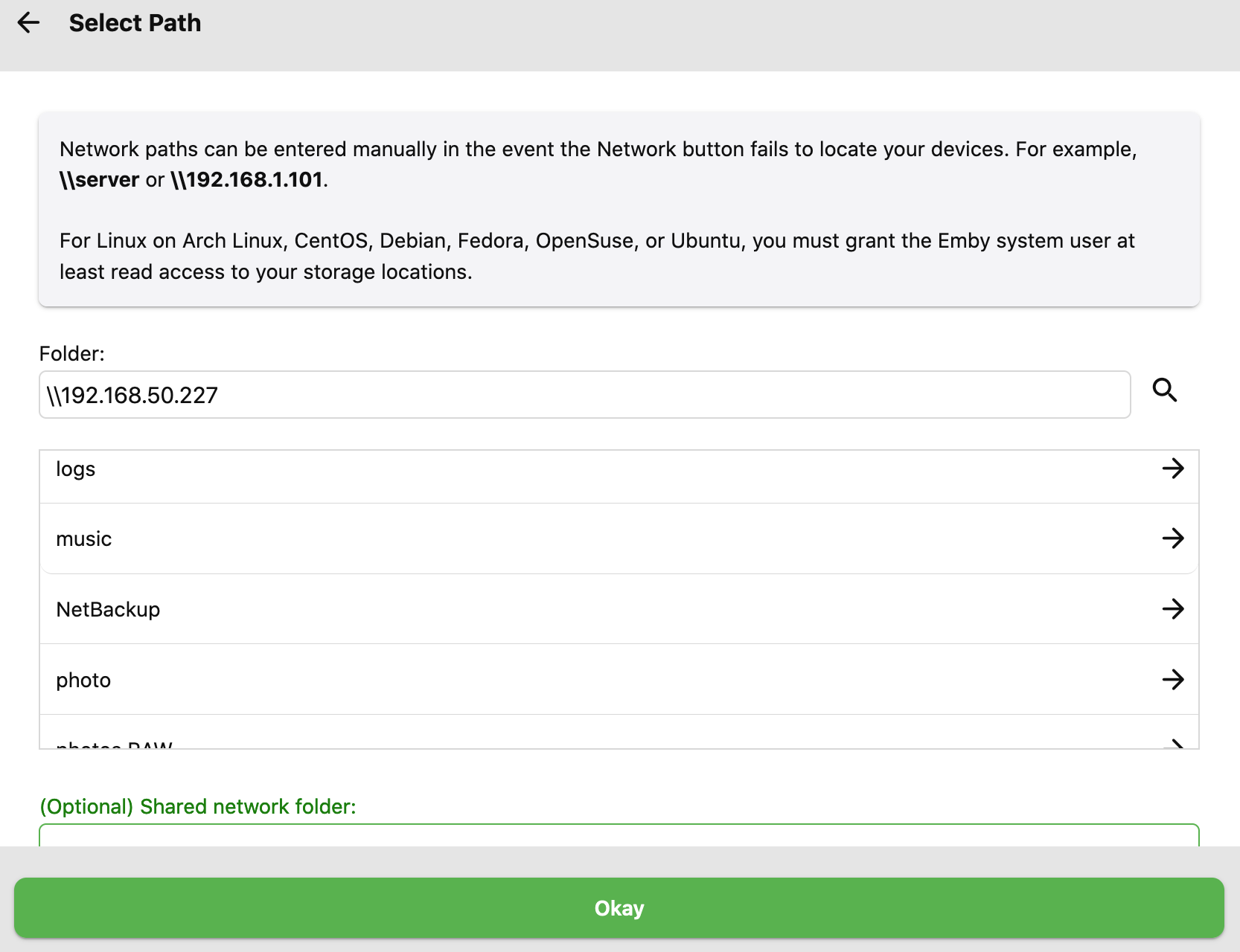

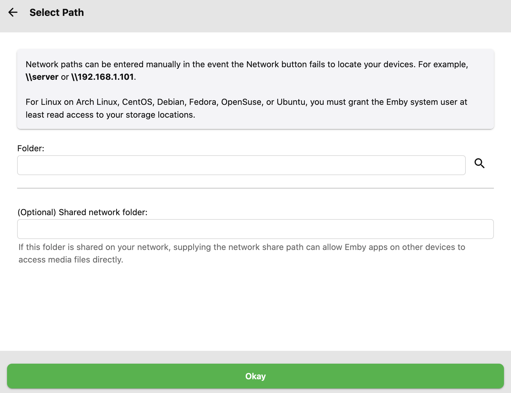

guill69f 17 Posted October 22, 2023 Posted October 22, 2023 Hi, after having created video libraries in Emby, i wanted to add my music folders. however the process of adding the paths where my music files are stored is not the easiest. I have on my nas this type of file structure: /volume1/music/Soundtracks /volume1/music/Artists The navigator only lets me navigate as far as /volume1/music/, then when i click on the music folder the navigator is reset. Same story when i add the network path manually (see screenshots). How can i get this solved, what do i do wrong? Thanks
Solution Luke 42242 Posted October 23, 2023 Solution Posted October 23, 2023 HI, we need to improve the error messages but it sounds like the server is being denied access to the folders. Have you taken a look at this? 1
guill69f 17 Posted October 23, 2023 Author Posted October 23, 2023 (edited) Thanks, this did the trick, i forgot the basics Actually I got a bit mislead because i have a local user called "EMBY__PKG___" (which i don't recall i ever created), and this one has the required permissions. So i didn't even checked for other emby users as system internal users in the dropdown list. Thanks again for helping here Luke. I now have a few questions on the emby app not downloading some files, but that's another story, i'll look for answers on the forum first and i'll come back if i don't find what i am after. Another thing on this topic: what is the Emby__PKG__ user? PKG = package? can i delete it without damaging my emby install? I was thinking to remove all permissions from this user and see if this does any harm. If it doesn't, i'll delete it as a next step. any reason not to do this? thanks Edited October 23, 2023 by guill69f
