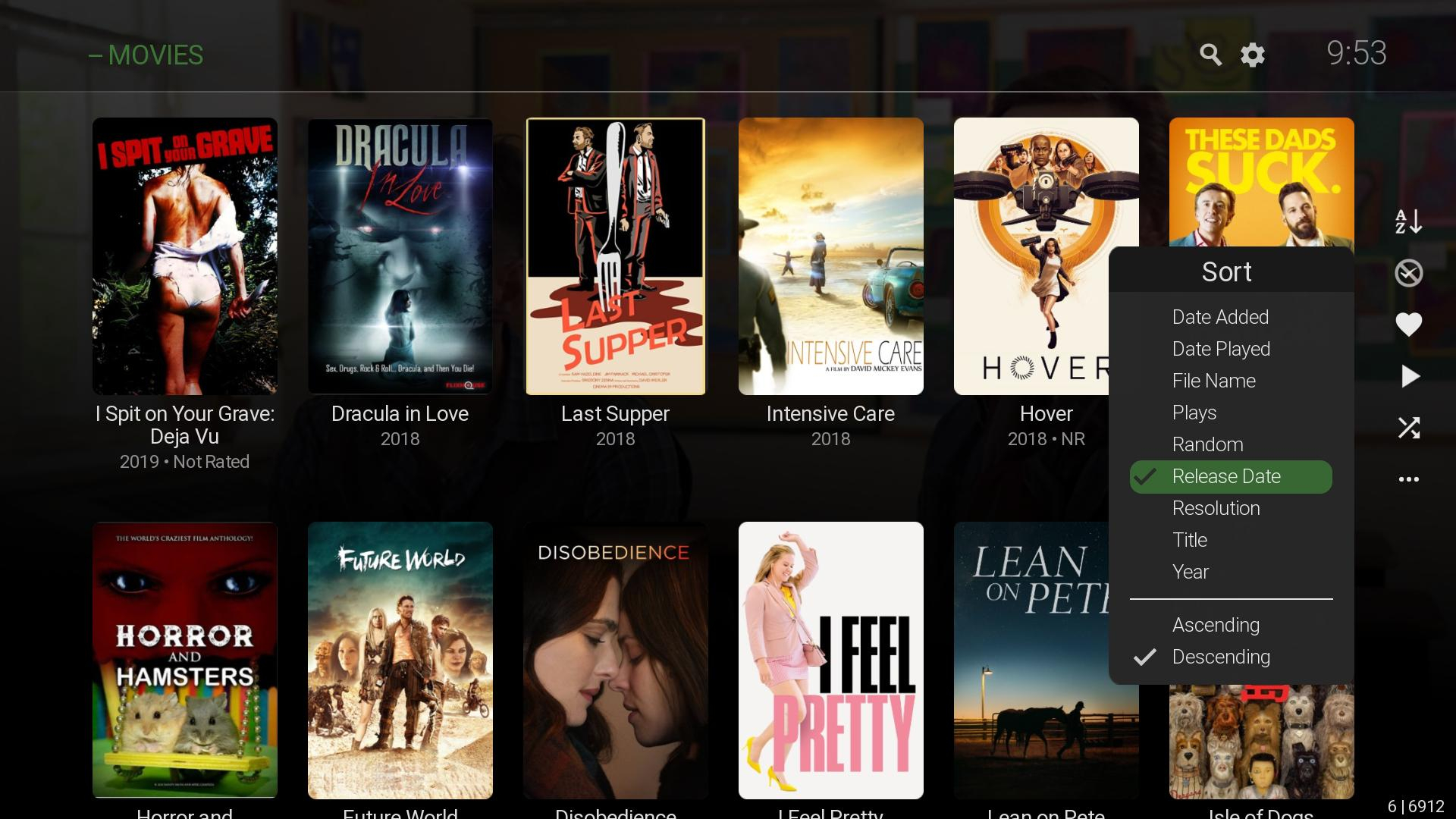

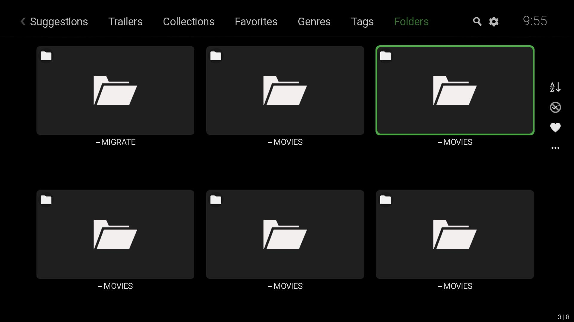

speechles 2062 Posted October 27, 2023 Posted October 27, 2023 (edited) @GrimReaper I just changed the sort to release date at the TOP level of one of the movie libraries. Then I press HOME and exit the Roku app. When I start the app I go right back to that same movie folder. And the sort method is as I have left it. The issue is when you are logged in as a user _AND_ If you change any sort/options on this screen it will affect all the other apps. Perhaps something is changing this value for him like using the web app might. If he was strictly using the Roku app it doesn't forget. The screens above are from the BETA version of the Roku app which is in testing and will be published soon. So perhaps there was a bug in the setting that isn't there now in the BETA? All I do know is that this works as intended on the Roku. If something is messing with the default it is best for the OP to reply. It seems silly for me and you to have a conversation in this thread when neither of us have the issue. Edited October 27, 2023 by speechles

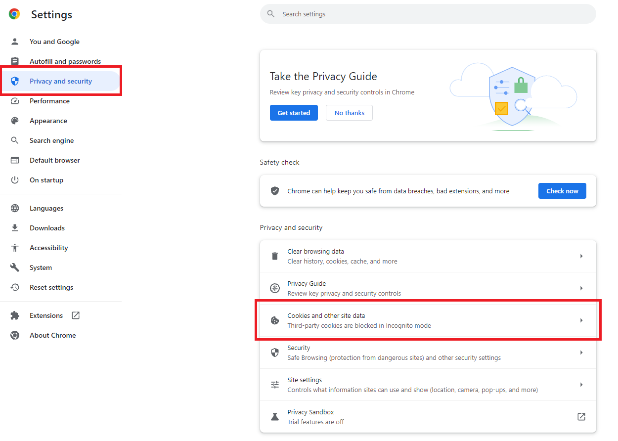

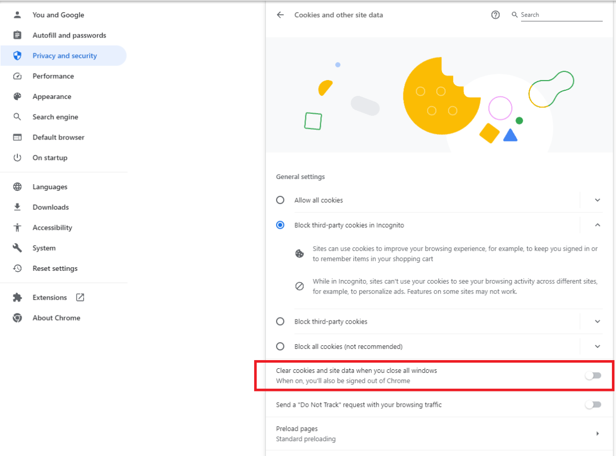

GrimReaper 4926 Posted October 27, 2023 Posted October 27, 2023 1 hour ago, Daniel1966 said: Chrome You would wan't to make sure that this option is unticked under Chrome settings>Privacy and security. Additionally, you might have some browser extension doing it instead, so you can either review each Privacy/Ad-blocking/Tracking blocking extension you have or simply disable them all, restart Chrome and if selection does stick, enable them back one by one until you find the culprit.

Daniel1966 6 Posted October 27, 2023 Author Posted October 27, 2023 Thank you. This seems correct and I will employ this fix right away and repost back if it fixed the problem. 1 1
Daniel1966 6 Posted October 28, 2023 Author Posted October 28, 2023 Seems to be working. Fingers crossed. Now I have to wonder, if somehow the cookie/site data gets deleted by Chrome, I will have to do all the sorting all over. Is there a way to back up the cookie/site data in case this happens?
