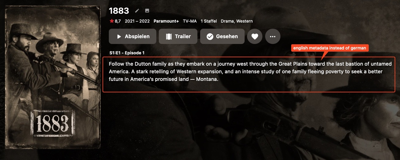

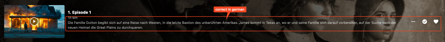

ukkii 1 Posted October 19, 2023 Posted October 19, 2023 (edited) Hi Everyone I just searched the whole forum but wasnt able to find any specific post which is addressing the same issue as I have. Im currently moving to Emby and thus im renaming my whole library (according to emby file naming guide) and start with a bunch of TV Shows. I created the library defined the metadata language, location and cover/picture language to german. Somehow the Metadata of single episodes gets pulled in german, but the tvshow.nfo file keeps getting pulled in english even if the TV Show is available on TheMovieDB in german / german metadata. Things I already tried: - Changing the priority of the scrapper - deactivating scrappers and just leave one activated - deleted the library via gui and recreated it - deleted the library.db file and recreated the librar - MetaData Manager -- Setting the prefered Language on TV Show Level. Any help will be appreciated. Thank you. Edited October 19, 2023 by ukkii

ukkii 1 Posted October 31, 2023 Author Posted October 31, 2023 Hi Luke Seems like i fixed the issue by changing the country to germany in library settings. I had the country set to a country which speaks german as native language but is not germany. 1
