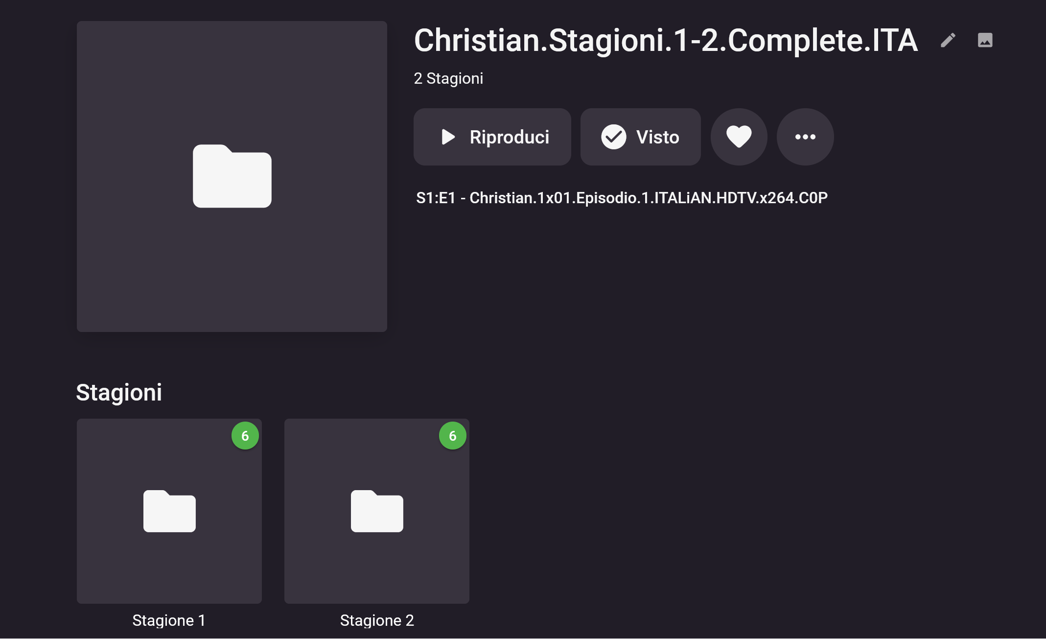

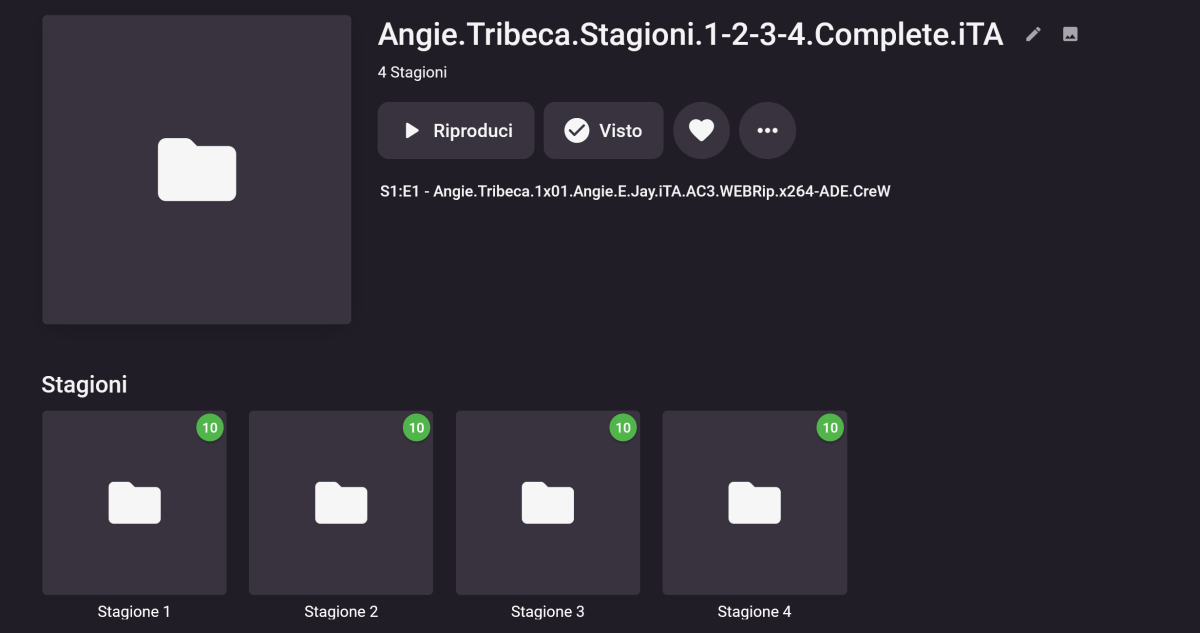

annibal 4 Posted October 18, 2023 Author Posted October 18, 2023 and this is the example of that file that I put up as seen in emby after it finished updating all the metadata it seems he can't find any posters or even information and the title of the TV series remains the initial one

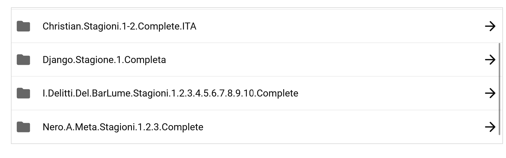

Luke 42245 Posted October 18, 2023 Posted October 18, 2023 3 hours ago, annibal said: here is 1 example And what about underneath those folders?
annibal 4 Posted October 19, 2023 Author Posted October 19, 2023 7 hours ago, Luke said: And what about underneath those folders? which does not load images or even descriptions automatically while when I used plex it renamed all these files and placed the posters automatically
Luke 42245 Posted October 19, 2023 Posted October 19, 2023 1 minute ago, annibal said: which does not load images or even descriptions automatically while when I used plex it renamed all these files and placed the posters automatically Hi, how are files underneath those folders named and organized?

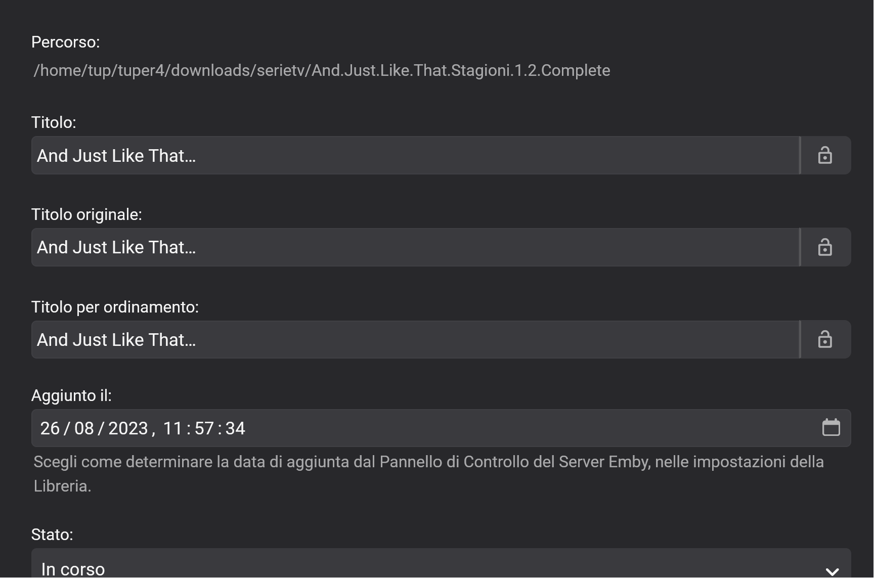

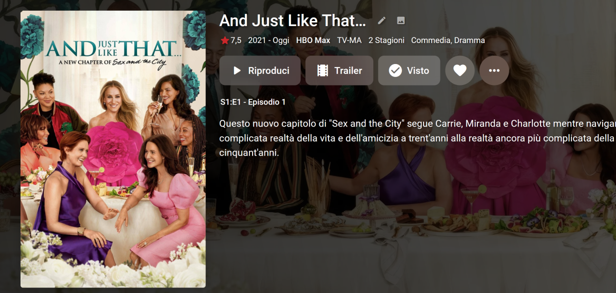

annibal 4 Posted October 19, 2023 Author Posted October 19, 2023 in some folders emby renames them correctly and finds the posters and file descriptions as per the attached image in all the rest of the files it does not process them and keeps the names of the existing files and does not find descriptions and posters
