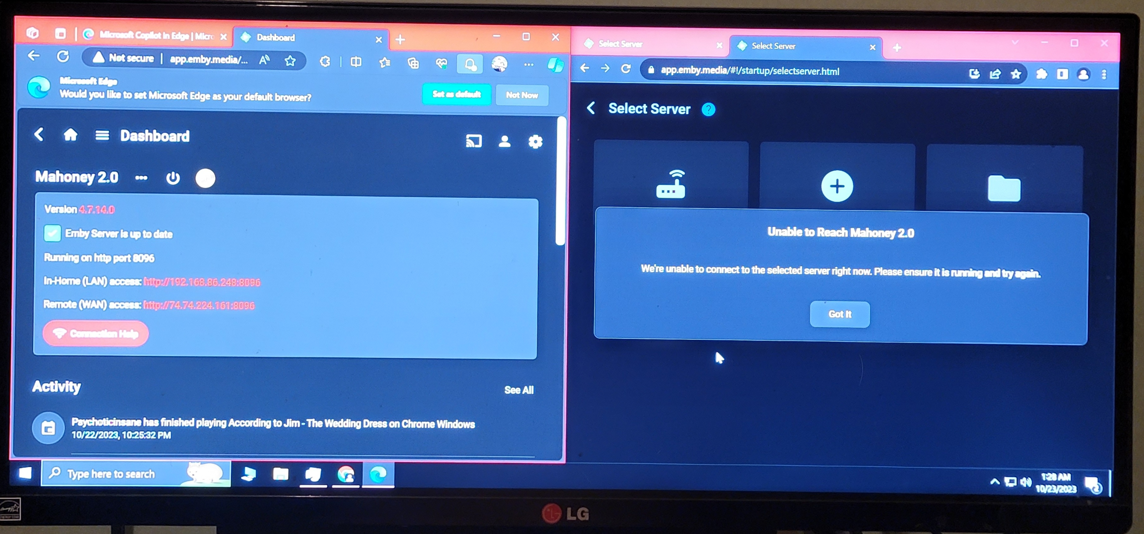

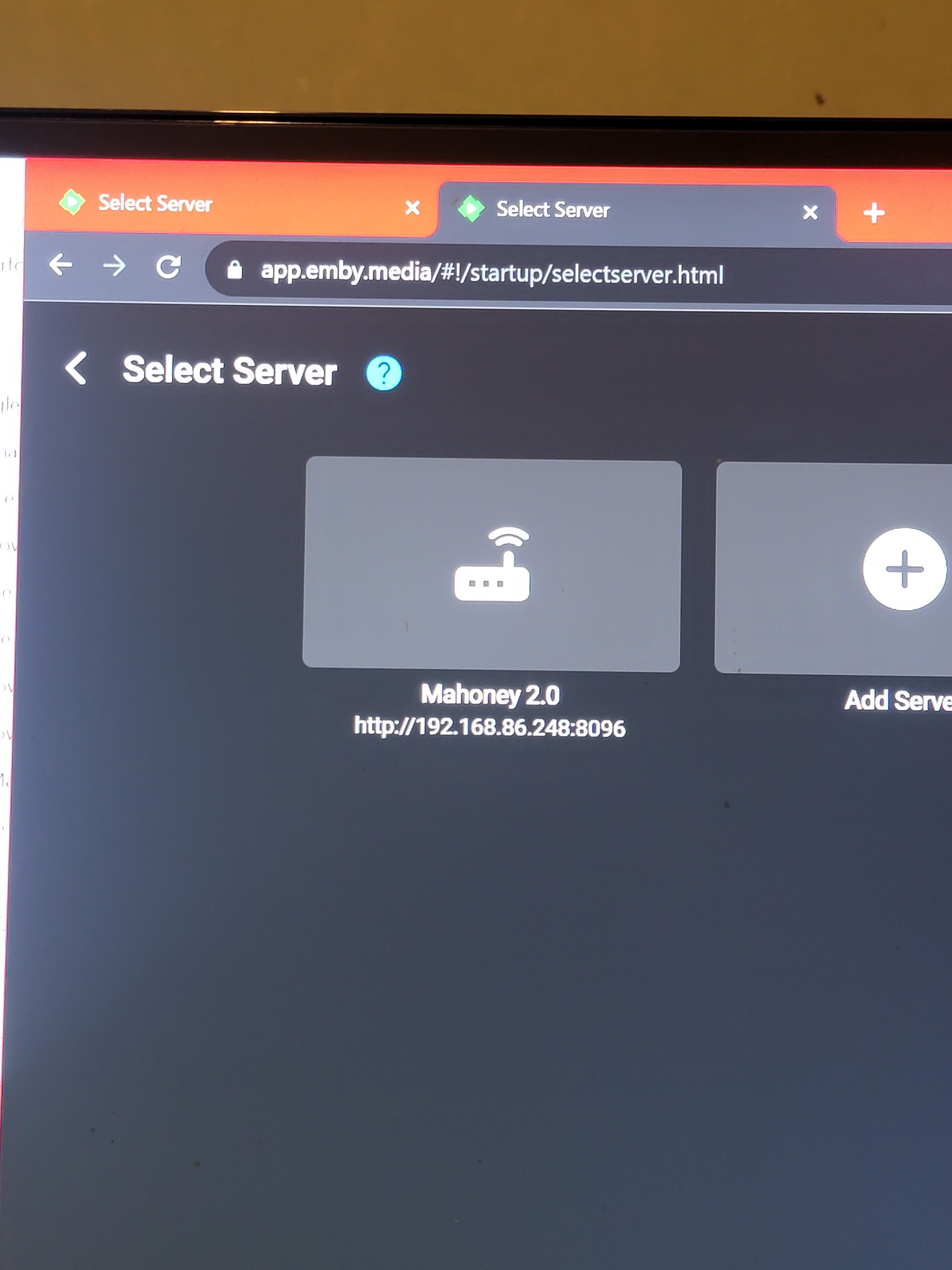

Psychoticinsane 7 Posted October 23, 2023 Author Posted October 23, 2023 10 hours ago, pwhodges said: On the machines on which Chrome doesn't connect, does the address bar show "https" instead of "http" when it fails? Paul I have attached two photos. The first is of the address bar of chrome on one of the affected machines, it also shows the address of the server The second is of a chrome browser(on the right) and a edge browser (on the left) side by side showing the pc itself is able to connect to the server, just chrome will not. A reset of browsing history and a complete uninstall and reinstall, does not help at all.
Psychoticinsane 7 Posted October 23, 2023 Author Posted October 23, 2023 10 hours ago, pwhodges said: On the machines on which Chrome doesn't connect, does the address bar show "https" instead of "http" when it fails? Paul After re reading your comment, i clicked on the address bar which revealed it was https. I deleted the s, and reloaded, and had to sign in again, once signed in i was able to access the server and my user profile. I will check the other machines and see if it shows the same and if this fix works on those as well.

Luke 42289 Posted October 23, 2023 Posted October 23, 2023 22 minutes ago, psycoticinsane said: Why would http and https have such a different affect on emby? It's the rules of the browser. A web app on https is not allowed to communicate with an http-based url. That means you either need setup https for your emby server, or you need to use the http web app. Does that make sense?
pwhodges 2039 Posted October 23, 2023 Posted October 23, 2023 1 hour ago, psycoticinsane said: Why would http and https have such a different affect on emby? Think of the web address as a door and http or https as keys to open the door - using the incorrect key doesn't work. (What follows is a slight rant:) There are circumstances in which Chrome decides to override your selection and change your typed "http" into "https" which then fails - having done this it caches the incorrect decision, and it can be a pain to get it to behave properly again. This is something that Google calls "security"... It doesn't help that browsers hide the protocol they're using (like Windows hides file types by default). Note, my description is not exact, as I don't use Chrome, and haven't seen this happen myself - but I have seen plenty of posts on the Internet helping people who are struggling to get out of this mess. I prefer a browser that does what I tell it to (though they're all becoming less predictable these days). HSTS (Hypertext Strict Transport Security) is sometimes involved - some server security web sites seem to recommend that server admins set a header which forces this change from http to https even when it's not appropriate. Paul
