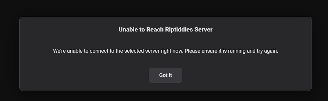

Riptide126 24 Posted October 13, 2023 Posted October 13, 2023 When I try and connect to my emby server using emby connect on google chrome, it tells me that it cant connect to the server but when I try on the exact same device on microsoft edge it works perfectly fine
Riptide126 24 Posted October 13, 2023 Author Posted October 13, 2023 If there is any other information you need please let me know, I just don't know how to approach this problem since it only effects one browser which doesn't make sense to me

Luke 42185 Posted October 14, 2023 Posted October 14, 2023 22 hours ago, Riptide126 said: When I try and connect to my emby server using emby connect on google chrome, it tells me that it cant connect to the server but when I try on the exact same device on microsoft edge it works perfectly fine HI, what address is in the browser address bar?
Riptide126 24 Posted October 17, 2023 Author Posted October 17, 2023 https://app.emby.media/#!/startup/selectserver.html
GrimReaper 4845 Posted October 17, 2023 Posted October 17, 2023 Do you have SSL setup on your server?
Riptide126 24 Posted October 17, 2023 Author Posted October 17, 2023 I don't think so, I am looking at the guide for it right now but I don't even really know what that is I am relatively new to all of this stuff
Solution GrimReaper 4845 Posted October 17, 2023 Solution Posted October 17, 2023 2 minutes ago, Riptide126 said: I don't think so 56 minutes ago, Riptide126 said: https://app.emby.media/#!/startup/selectserver.html Then you should use http://app.emby.media (dump the "s" from "https").
Riptide126 24 Posted October 17, 2023 Author Posted October 17, 2023 Oh yeah that works, is SSL something that I should set up on my server?
Luke 42185 Posted October 17, 2023 Posted October 17, 2023 40 minutes ago, Riptide126 said: Oh yeah that works, is SSL something that I should set up on my server? It's not required but it's generally a good thing to have.
