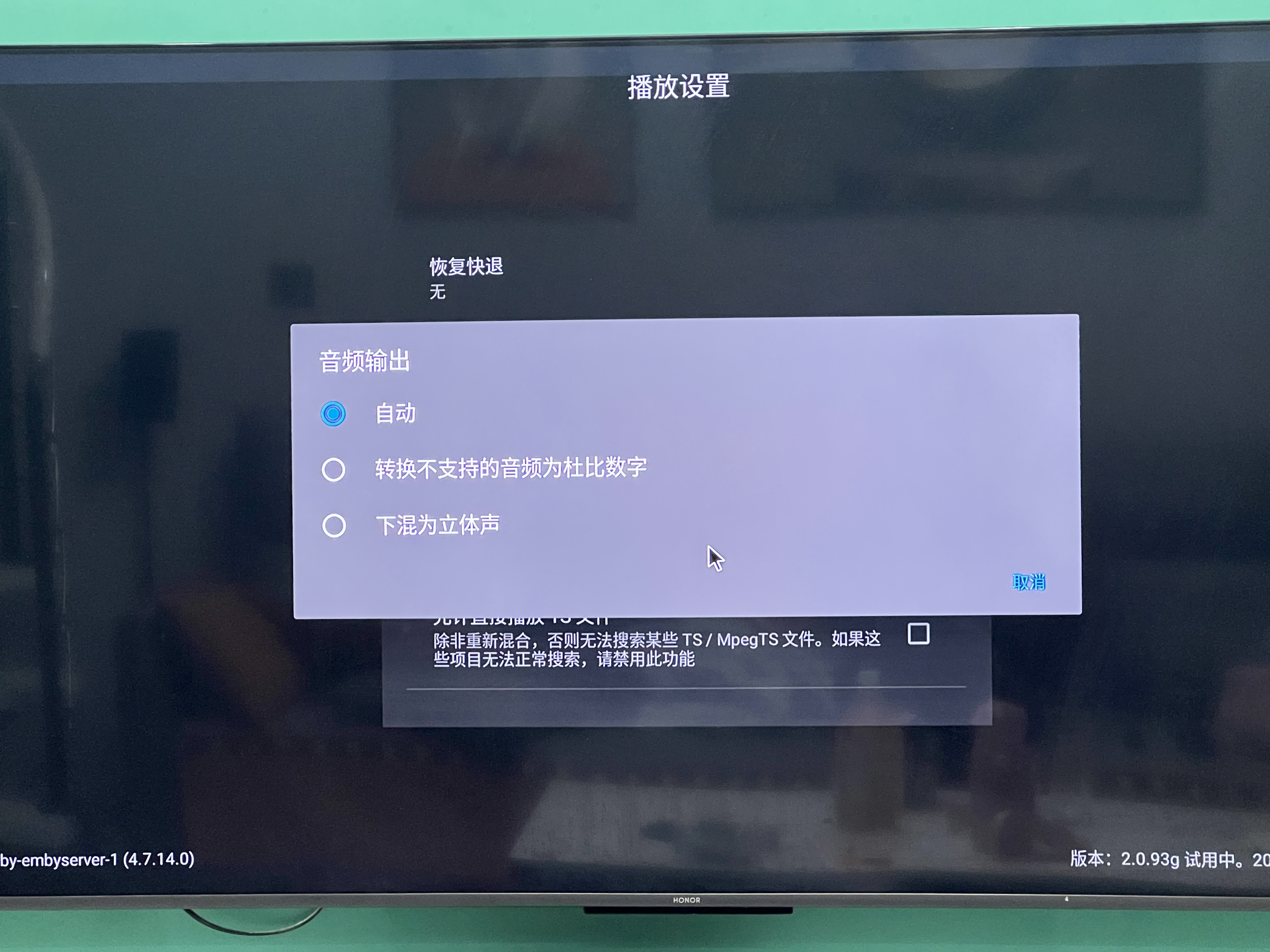

275106590 0 Posted October 9, 2023 Author Posted October 9, 2023 31 minutes ago, Luke said: 你好。您能否尝试在同一设备上 侧载我们的标准 Android 应用程序并看看比较如何? https://emby.media/emby-for-android.html 谢谢。 There are no options for Dolby and DTS in the apk settings. There are only three options on the picture.
275106590 0 Posted October 9, 2023 Author Posted October 9, 2023 Just now, 275106590 said: apk设置中没有杜比和DTS选项。图片上只有三个选项。

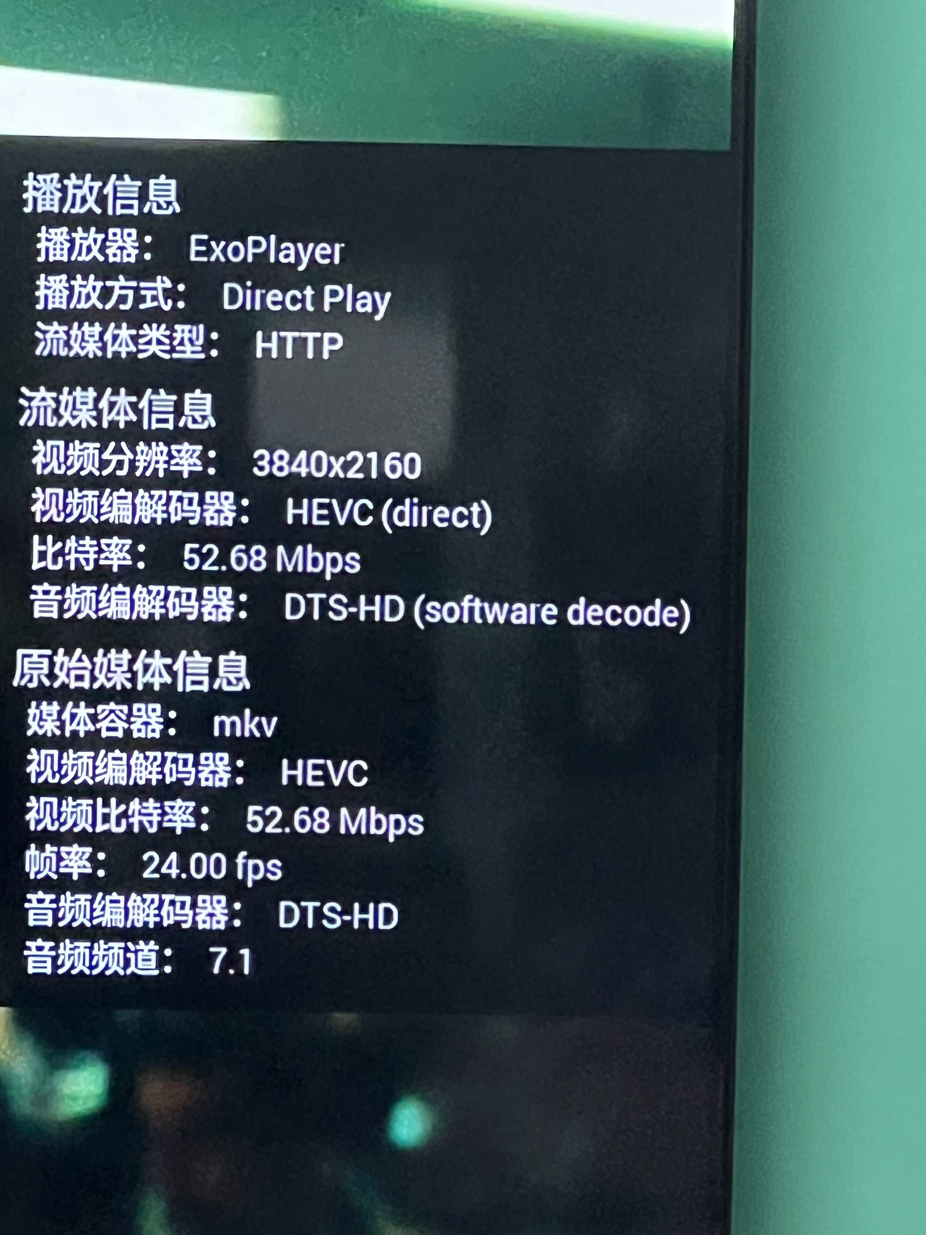

ebr 16336 Posted October 10, 2023 Posted October 10, 2023 6 hours ago, 275106590 said: the Yamaha amplifier displays Dolby Atmos or DTS-X, Hi. The example you showed is DTS-HD. Is that supported by both the box and the receiver?
275106590 0 Posted October 10, 2023 Author Posted October 10, 2023 12 minutes ago, ebr said: 你好。您展示的示例是 DTS-HD。盒子和接收器都支持吗? yes
