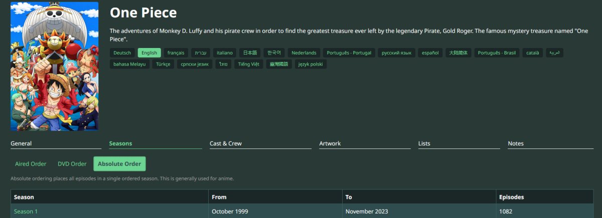

D1sk 4 Posted October 9, 2023 Posted October 9, 2023 (edited) I not unterstand why he crawl staffel 4 when the naming is correkt? What can i do? I will not edit 900 episode manualy. So all was is E3x = Staffel 3 E4x,5x and so one it ingnore komplett S0x ? Has do do it about tvdb ? he not has S01E42? does absolut order not work? Edited October 9, 2023 by D1sk

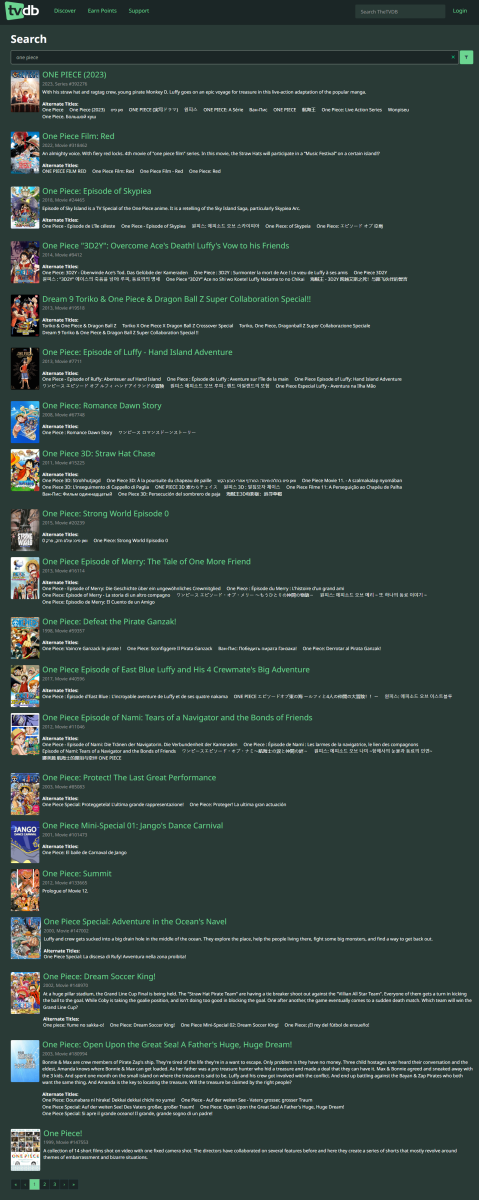

Neminem 1594 Posted October 9, 2023 Posted October 9, 2023 (edited) My guess is its picking up some other show. You should add year and tvdbid to your folder name. Here is my search for one piece Search - TheTVDB.com Edited October 9, 2023 by jaycedk
Neminem 1594 Posted October 9, 2023 Posted October 9, 2023 Here is what I use for folder naming Show Name (year) [TvdbId=xxxxxx]

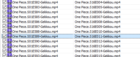

D1sk 4 Posted October 9, 2023 Author Posted October 9, 2023 (edited) Hellothx for support I try this now and make the season order I found an mistake an tvdb has someone an account therer? https://thetvdb.com/series/one-piece/episodes/4552175 Is fauls it must be the number 590 so until to S16E011 is 589 right and after that it make an mistake on tvdb. S01E590 is 12 and not 591 maybe some one can edit that on tvdb? I suspect that therefore much is not right because daruch waruch everything else is probably also postponed. Someone musst fix all episode after 589 until to 1082 Edited October 9, 2023 by D1sk
pwhodges 2023 Posted October 9, 2023 Posted October 9, 2023 (1) Anyone can make an account on TVDB - I have one and use it... (2) The data for One Piece (1999) is locked, so it can't be edited; this happens when people disagree about something and start making edits continually changing the data to everyone's detriment. As One Piece is a popular series, I don't suppose TVDB want nearly half its episodes to be changed around! When there is a discrepancy like this, there is usually a simple reason (e.g. an extra-long episode which was shown in one place as a single unit, but elsewhere as two separate parts). You don't need to use both sets of numbers; all you need to do is decide which numbering you want to use, and if that means changing the names of half your files to match the metadata supplier, just do that using one of the many filename editors (I use Bulk Rename Utility). Paul
GrimReaper 4845 Posted October 9, 2023 Posted October 9, 2023 1 hour ago, D1sk said: Is fauls it must be the number 590 so until to S16E011 is 589 right and after that it make an mistake on tvdb. S01E590 is 12 and not 591 maybe some one can edit that on tvdb? https://forums.thetvdb.com/viewtopic.php?t=32808 1
Solution pwhodges 2023 Posted October 9, 2023 Solution Posted October 9, 2023 3 hours ago, D1sk said: S01E590 is 12 and not 591 The episode is s00e12 - i.e. it's marked as a special. So Emby will insert it where required if the appropriate settings are in the metadata (presumably TVDB will put the insert point in there, but you can do it manually if necessary). Paul 1

croaton 9 Posted October 17, 2023 Posted October 17, 2023 Using Aired Order fixed this, take filebot and tvdb plugin for renaming
