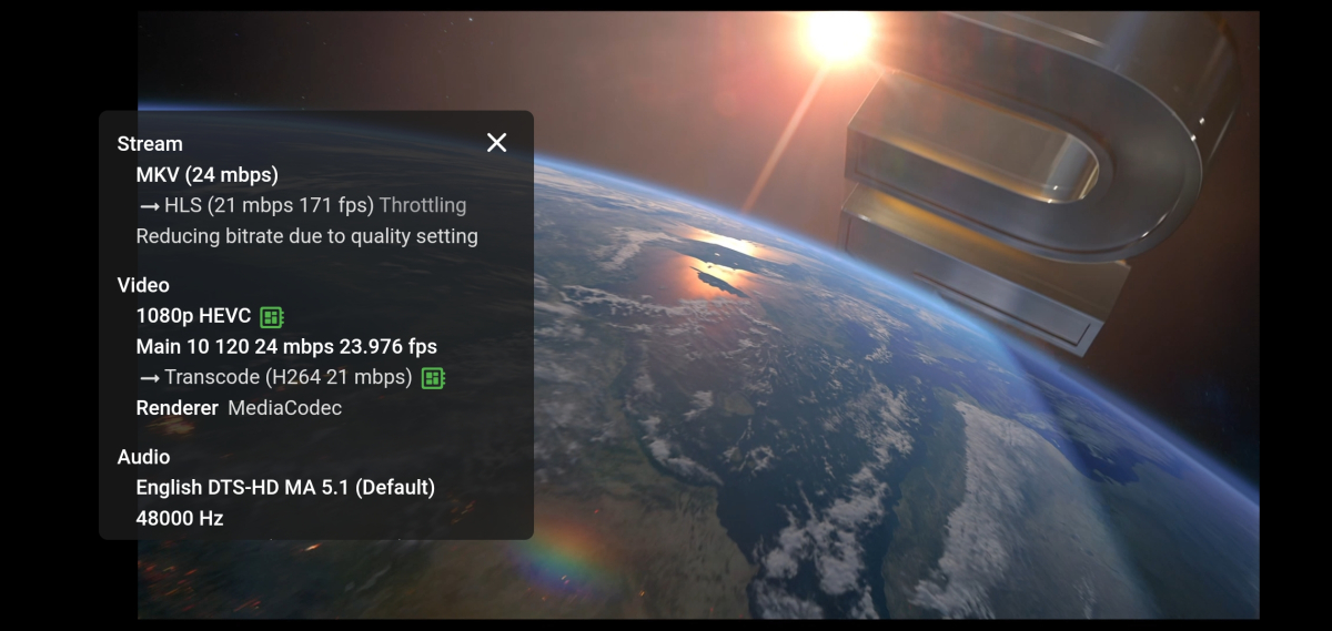

aletomic 2 Posted October 11, 2023 Author Posted October 11, 2023 (edited) 31 minutes ago, Luke said: @aletomic? Hi - Attached a screenshot of a movie in the player. Also, the player configurations. Thanks Edited October 11, 2023 by aletomic
pwhodges 2023 Posted October 11, 2023 Posted October 11, 2023 The Auto settings attempt to measure the network bandwidth, but sometimes get it very wrong. It's worth replacing them with explicit high settings which you believe to be supported by your network. Paul
Ronstang 294 Posted October 11, 2023 Posted October 11, 2023 34 minutes ago, pwhodges said: The Auto settings attempt to measure the network bandwidth, but sometimes get it very wrong. It's worth replacing them with explicit high settings which you believe to be supported by your network. I was thinking along those lines but don't know enough to put in my 2 cents....but my question is if the network is the bottleneck why is it transcoding h,265 to h.264 when from my experience h.265 files are often half the size of h.264 so that would seem to exacerbate the issue with a higher bit rate, or am I missing something here?
pwhodges 2023 Posted October 11, 2023 Posted October 11, 2023 The automatic transcoding is always to h264 because that is the universally acceptable codec - after all, one reason for transcoding is when h265 is not handled by the client! But another reason is bandwidth - and transcoding to h265 in that case would enable the required bandwidth to be met with substantially higher quality. I can picture the possibility that Emby could determine whether the client will be able to handle h265, and transcode to it if possible; but there would still need to be a fall-back to the lowest common denominator of h264 in case of unexpected problems. Trying two different transcodes could then be seen as a undesirable complication. There's also the point that transcoding to h265 takes more system resource, and some servers may no longer be able to keep up. Paul
aletomic 2 Posted October 11, 2023 Author Posted October 11, 2023 57 minutes ago, pwhodges said: The Auto settings attempt to measure the network bandwidth, but sometimes get it very wrong. It's worth replacing them with explicit high settings which you believe to be supported by your network. Paul Then this is the setup that doesn't have problems to play. It is a bummer to have to setup it to this resolution when in 4G and manually. I thought we could find something else that is happening here.
pwhodges 2023 Posted October 11, 2023 Posted October 11, 2023 1 hour ago, aletomic said: I thought we could find something else that is happening here. Provide the server log, then, so that the devs can look at what is limiting the performance. Paul
